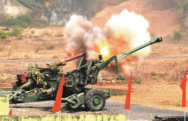

Anyway I was back to lurking on this thread was that I was looking for an article someone had posted about the development of ATAGS, Dhanush and acquisition of M777 and Vajra. Very informative. But could not find it now. Would be great if someone could direct me to the link.
DRDO is testing a new gun with BF. It doesn't look similar to any other guns we know.
https://www.thehitavada.com/Encyc/2020/ ... maria.html
Posts: 14905
Given the length this does not look like a 52 caliber 155mm ATAGS gun, looks like 39 cal- we can sure do with a lot of 155 mm guns.
abhik
Posts: 3090
Joined: 02 Feb 2009 17:42
Post by abhik »
Yup, that's their ultra light howitzer (the one behind the Bofors).
It is not the regular BF ULH. The recoil system is different, as well the back of the barrel.
