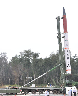

On comparing A2+ and A2 in laymans terms, what is observable is that the former seem to have an elongated RV. A2+ has been known to have a more precise and better manuverable RV specifically designed to avoid BMD. Maybe Gurus can explain better the observable difference between A2 and A2+
Also kindly pardon my ignorance but why do we not see the stage seperation jettisioning part (I dont know the name :roll: ) in A2+. It just looks like a single stage Rocket + RV.
Agni-2 Prime
Agni-2

"On camparing A2 and A2+ in laymans terms, what is observable .."
What would be the difference between Agni 2AT( last tested in Aug/2004) and Agni 2 prime? And what is the state of the former, tech demonstrator for the time being?

Yeah the 'vented inter-stage' is gone along with the tail fins (explains the news about flex nozzle being used in 1st stage) , this is a good development helps in canisterising as well as adaptation for submarine use. :D

second stage looks like made out of composites. Also the RV design is now in sync with A3.
Posts: 60381
Re: Indian Missiles and Munitions Discussion
Narad, The vented interstage is needed to ensure there are pressure relief openings for the separation system. Elimination means they are using a different stage separation system which does not build up that much pressure. Maybe shaped charge for cutting the metal forward of the F/S dome. Also could be faster S/S motor which will obviate the need for venting. Flare in the s/s motor is an adapter and pseudo-interstage. So there is dia change between the f/s and s/s. If they kept the s/s dia same it will give even more range. Must have been a trade-off.
The F/S lack of fins means the old SLV F/S stage is not being used anymore. And control is via thrust vectoring with flex nozzle.
The more interesting is the payload. It doesn't have those canards. And yet is stated to be more manouvering and accurate. So most likely its based on jets. Same as the AIII. All those patches are antennas for the test body. Also its higher beta with the clean lines. Low beta means could slow down and become vulnerable.
I would like to know the total thow weight if its different than the AIII which was 1.5 tonne.

This is a 100% brand new missile- the A2 name is clearly only to convey that it is an upgrade. Smart.
The TEL looks new as well. One can imagine a canister in future.

dinesha wrote:High resolution pics of A2P-01
http://4.bp.blogspot.com/_5sP7XwykNSM/T ... +Karan.jpg
A2P looks neat, but it is no way an Agni-2, SDRE Indians have a new missile and they have named it Agni-2AT in a sneaky manner. The missile is a new one and the launcher is also a new one. The fins of both stages are missing. The separation logic has changed and the warhead is different and second stage is completely different. The range is different.
gurus,
How come none of the other missiles like Minutemen, SS-19 or SS-18 don't use the vented interstage used by normal A-2. What are advantages or disadvantages of such a system. i have seen vented interstage in some old soviet ICBM's like SS-13 and SS-11.
Why are we moving away from vented interstage?
Posts: 60381
Venting is needed for the separation charge. most likely they have mastered the small separation charges and dont need the venting.
I can see Tessymol in the pic 8)
