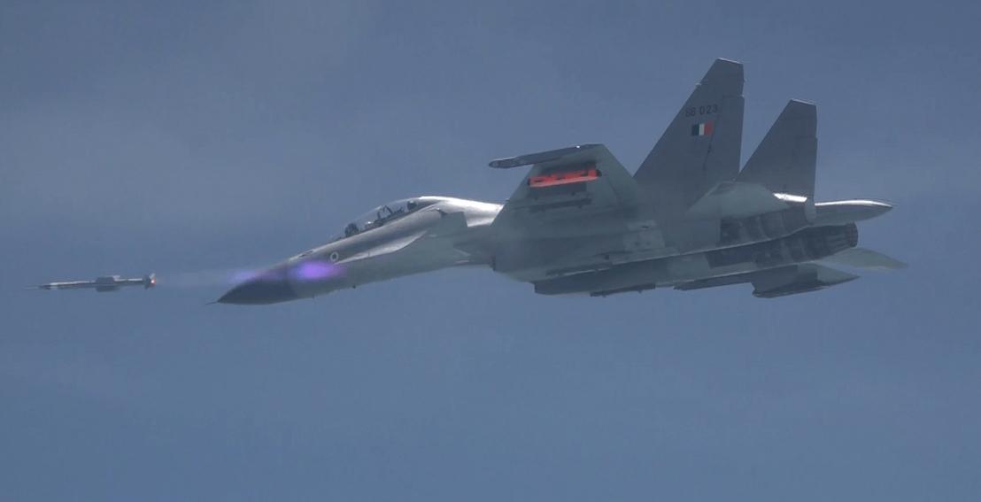

Air-to-Air missile Astra successfully flight tested from Su-30 MKI
Air-to-Air missile Astra has been successfully flight tested off the coast of Odisha. The missile was launched today from Su-30 MKI as a part of User trials. The live aerial target was engaged accurately demonstrating the capability of first indigenous air-to-air missile.
The mission profile was executed in a text book manner. Various Radars, Electro-Optical Tracking System (EOTS) and Sensors tracked the missile and confirmed its engagement with target.
Raksha Mantri Shri Rajnath Singh congratulated DRDO and Air Force teams for the successful test.

IAF Sukhoi Su-30MKI successfully test-fires Astra BVR Air-to-Air missile developed by DRDO
https://zeenews.india.com/india/iaf-suk ... 34965.html
Share:
Reported By: Zee Media Bureau
Edited By: Ipsita Sarkar
Updated: Sep 17, 2019, 15:39 PM IST
An Indian Air Force (IAF) Sukhoi Su-30MKI fighter Tuesday successfully test-fired the indigenous Beyond Visual Range Air-to-Air Astra missile with a range of over 70 kilometers. The Astra missile, which can fly towards its target at a speed of over 5,555 kilometres per housr (4.5 Mach) with a 15 kilogramme high-explosive pre-fragmented warhead, was test-fired under the guidance of Defence Research and Development Organisation (DRDO) from the Su-30MKI combat aircraft that took off from an airbase in West Bengal.
The indigenously-developed Beyond Visual Range Air-to-Air Missile (BVRAAM) Astra missile has been developed by DRDO and integrated on Su-30MKI and other air platforms, a previous statement from the research organisation said. Modfications of the Su-30MKI jets to accommodate Astra missiles has been carried out by Hindustan Aeronautics Limited (HAL). More than 50 private and public sector industries have been involved in the development and production of Astra missile.
In October 2018, the IAF had successfully test-fired the solid propellant Astra missile several times over a period of a week to judge its capability in the engagement of pilotless target in different modes of manoeuvring, off-boresight, medium and long ranges. The Astra missiles are equipped with mid-course inertial guidance and terminal active radar homing. They are capable of targeting the enemy aircraft or missiles at short-range (20 km) as well as at BVR (over 70 km).
IAF is also in the process of integrated the Astra with its Dassault Mirage 2000, Mikoyan-Gurevic MiG-29 fighters as well as the indigenous Light Combat Aircraft Tejas. The 154 kilogramme Astra is 3.57 metres long with a diametre of 178 milimetres. Its warhead is detonated by a radar proximity fuse. The maximum altitude from which the missile can be fired is 20 km. According to DRDO, Astra's maximum range is 110 km and there are plans to develop a 300-km range version too.

If its not classified, can we know the launcher aircraft with Serial No SB 023- which squadron is it and is it one of 50 built in Russia?

Aditya_V wrote:If its not classified, can we know the launcher aircraft with Serial No SB 023- which squadron is it and is it one of 50 built in Russia?
10sec away with Google. :) From Sq 20. And yes likely from the first batch.
http://www.bharat-rakshak.com/IAF/Galle ... 5.jpg.html

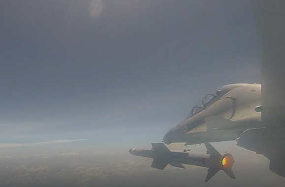

What a beautiful smokeless flame. Cannot spot the missile being fired at all. Will give no hint to an enemy that a missile has been fired and is on its way.

I kind of remember vaguely to have read that Astra uses the same pylon as R-77 and hence (together with other factors) its easier to integrate with any jet which already can handle R-77. Can someone confirm is this is correct or wrong..? I am not able to find any reference from google.

JayS wrote:I kind of remember vaguely to have read that Astra uses the same pylon as R-77 and hence (together with other factors) its easier to integrate with any jet which already can handle R-77. Can someone confirm is this is correct or wrong..? I am not able to find any reference from google.
The Astra is fired from the Russian Vympel launcher -- a rail under a fighter aircraft's wing from which the missile hangs.
The Vympel launcher is integrated with all four of India's current generation fighters -- the Su-30MKI, MiG-29, Mirage 2000 and the Tejas -- allowing the Astra to be fired from all of them.
https://www.business-standard.com/artic ... 026_1.html
The air launcher, a rail on which the missile hangs and from which it is launched, is a Russian Vympel launcher that is being built in India. It will allow the Astra to be fired from all four of India's current generation fighters - the Su-30MKI, MiG-29, Mirage 2000 and the Tejas Light Combat Aircraft.
This is the APU-73 launcher used for R-73E

DRDO Sources: Third firing of Astra Beyond Visual Range Air to Air Missile was successfully carried out by Air Force and Defence Research and Development Organisation today. The missile hit the live aerial target near Odisha at maximum range of approximately 90 km.
https://t.co/1f0e9hMP8A
