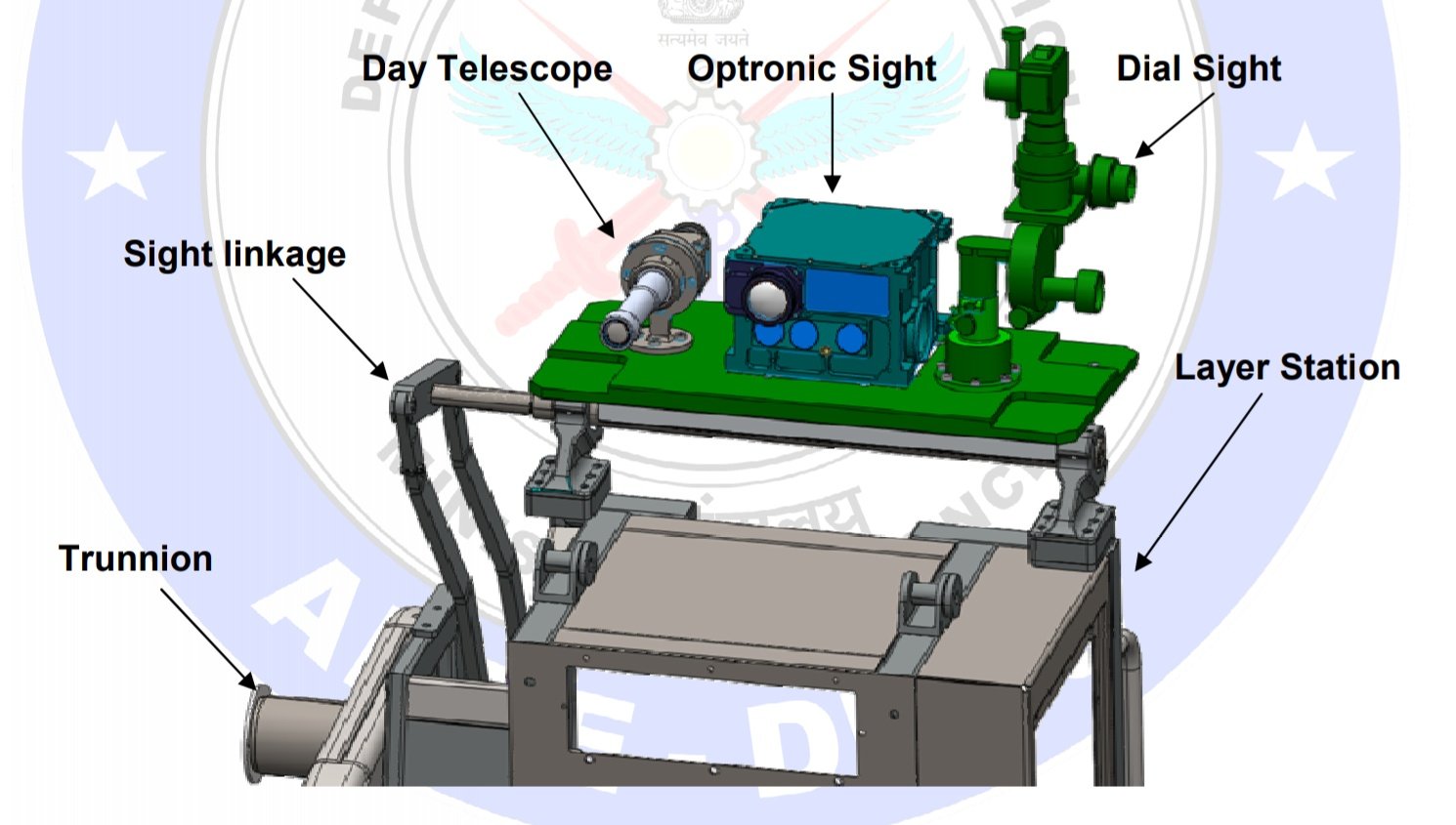

https://twitter.com/Varun55484761/statu ... 71584?s=20 ---> Backup Sighting System for ATAGS. It is used for indirect fire as a backup sight. These are back-up sights which are entirely optomechanical in design. This is required for redundancy in case of power failure/INS or any situations where gun is required to function in manual mode.
