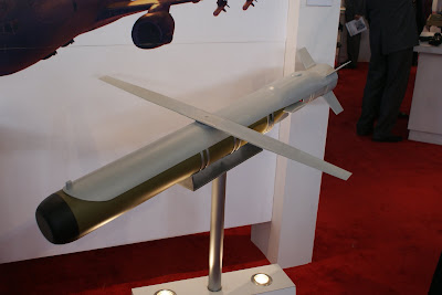

Gagan wrote:This seens to be the GPS / GLONASS later IRNSS guided bomb kit
From Livefist:
That looks like an air launched Torpedo. The Aircraft in the background might be the Boeing P8I.

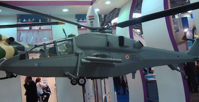

X-post...to see if anyone has an answer to this Q..
Craig Alpert wrote:Image Image
HAL officials today said that over 15 more ground runswould be carried out for the Light Combat Helicopter (LCH), before it takes off for its first flight, which is likely towards the end of February or first week of March. So far all ground runs have been successful.
Just curious...what anti-radiation missiles are carried by our helos? Do MI-25/35s carry them and will the same ones be used by LCH?
Also, I imagine air-to-surface missiles implies anti-tank missiles. Right?

Rohit - AFAIK, no helicopter anywhere carries any anti radiation missile. They fly too low and too slow for effective SEAD, though US did use Apaches for this role in Iraq using laser guided hellfires and unguided FFAR.

tsarkar wrote:Rohit - AFAIK, no helicopter anywhere carries any anti radiation missile. They fly too low and too slow for effective SEAD, though US did use Apaches for this role in Iraq using laser guided hellfires and unguided FFAR.
Thanks for this tsarkar- this is exactly what I thought. But if you notice the info board next to the LCH model display, it mentions anti-radiation missiles. Hence, was curious! Is this just a show/marketing gimmick or is there an anti-radiation version of Nag, etc being developed?
