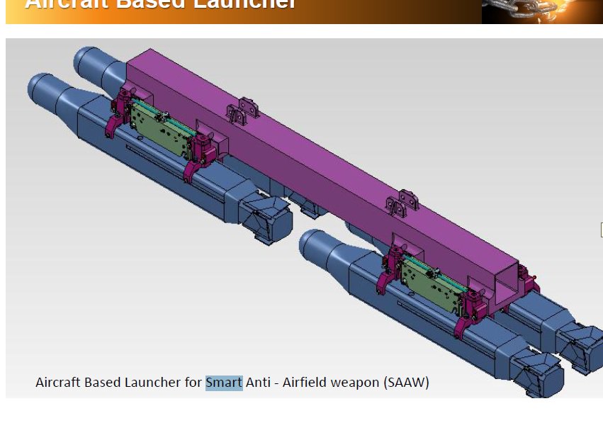

Via SauravJha and SParija twitter
DRDO SAAW
DRDO SAAW
Oh! So, it is exactly as we had discussed it to be. Good going.

Karan M wrote:Via SauravJha and SParija twitter
DRDO SAAW
Cool, looks all TFTA unkil like
It will look even more TFTA once the enclosure / fairing is added to shield the equipment in green and purple.
Glad to have the confirmation. Seems to have seeker, a large body for submunitions perhaps, and no separate propulsion?indranilroy wrote:Oh! So, it is exactly as we had discussed it to be. Good going.

The slit on the body of the SAAW seems to indicate it will have wings like nirbhay.
you are right. the reports do note glide capability. 80-110km range capability would make these ideal systems to take on a range of targets. if they can take on moving targets, even better.

Remember our discussion a few pages back.Karan M wrote:Glad to have the confirmation. Seems to have seeker, a large body for submunitions perhaps, and no separate propulsion?indranilroy wrote:Oh! So, it is exactly as we had discussed it to be. Good going.
I agree with the other posters that as an anti-airfield weapon, it is probably INS/GPS guided. One can imagine LCA, Mirage, Jags, Sukhois carrying them.
indranilroy wrote:We know that RCI has already tested a 1000 kg glide bomb. It has now issued a tender for airframe assembly of yet another glide bomb. This one is interesting. The airframe has a square cross section (20cm X 20cm), and a length of 1.86 mtrs. Therefore, this glide bomb is unlikely to weigh over 150 kgs. The folded wings have a total wingspan of about 1.4mtrs.
They are getting about 10 of these airframes made within 5 months of issue of materials from RCI. So expect test flights in about an years time.
But the above tender shows that RCI is already working on a variant which is IIR/MMW guided, similar to the Spice 250. Such a weapon is ideal for armed Hawks, IJTs, HTT-40s, and Rustoms to carry. Their hardpoints can't handle much higher loads. Imagine armed HTT-40 patrolling the Maoist infested areas or the coast guard using them to patrol the coasts against suspicious boats. One airplane: 6 hours per sortie capable of taking on any threat presented by the job. Can there be a more cost effective solution?indranilroy wrote:The nose looks like this.
Right now, it will be made of an aluminium alloy called HF-15. I am pretty sure that later on it will changed to radome/optically-transparent material.
^^ this is brilliant. you called the 4 per pylon rack as well.

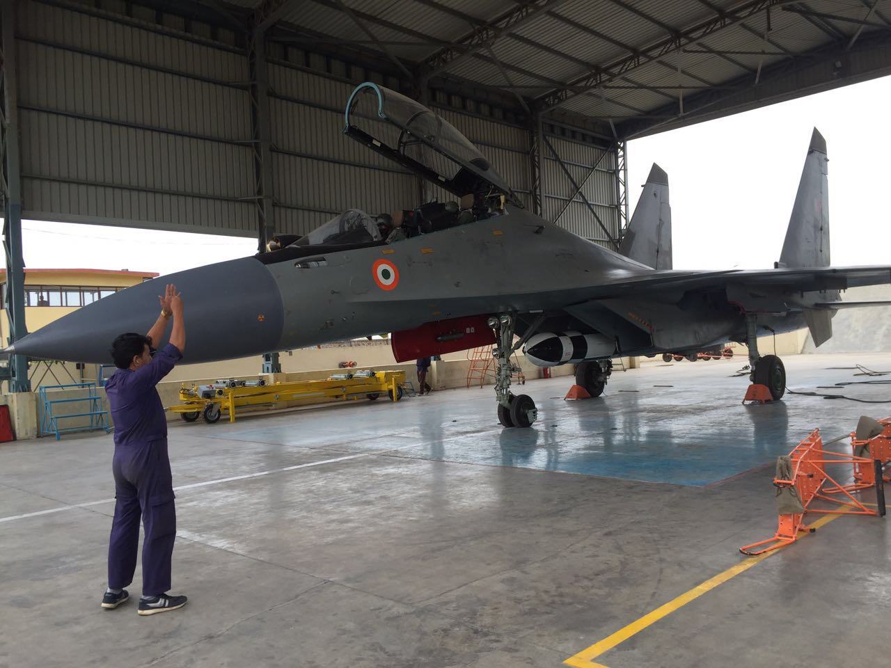

Manu Pubby @manupubby_ET · 10m10 minutes ago
First demonstration flight with air launched version of Brahmos on Su 30 MKI successful today. Kudos.

Manu Pubby @manupubby_ET · 8m8 minutes ago
"Su-30-BRAHMOS combination will carry out air combat operations within and beyond visibility range" - Brahmos.
