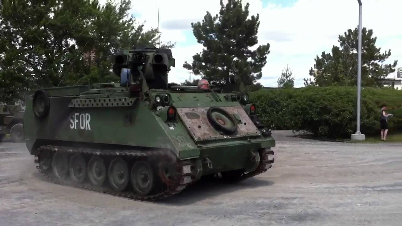

rohitvats wrote:Also, more than the threat perception, I think it is the engagement distance which would dictate the requirement. The ability to fully exploit a tank gun or a missile beyond or even close to 2 km is considered difficult in our context. Both in Punjab and deserts. In fact, I was reading US Army document which spoke about inability to exploit the 3.75 km distance of TOW Missile - the reason being that it requires tremendous training to be able to hold the target for such a long flight time. Plus, in case of SACLOS Missiles, more the flight time, more the chances of discovery of firing unit by enemy. There is another practical reason - the wire which guides the missiles should not get tangled; I've heard stories of villagers using the stone-at-the-end-of-long rope to bring down ATGM in firing ranges by snapping the guidance wire. Net - a long range SACLOS ATGM might not be able to do full justice to its capabilities. A true F&F Missile like Nag is more suited for such roles.
Correct. The Pakistanis have something called TUA (TOW under Armour), but that has the same challenges listed by you
http://i1.ytimg.com/vi/nrJTvCwFWJ4/maxresdefault.jpg
Did anyone notice that every missile being evaluated by IA - Nag, Spike & Javelin is F&F. Because, in a fast moving battlefield with even heavier vehicles becoming more agile, the ability of an operator to designate over longer durations of time is becoming extremely limited. Also note that IA is desperate for ToT for IIR, and conversely US & Israel reluctant to give it, that is holding back these deals.
