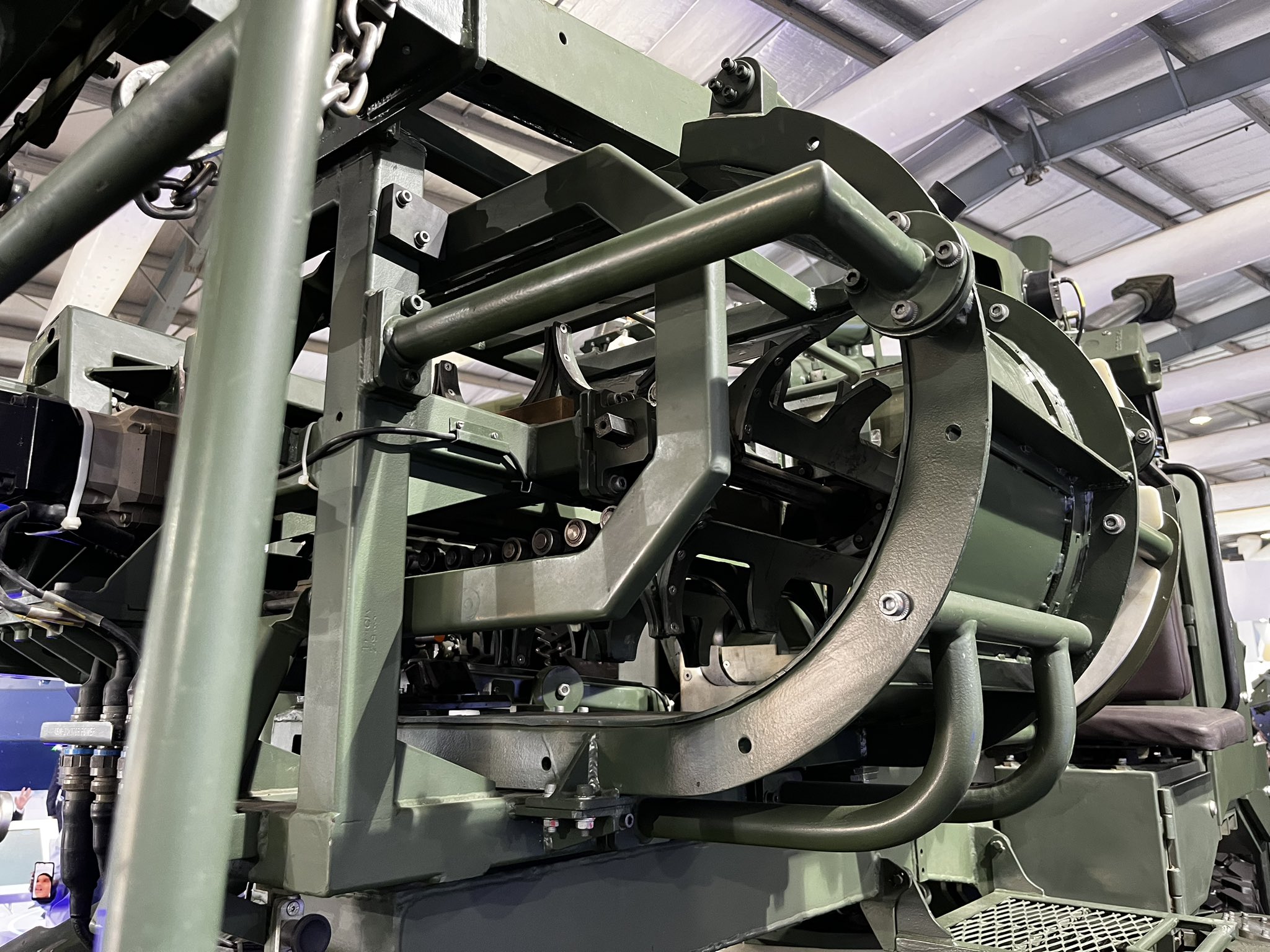

https://twitter.com/raflanker/status/15 ... PDP5Sg2iYw ---> Two types of ammunition table are seen on ATAGS.
Top: Kalyani variant with linear ammunition table (6 shell)
Bottom: TATA variant with revolver ammunition table (5 shell)
Looking at the pictures. I would call both the systems conveyor belts. The kalyani one is skinny. The Tata one is chonky.
But both of those systems can be further developed by the respective companies into components for high capacity autoloader for different systems.
