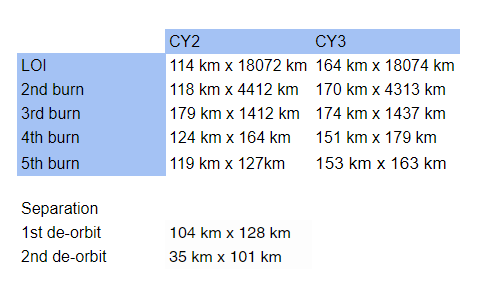

Coming back to CY3!
Journey so far: For BRF quick reference:
Earth Bound:
1 15 July 2023 — 41,762 km 173 km Success
2 17 July 2023 — 41,603 km 226 km Success
3 18 July 2023 — 51,400 km 228 km Success
4 20 July 2023 — 71,351 km 233 km Success
5 25 July 2023 — 127,603 km 236 km Success
Trans Lunar Injection:
31 July 2023 — 369,328 km 288 km Success
Lunar Bound
1 5 August 2023 -- 18,074 km 164 km Success (Orbit Time Approx. 21 h )
2 6 August 2023 — 4,313 km 170 km Success (Orbit Time Approx. 6.25 h)
3 9 August 2023 — 1,437 km 174 km Success (Orbit Time Approx 2.3 h )
4- 14 August 2023 - 151 km 179 km Success (Orbit Time Approx 2.07 h)
5 16 August 2023 -
?? August 2023 Lander Module Separation
?? August 2023 Lander Deorbit Burn I
?? August 2023 Lander Deorbit Burn II
23(?) August 2023 Vikram Landing.

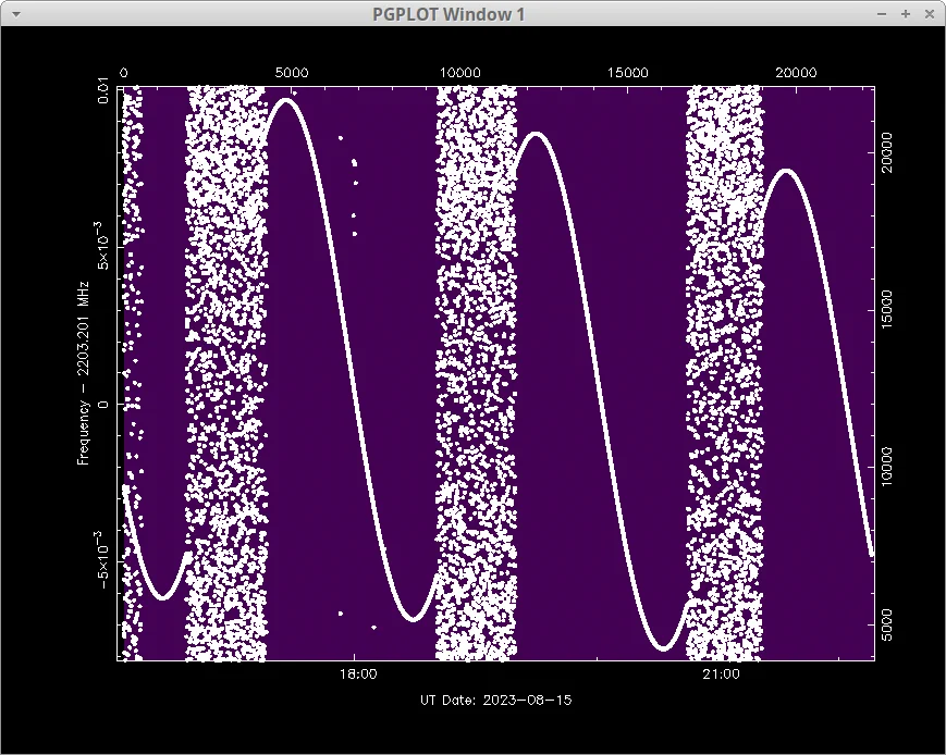

Anyone know if the Doppler signal received from CY3 is generated by CY3 or is it generated from earth-bound radars and bounced off CY3?
Posts: 11994
Re: Chandrayaan 3: Launch and Discussions
SriKumar wrote: 14 Aug 2023 05:24 Anyone know if the Doppler signal received from CY3 is generated by CY3 or is it generated from earth-bound radars and bounced off CY3?
They are generated by CY3.. and can be easily (relatively speaking if you are in the line of sight and have a good receiver/access to radio telescope). ISRO, I believe should get A+ in keeping all the relevant information in public.
CY3 transmits its fixed frequency Telemetry channel.
The doppler is generated due to varying distances between Earth ( Receive antenna ) and CH3 Transmitter.
Under regular circumstances doppler does change but slowly.
Whenever sudden changes in speed ( like Apogee changing mechanical impulse ), occur , sudden doppler changes are seen and measuring that, one ( like AbmerG tutorial ) can calculate the change in attitude.
Added later: No, it ( amateur measurements mentioned earlier ) is not radar measurement. )
For that there is a separate fixed frequency beacon used exclusively by satellite operator in conjunction with Ranging equipment using Tx/Rx for accurate measurements )
Don't know how much interest is here, but FWIW, sharing it for BRF for those who may be interested:
Amateur Radio Astronomer's Guide to Tracking Chandrayaan 3 (or any such object Using Doppler Shift of Radio Signals
- Amateur radio astronomers have a unique opportunity to contribute to the study of spacecraft orbits, particularly those of Chandrayaan, by utilizing the Doppler shift technique on radio signals. This method involves monitoring the frequency shifts of the spacecraft's transmitted radio signals, allowing you to deduce its velocity and orbit. While your measurements may not match the precision of professional agencies like ISRO , they can still offer valuable insights and contribute to the broader scientific community. Besides it is fun.
Exploring Radio Doppler Shift:
The Doppler shift, in the context of radio signals, is a change in the frequency of the signal caused by the relative motion between the spacecraft and the observer (you). As Chandrayaan approaches or recedes from Earth (as it does when it orbits the moon), the transmitted radio signals experience a shift in frequency.
Required Equipment and Preparation:
To embark on the journey of tracking Chandrayaan's orbit through radio Doppler shift, you'll need:
Radio Telescope: Access to a radio telescope or radio receiver capable of detecting the frequency of the CY3's
(Many institutes in India (and US) like IITs', TIFR, have access to theses too)
Antenna System: A high-quality directional antenna system that can accurately pick up the spacecraft's signals.
Radio Spectrometer (optional): A device that can help analyze the spectral characteristics of the received signals, aiding in precise frequency measurement.
Software Tools: Utilize specialized tracking software or applications that predict Chandrayaan's passes and assist in Doppler shift calculations.
Steps to Observe and Measure:
Follow these steps to track Chandrayaan's orbit using radio Doppler shift:
Pass Prediction: Utilize tracking software or applications to determine when Chandrayaan will be visible from your location.
Antenna Alignment: Properly align your antenna system to the predicted position of Chandrayaan's pass.
Baseline Calibration: Before the spacecraft's pass, calibrate your equipment using known radio sources to establish a baseline frequency.
Signal Monitoring: During the spacecraft's pass, monitor and record the frequency of its transmitted radio signals.
Doppler Shift Calculation: Calculate the Doppler shift by comparing the observed frequency with the baseline frequency. This calculation reveals the spacecraft's velocity and motion.
Contributing to Scientific Knowledge:
While your measurements may exhibit some variability compared to ISRO data, your efforts provide valuable insights into the spacecraft's orbit. Discrepancies or deviations in your data, when compared to more accurate sources, could point to interesting phenomena that warrant further investigation.
Collaboration and Data Sharing:
To enhance the accuracy of your observations, consider collaborating with fellow radio astronomers or participating in collaborative projects. Sharing your data with professional researchers and space agencies can also contribute to a broader dataset for in-depth analysis.
Amateur radio astronomers possess the ability to actively engage in tracking the orbits of spacecraft like Chandrayaan through the analysis of radio Doppler shift. While your measurements may not match the precision of established agencies, your dedication to contributing valuable data furthers our comprehension of space dynamics and enriches the global pursuit of scientific knowledge.
Good Luck!
(CY3 transmission frequencies are not controlled by atomic clock type oscillators so original frequency is not known precisely - (ISRO can get that from various other ways and get accurate shift) - but with good software tools one can still get a lot of useful data - some calibration can be done, knowing the precise orbit (ISRO data) and your data)
(Note: CY3, is much easier to track as radio frequencies are known/stable etc.. Luna 25 OTOH is quite secretive ( Many of us (friends) tried but have not been able to listen to it - signals may be very weak and requires big antenna systems)

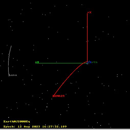

^^^ I noticed that 310,000 Km distance on August 13, with little curiosity.. ( Moon's distance from earth varies between 362,600 km and 405400 km).

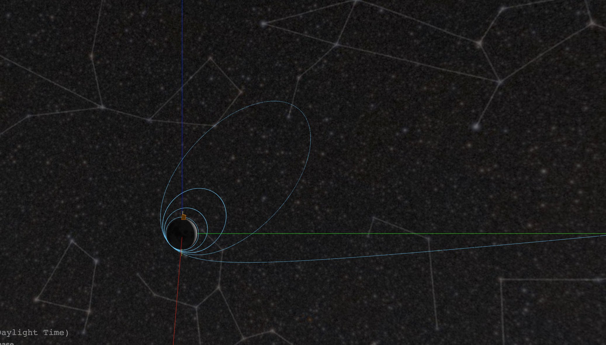

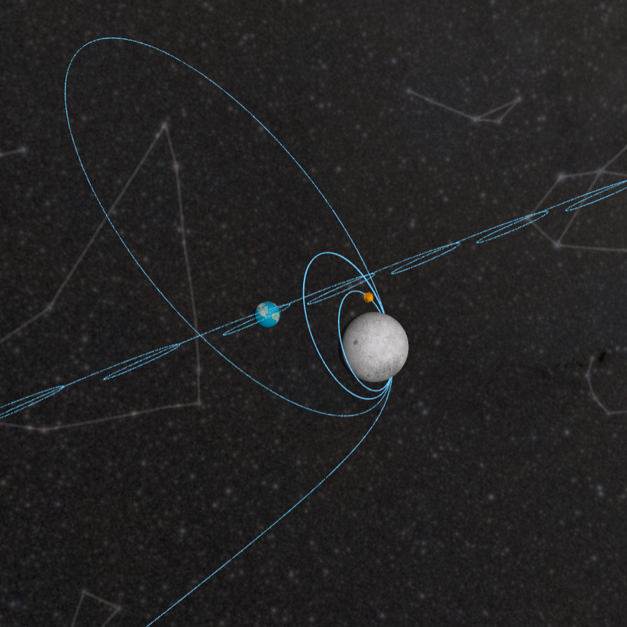

Posts: 11994
A day before New Moon, (Moon is very close to the Sun( angular position) and thus not easily visible)... Local Time is 2:34 PM EDT (GMT -4). Moon is CY3 is 400,000 Km (400,360 Km) away moving about .7 Km/sec..
It is 1897 Km from the center of the Moon, Just 159.5 Km above the surface, Moving at 1.61 Km/sec (wrt to Moon)... Pretty close to the north pole of the moon.
Here are the orbits in XY, YZ and ZX plane... and a picture of the surface, if one looks out of the window of CY3..
X-Y Axis, North pole is is on the center of the moon... CY3 is the red dot. (Earth is toward red axis)
Y-Z Plane: (North pole is at top, CY3 is red dot.. Earth is far away (see red axis -- coming out of the screen towards you)
ZY Plane: (CY3's Earth orbit could be seen on the left..) (Earth's direction is 'below' (going away from the screen).. but orbital plane is tilted so you can see the CY3 orbit around earth part to little left)
Scene below: (Landing site is on the other pole_

Posts: 11994
Earth Bound:
Lunar Bound
4- 14 August 2023 - 151 km 179 km Success (Orbit Time Approx 2.07 h) (ISRO Figures: 7434 sec)
5 16 August 2023 - 163 Km 153 Km Success - (Orbit Time 2.05 h)
17 August 2023 Lander Module Separation
Click images below to see animation:
Earth Bound: (Click the image to see video)
To the Moon: (Click the image to see video)
Around the Moon: (Click the image to see video)
[/quote]
Posts: 11994
^^^ The orbit times, measured by ammature radio astronomers who shared the data after 8/15 reduction (and timing across a few orbits was within a few seconds of ISRO's figures 7434 seconds (calculated from 150*177km orbit .
The reason is that Rus has no international support for telemetry relay from the " other ", hemisphere ( geographically and politically)
(Luna25 could still not be observed (by some of these astronomers who I follow, who have been trying by using sophisticated equipments ) for doppler shift..)
