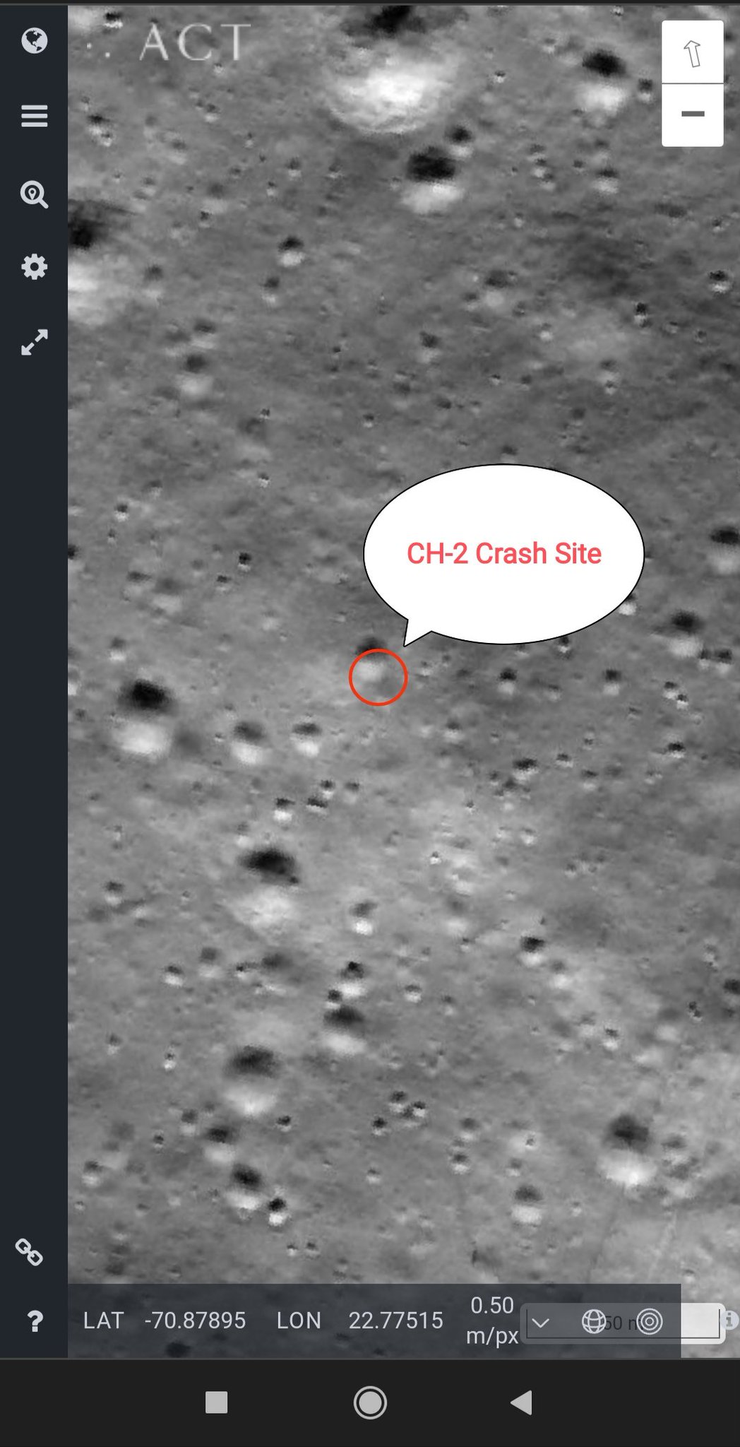

The primary landing site (from what I know - actual site we will know in 2-3 weeks :) is in the vicinity of the lunar South Pole region, located at 69.37 degrees south latitude and 32.35 degrees east longitude - No previous Moon mission has landed (softly) at a lower latitude... Thought I will put a map or the region..
CY2 has detailed map of the area - the above one is The scene above was captured from an LROC Quickmap fly-around of the site, image width is about 150 kilometers across the center. CY2 orbiter is still in orbit collecting science data.
Train your telescopes here (Image from earth - this does not change with time):

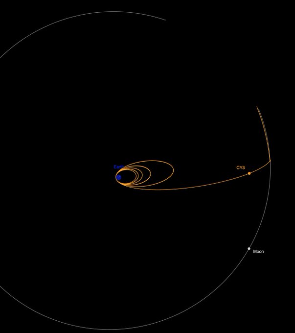

Amber G. wrote: 06 Aug 2023 00:57 Increasing Orbit:
To increase the orbit's size (altitude), a spacecraft typically fires its thrusters at apogee. This is because when the spacecraft is at apogee, it is moving slower in its orbit, and applying thrust at this point increases its kinetic energy. This results in a higher perigee and apogee, effectively raising the orbit's altitude.
Dumb question: I thought that the use of the engine at higher speeds generates a greater change in mechanical energy and a hence higher orbit (Oberth effect), than its use at lower speeds. So would it not be more efficient to fire the engines at the perigee (highest velocity) than at the apogee or am I missing something?
Allow me to answer it in little more details - some insights physics wise ...
It depends on what you want to do...
To be clear let us be sure if we are talking about sats on earth's orbit or sending a probe to some other planet (or moon).. and perigee/apogee/speed wrt to what object (frame of reference)>
Let us make things simple and just consider a spacecraft and Earth (any planet).. in Earth's orbit
- Here to raise altitude - or increase the average distance from the center of the planet - from an elliptical orbit, typical firing is done at apogee. For details see for example "Hohmann transfer orbit' (in wiki or any standard text book).
-- Typically, if you want to put an orbit in Geosynchronous orbit, you achieve an elliptical orbit initially , whose apogee is far but semimajor axis (arithmetic mean of perigee and apogee) is much less. A burn at apogee (or near apogee) puts into higher (bigger semimajor axis - near circular orbit).
---Even in when a PSLV / Or GSLV case , at the time of just before the second stage (or third stage), the orbit is ellipse, the perigee is close to center of the earth/inside the earth, as earth is not a point but a sphere :).. and rocket will hit the surface before it reaches perigee. The second stage is fired at apogee (at highest point)..
(Side note - there are more complex maneuvers which are more fuel efficient but they are more complex, takes more time to achieve the required orbit and need more calculations to make it perfect - see Bi-elliptic transfer for example)
(The subject matter, to be honest, is quite complex, one does need good math background to understand *everything* Most 'explanations' given for popular consumptions are sometimes quite misleading/false).

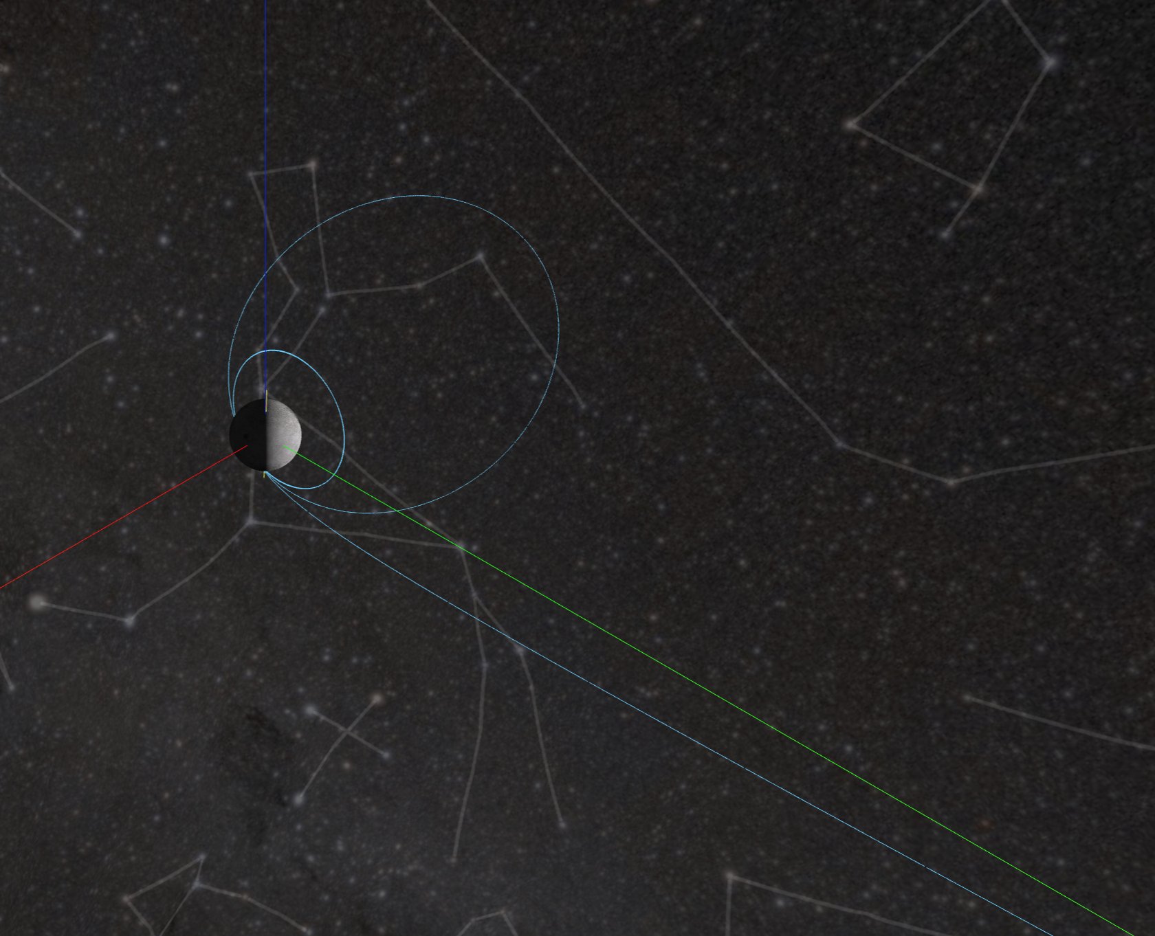

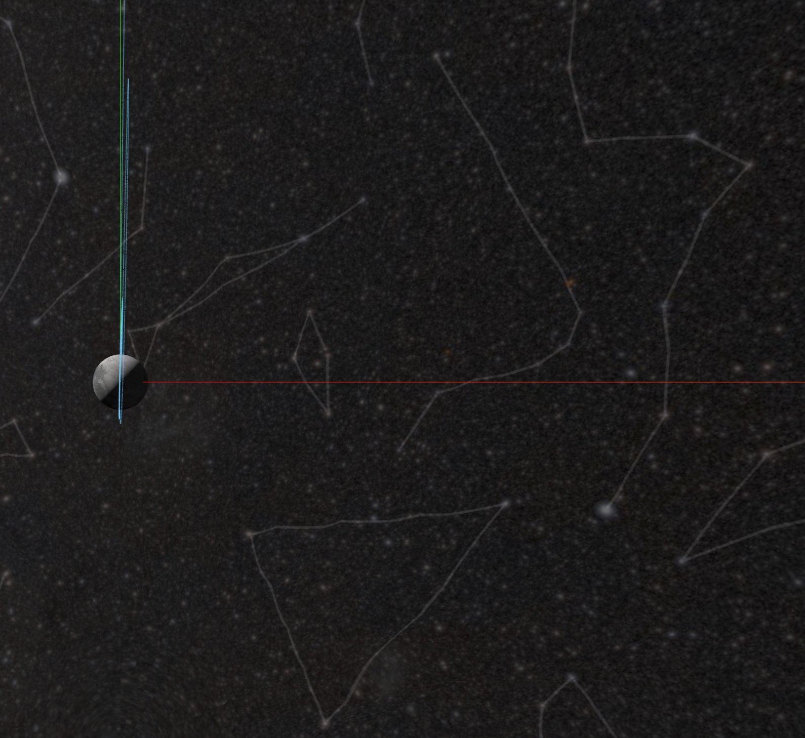

When another planet is involved, say the Moon, and take CY3's case:
- The final orbit of CY3, wrt to earth: (See <this picture posted by me before for example , the final orbit of CY3 is a circular orbit (Just like our Moon :) .. with some *small* wiggles (those 'orbits' going around moon :) ...the *last* LOI burn was done at the *apogee* (wrt to earth!) which almost doubled the 'altitude' (from earth).. now equal to the Moon's orbit.
(Thanks to ISRO's magic/calculations - the moon's position *assisted* in reducing the burn).
- The orbit (wrt to moon) decreased, by this burn. This burn was done at the *perigee* (wrt to the moon)
Oberth effect, you talked about, (also called gravity assist, sling shot etc).. is taking the advantage of moon's position.. (It does require very complex computations to be precise). By carefully timing, one can reduce amount of fuel needed to make CY3 to 'capture by the moon' or *speed* it up to, say shoot it to Mars.. (with less fuel than you will ordinary need if there was no moon).
Hope this helps.

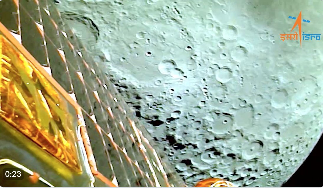

Very first pictures of the Moon captured by #CY3 as it draws closer to its destination as the world looks at us with awe and envy. (Click the image to see the video)
The ISRO Video is here:

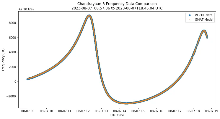

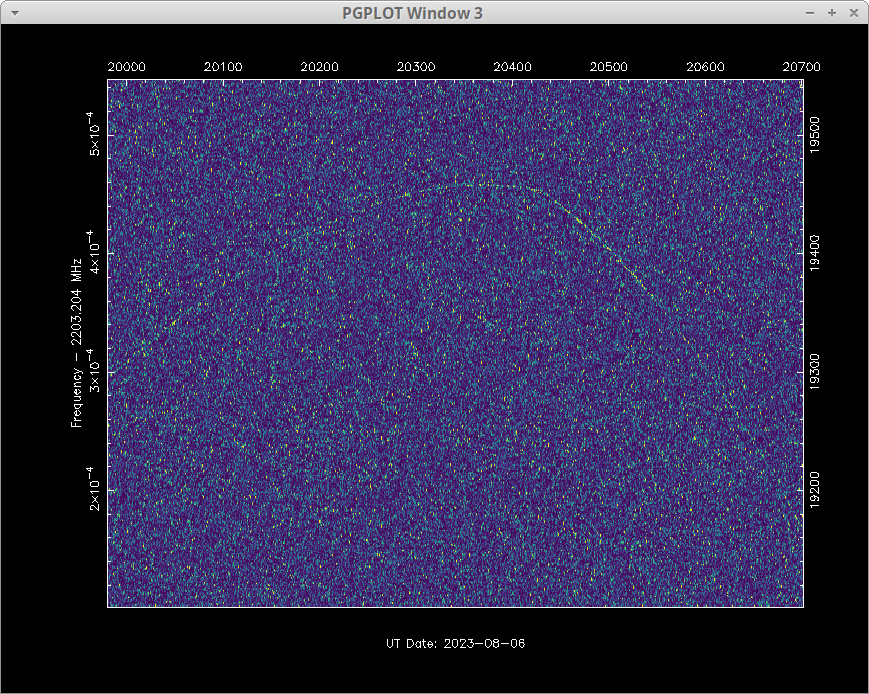

And the radio telescopes all over the world noticed it. The SNR is low (as position of the moon is not ideal for this telescope) but you can clearly see the burn ~2023-08-06 17:37 UTC w/ Doppler bend...
(ISRO has tweeted about it and brfites have already written poems about it :)... (See <above post>)

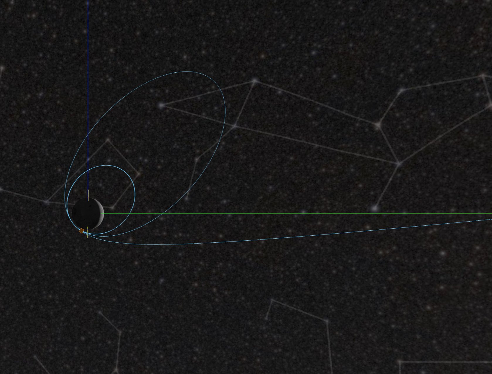

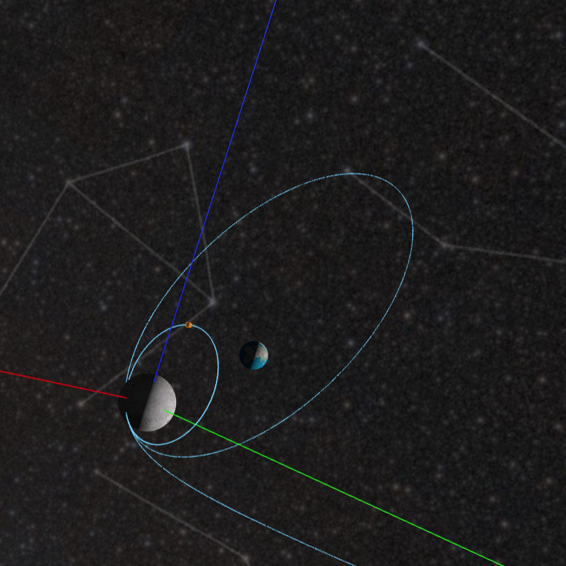

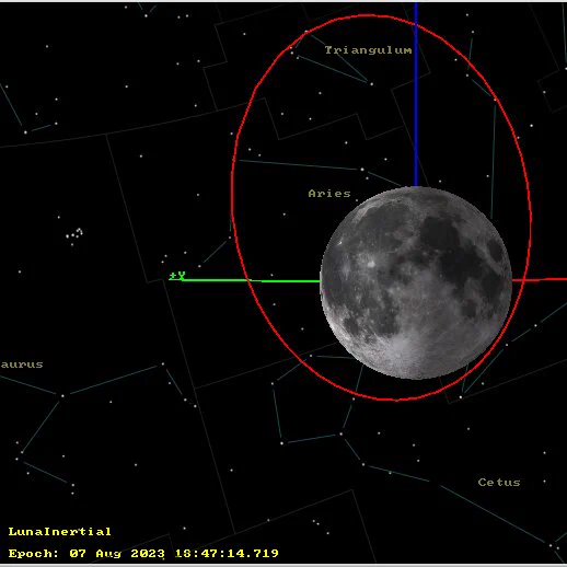

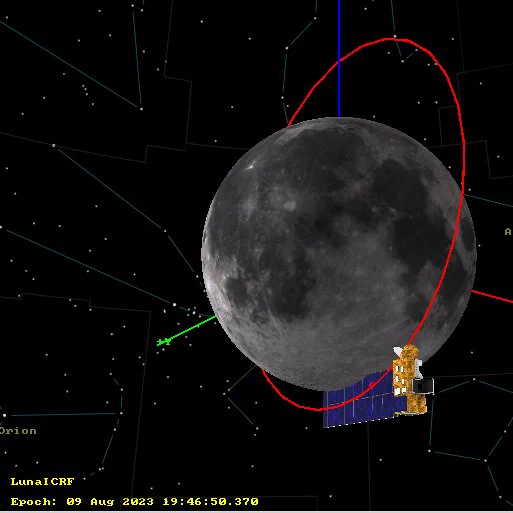

JUST FOR FUN - Ignore if not interested in boring math..:)...
I wish, ISRO, (or somebody who has data), put the ephemerides in form, we all (at least those who know elliptical orbits and do calculations - or have software to draw orbits) can use .. to know exactly what's going on...
(Sankar V have not updated the app with the latest data as yet.. so for those who want to calculate.. here is my attempt to put ephemerides in the old-fashioned (Keplerian) way....
(These are NOT official numbers, (or from any one source) from fuzzy data given by ISRO (and seeing some radio Telescope data etc).. the numbers are approximate but good enough to do any calculation)
EPOC Time: August 5, 2023, 13:58:58 UTC
Reference system Moon:
Post LOI orbit:
SMA = 10856.3 Km
ECC = 0.82
INC = 89.2
RAAN = 268.2
AOP = 289
TA = 356
(For those whose knowledge about Keplerian orbital elements is rusty, the acronyms stand for the following:
SMA: Semi-Major Axis
Ecc: Eccentricity
Inc: Inclination
RAAN: Right Ascension of Ascending Node
AOP: Argument of Periapsis
TA: True Anomaly
Here's a brief explanation of each term:
Semi-Major Axis (SMA): The average distance between the center of the primary body (e.g., a planet) and the orbiting object (e.g., a satellite) in an elliptical orbit. (See my old post, it is simply average of Perigee and Apogee - (ISRO gives altitude so you have to add Moon's radius)
Eccentricity (Ecc): A measure of how elliptical an orbit is. An eccentricity of 0 indicates a perfect circle, while higher values indicate more elongated orbits. ( Geometric mean of perigee and apogee is semi minor axis)
Inclination (Inc): The angle between the orbital plane and a reference plane - (Moon's equator) for polar orbits it is 90 deg.
Right Ascension of Ascending Node (RAAN): The angle measured along the celestial equator from vernal equinox to the ascending node of the orbit.
Argument of Periapsis (AOP): The angle measured in the orbital plane from the ascending node to the periapsis.
True Anomaly (TA): The angle measured in the orbital plane from the periapsis to the current position of the orbiting object.
These orbital elements are used to fully define the shape and orientation of an orbit in celestial mechanics. They are particularly important in the study of satellites, planets, and other celestial bodies' orbits around a central body..
After the first orbit correction, we have perigee = 1737.4+170, Apogee = 1737.4+4313 so SMA = 3979 Km
(Calculation of ECC is left as an exercise - INC is not going to change
(Okay SMA = 3979 Km, ECC = 0.52 - If my calculations are right :) )

Current Orbit around Moon with updated Status: As on 8Aug 9:30 IST
Posts: 11712
Re: Chandrayaan 3: Launch and Discussions
Continuing ..
Looks like JPL has not updated the data -- but using data from other sources (radio telescope doppler data..
Amber G. wrote: 07 Aug 2023 08:09
Post LOI orbit:
SMA = 10856.3 Km
ECC = 0.82
INC = 89.2
RAAN = 268.2
AOP = 289
TA = 356
<< For details of what these symbol means see my last post..
Eg after 2nd LOI data. Two perilunes were visible. The data supports ISRO's figures *nicely*
Basic parameters as I put in my last message and here .. a = 3975.4km, T = 22489s (6.25 Hours orbit time) are consistent with statements of ISRO 170x4313km orbit.
So the elements are ( Calculated from this - They are not official but mathematically quite accurate)
Epoch = '07 Aug 2023 12:32:38.000';
SMA = 3975.38
ECC = 0.52
INC = 89.28
RAAN = 268.59
AOP = 288.82
TA = 0.56
< Orbit from this >

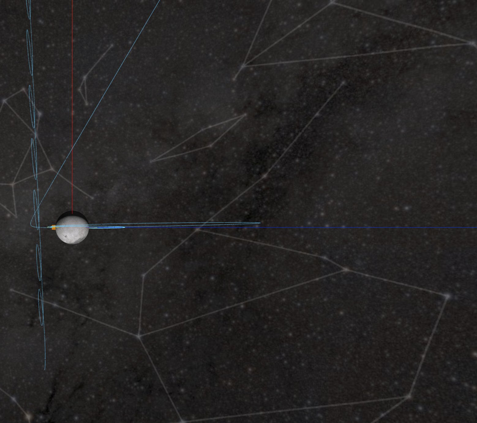

Any way, As I post, Using Horizon data/Sankar V. animation has been updated (Browsers may give some trouble, Chrome works better than others, I think): For BRF Archives:
August 8, 2023 9:40 AM (Local time in Ohio = EDT = - GMT-4),
CY3: Distance from Earth 382,572 Km, moving at 2.4 Km/sec
(Wrt to Moon: 1933 Km (Just 196 Km above the surface) moving at 1.96 Km/Sec is CY3.
(Nearly polar orbit (Inc = 89.2 Deg), Orbit period = 6.25 Hours..
Orbit looking in 3D, and projections on XY, YZ and ZX planes..
(Three D view)
Z-X Plane.
Z-Y Plane
X-Y Plane
(Lunar poles and star background is added to get the orientation right.
( You are free to use these images but please acknowledge BRF/poster/Sankaranarayanan Viswanathan/Horizon if you use these images)

And this was my analysis of C2 failure. Prior to the talk, my post few days back.
disha wrote: 18 Jul 2023 12:01
For the moment lets assume that In C2, the velocity must have been a derived value. Based on various calculations on the rocket burn time, the initial rate of approach etc. Keep this as derived_velocity attribute.
The lander was given a specific target, and as it approached the target, its parameters were to approach it at a specific velocity and angle. Keep this as intended_target attribute.
Now from here there are two paths that open up:
1. As the lander descends, it needs to know how much burn it has to do to reach the intended target.
2. And approach the intended target at the correct velocity
For item #1, it has to increase the burn and that will increase the velocity. However it has to reach that particular spot and the increased velocity is not desirable since
3. It will overshoot the intended_target AND
4. The derived_velocity of approach will be very high and over the margin.
That means that the braking rockets need to fire to bring the lander under the velocity limit. However doing the same will mean the thrusters have to fire more to approach the intended_target.
This back & forth firing increased the attitude deviations which led to a circular lock in to more thruster firing. Think of it as locked into a thrust/counterthrust "outward" loop. That is the errors now build up leading to more errors (attitude deviations) and this overwhelms the computing unit while the lander runs out of fuel. Thus a crash land.
The changes in C3 is now significant. First of all, the algorithm is "opened up". Instead of going to a particular target, it gets a set of targets and parameters, all achievable. This set of targets are identified by the excellent survey carried out by C2.
Second, with the laser doppler velocimeter, at any point the lander knows its true velocity. So now the algorithm, just has to calculate what targets are reachable given its current velocity and approach one of the priority and as it reaches it, fire the reverse thruster and hover over the target and land.
Also the central thruster which was added to clear the moon dust away is eliminated. And does not compete for its share of fuel.
In nutshell, the algorithm locked in and tried to manage its "approach" parameters instead of "given the approach parameters", which target can be achieved.

The 3rd LOI burn has occurred ~07:30 UTC per looking at doppler (!)... measured orbital period of 11492 secs vs about 11503 secs ..
success of the burn is visible to all..
