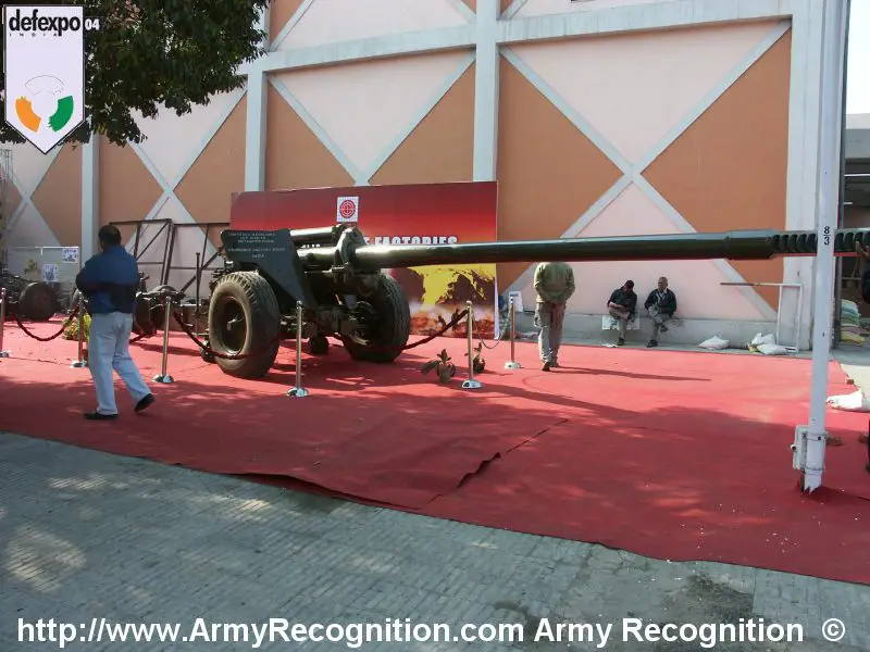

Below is the link to photo showing the OFB version of the M46 upgrade from around 2002-2003. It was displayed in Defexpo in Delhi.
By the way the OFB upgrade of the Bofors with 45 cal barrel was also displayed at the same defexpo. Perhaps at the time it was only an upgrade of the barrel from 39 cal to 45 cal.
https://www.armyrecognition.com/Asie/In ... dia_01.jpg

mody wrote:Below is the link to photo showing the OFB version of the M46 upgrade from around 2002-2003. It was displayed in Defexpo in Delhi.

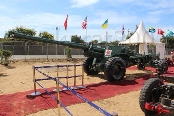

tsarkar wrote:
Kakarat had taken some good photos that he can post here
Are you talking about these sir?
https://twitter.com/kakarat2001/status/ ... 4371426310
tsarkar
Posts: 3263
Joined: 08 May 2006 13:44
Location: mumbai
Post by tsarkar »
Yes. Your photos are the best photos of the Sharang on the internet showing a great deal of details. Thank you for doing a great job of taking these photos in the hot sun.
As one can see, Sharang is different than Israeli or older OFB designs.
While I've been quite critical of OFB in many areas, on this domain OFB has performed phenomenally well with Sharang and Dhanush.
Kakarat
Posts: 2221
Joined: 26 Jan 2005 13:59
Post by Kakarat »
tsarkar wrote:Yes. Your photos are the best photos of the Sharang on the internet showing a great deal of details. Thank you for doing a great job of taking these photos in the hot sun.
Thank You sir
I have High resolution version available, they were shot at 18MP and posted only cropped & scaled images on twitter. If you want I would be happy to send you the originals by mail
The current gun looks and actually is nothing like the old gun. Its way evolved
https://images.assettype.com/swarajya/2 ... uto=format
Presently OFB is India's best Center of Excellence in Artillery and not ARDE. Ideally OFB should lead artillery development going forward. They've silently invested a lot of time, energy, effort and knowledge creation supported by IA officers like Gen Shankar.
Yes the current Sharang upgrade as evolved from the solution offered in 2002-3. The muzzle break is different and instantly recognizable. Apart from that some lessons learnt from the Dhanush program have made their way to the Sharang project. As I mentioned in one of my posts above, the targeting offered on the Sharang by the OFB, is better then that offered by the competitors and also the haydraulic ram.
By the way, the 45 cal upgrade of the original bofors offered by the OFB in 2002-03, also featured a muzzle break design same as the old OFB M46 upgrade. The Dhanush has evolved further from those early days. Just that it took so many years to go through with the program and only now the guns are entering service.
Though in Indian defence context, better late then never.
I hope the testing of the Dhanush-52 guns also begin quickly and an order of the pending 300 guns, earmarked for the Dhanush project, is placed on the OFB for Dhanush-52 guns.
The Jabalpur vehicles factory should be taken over by GCF, to increase the production rate. Stallion trucks can be supplied directly by Ashok Leyland.
Were those two rear “light mobility” wheels part of original 130mm guns? Or is it something new from OFB?
