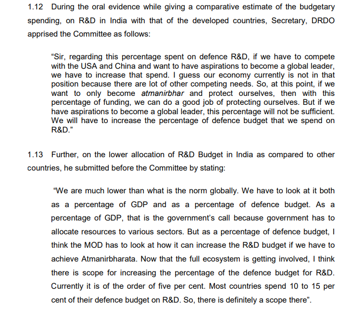

Below is why we do not have our own turbofan. But ready to invest billions in doing screwdrivergiri on foreign platforms.
https://x.com/sriramthg/status/1737775857786290317 ---> Standing committee on Defence reports are a goldmine. First up - Dr Kamat laying it out. We do not invest enough.
Posts: 23187
Rakesh wrote: 25 Aug 2025 01:28 Below is why we do not have our own turbofan. But ready to invest billions in doing screwdrivergiri on foreign platforms.

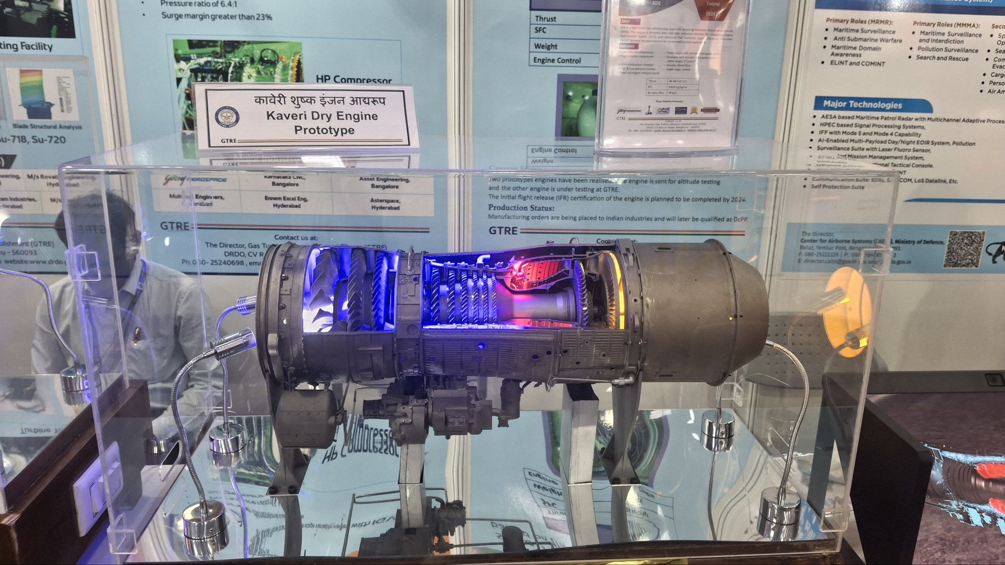

90kN effort with an enhanced dry version based on KDE?
3D Thrust Vectoring के साथ 120 KN jet engine - 90KN Kaveri Engine Confirmed
In a significant boost to India's fifth-generation fighter jet ambitions, officials from the Gas Turbine Research Establishment (GTRE) have confirmed to idrw.org that the indigenously developed 120kN class engine will incorporate thrust vectoring technology. This locally designed capability is expected to be a game-changer for the Advanced Medium Combat Aircraft (AMCA) program, pushing it toward a 5.5-generation platform. According to GTRE, the new engine will be designed to integrate advanced 3D thrust vectoring nozzles, developed entirely in India. These nozzles will not only enhance the aircraft's maneuverability but will also be optimized for rear-aspect stealth, reducing the radar cross-section (RCS) from the back-traditionally one of the most challenging areas for stealth aircraft.
