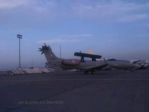

Indian EMB-145 AEW&C aircraft spotted in Algeria for the second time :?: :?: :?: :?:
Secret negotiations. ????
Posts: 2619
Re: Radar - Specs & Discussions
I think this may be the third one on ferry flight from Brazil. I recall vaguely (but couldn't find the link) that two are delivered and third is expected. The pic is too blurry to see the tail number.
