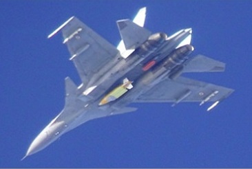

NEWS: The Indian Air Force earlier today test fired a
@DRDO_India
developed Long Range Bomb (LRB).
Upon release from the fighter, the Long Range glide bomb was guided to a land-based target with
accuracy per specified limits.
Twitter Link
@DRDO_India
Twitter Link

Wondering whether its Garuda or Garuthma!
Meanwhile, the IAF also tested SAAW yesterday in Pokhran
https://twitter.com/delhidefence/status ... 6326872071
Hopefully, these are all pre-induction trials

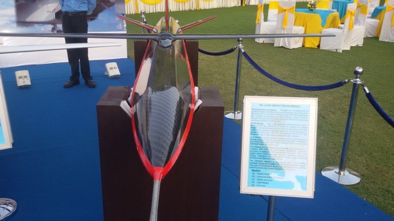

https://twitter.com/GODOFPARADOXES/stat ... 01513?s=20 ---> DRDO PGHSLD (Precision Guided High Speed Low Drag) PGM family.
Now there exists 2 precision guided (PG) variants of high speed low drag (HSLD) bomb.
1. PGHSLD non winged PGM. Range ~ 30 km.
2. PGHSLD winged PGM. Range ~ 100 km.

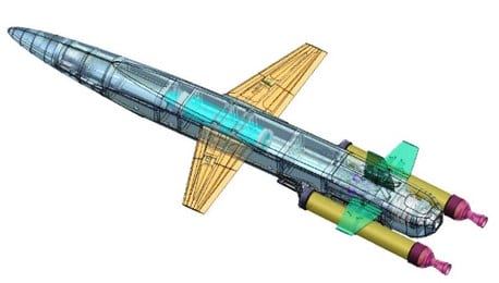

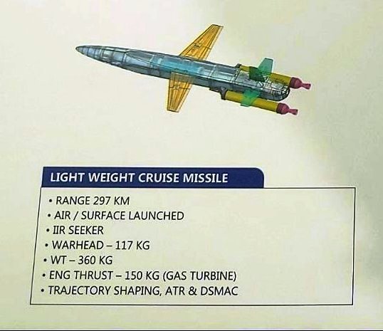

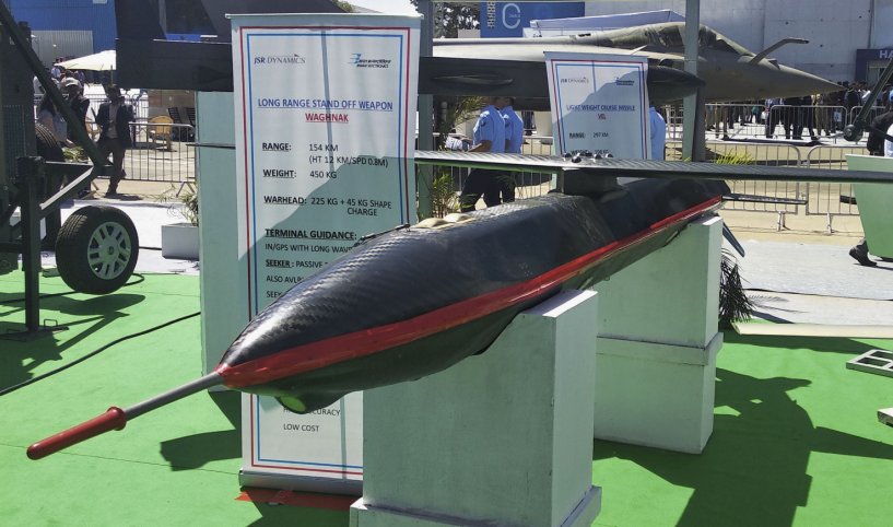

https://twitter.com/Varun55484761/statu ... 98019?s=20 ---> JSR Dynamics Light Weight Cruise Missile. The figures in the brochures are different. It may be because of different payloads/versions which have different ranges. Available in air/surface launched versions. I think Waghanak is surface launched with 150+ km Range. Air Version may have 300 km range.

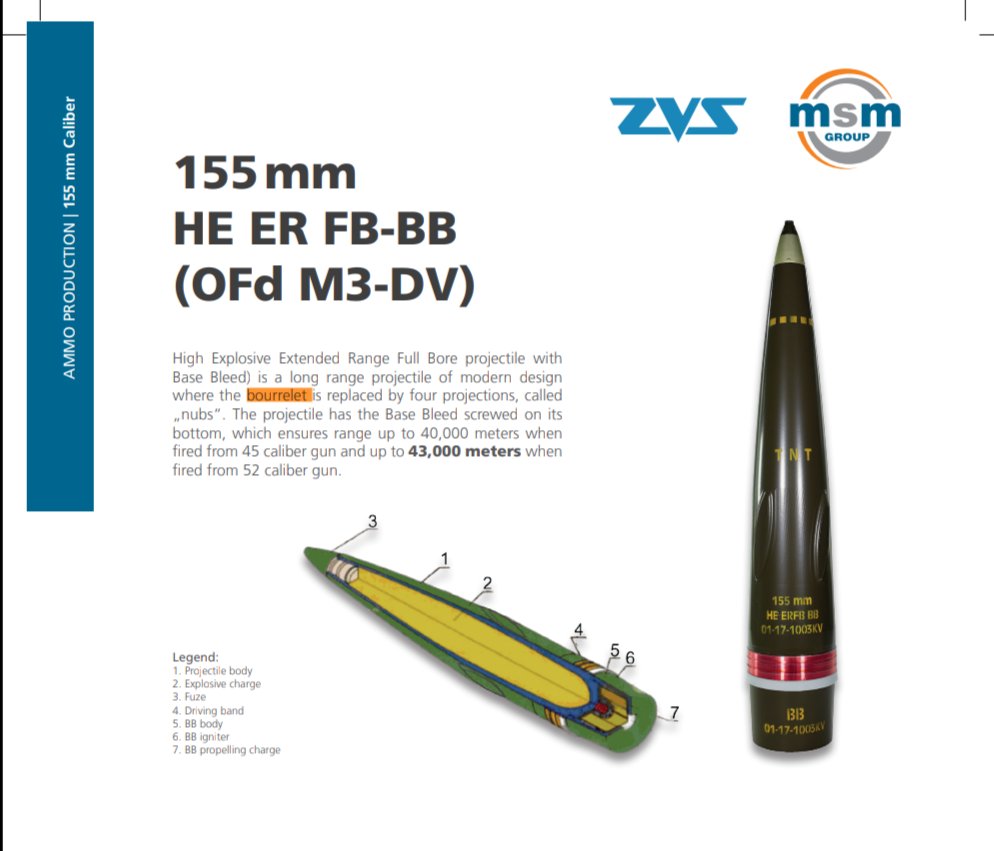

BREAKING
ARDE has received 2 bids for the 'Development of 155mm HE Bourrelet Projectile'. The 2 bidders are :
1. Ordnance
Factory
Ambajhari
2. Reliance Ammunition Limited
For Representation
Re: Munitions/sub-munitions: accuracy, power and utility
So new technology for ERFB shells.
It is not clear but see those stretched ovals or ellipses on the shell body that engages the rifling and impart spin to the shell.
Bourrelet is the forward gripping surface of the shell. The shell gets spun with the two surfaces bourrelet and driving band.
