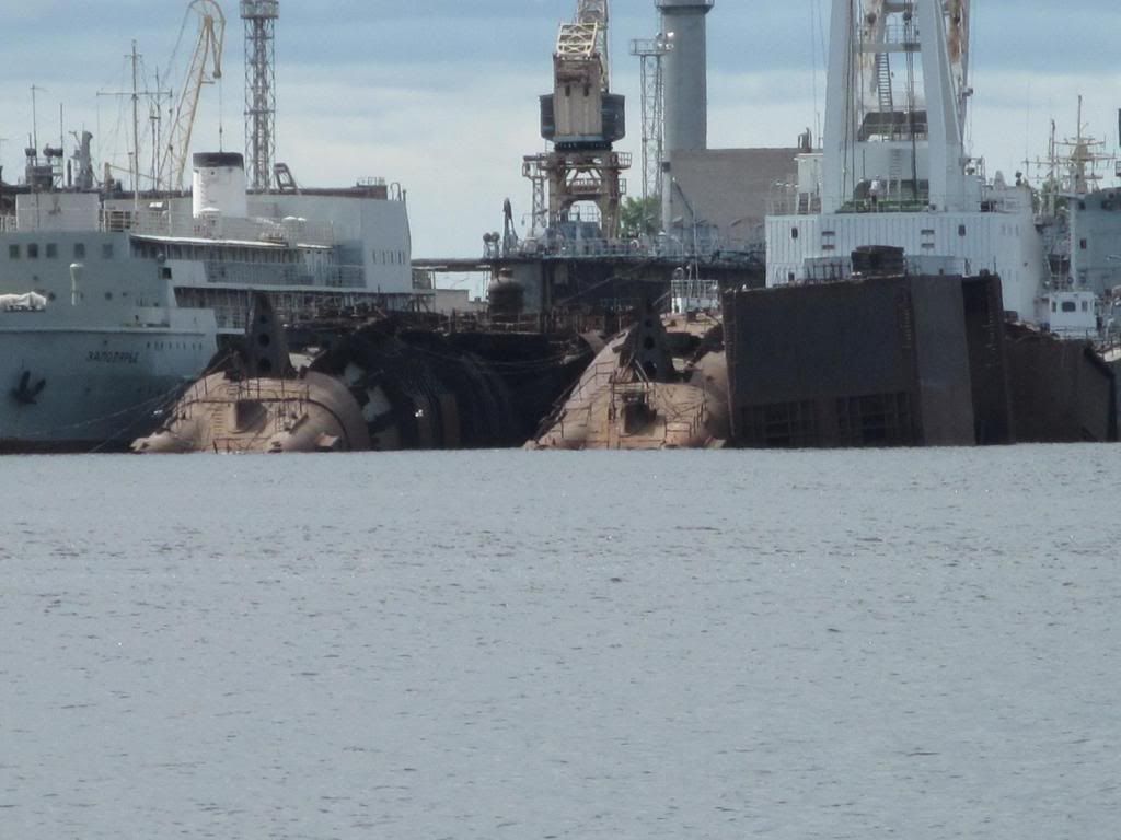

wiki claims 3 Oscar-II class in various incomplete states. would seem like Gods plan to make available
a platform to *pound* the living crap out of land based targets or SAGs.
its worth it imo to quickly fund the completion of two Oscar's to fill out the portfolio nicely. they could
presumably take over the Sagarika role leaving our Arihants free for the real meat - A3SL.

* K-139 Belgorod, laid down July 24, 1992, is currently still on the building ways at the SEVMASH Shipyard in Severodvinsk[19]. Its construction was frozen several times due to lack of funds. Finally, on July 20, 2006, Russian Minister of Defense Sergey Ivanov announced, "The Ministry of Defense does not need Belgorod... therefore, it will not finance its further construction."[20] If the submarine is going to be finished, it is not clear who will pay for it.
* K-135 Volgograd, laid down September 2, 1993; construction stopped January 22, 1998; incomplete[21]
* K-160 Barnaul, laid down April 1994; construction stopped; incomplete[22]
Rus prolly has depot and heavy repair facilities in petropavlovsk/vladivostok hopefully, else its another
leg near the melted arctic seas to murmansk area...kara sea/azov sea etc...no problem for a sub.
either way, this puppy can sail close to repair depot in the yellow sea and south china sea

The last two Oscars still are in pretty good shape:
http://i56.photobucket.com/albums/g191/ ... arnaul.jpg
Re: INS Arihant (ATV) News and Discussion -2
So 3 unfinished Oscar 2 ( Belgorod , Volgograd ,Branul ? ) , I read that the Chinese were keen to buy or lease those ? May be use it against US CBG in Taiwan conflict ?
Clicky...
