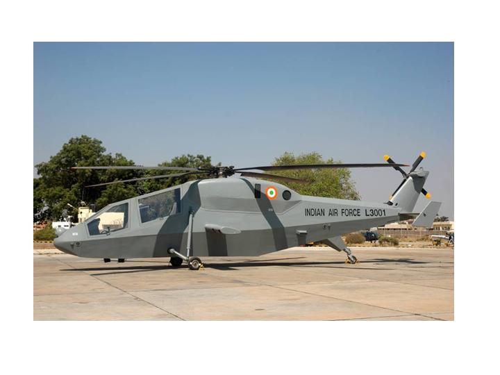

“Tiger Bird ” Media name for Light Combat Helicopter (LCH) - Link

shiv wrote:Hari Nair - I have a question
What would be the meaning of "expanding the flight envelope" of the LCH? Would it be something like "Let us try to do a 45 degree bank today and if all is well increase that to 50 degrees next week etc?
Quite right Shiv, it's a one-step-at-a-time approach.
Certain flight testing activities require extensive ground preparation, and quite of lot of post-flight data analysis before the next step is cleared.
Sometimes, the clearance is conditional – if all parameters are ok at a test point, then proceed to the next point and so on.
There are certain test flights in which if all goes well, we can cover a surprising lot of ground in one flight. And there are tests of certain systems that require checking out a whole heap of combination of settings – which means changing settings on ground after every flight & checking it out all over again – very intensive work.
The whole process is quite tightly orchestrated by the designers, the flight test engineer and ground control– nothing is done on individual whims or fancies of any test pilot.

Hari Nair wrote:Quite right Shiv, it's a one-step-at-a-time approach.
Hari Sir,
If that's the case then why LCH started doing all those stunts within few weeks of its first flight? Are we following all these testing rules/norms in case of LCH as well?
Or LCH was allowed to do all these because HAL was using the same proven power-train from ALH.
Anyhow when we looked at the testing cycle of ALH, LCA and LCH, LCH matured at a very sickening velocity.
-Sid
Re: LCH and other Helicopters Discussion Thread
Hari Nair wrote: The whole process is quite tightly orchestrated by the designers, the flight test engineer and ground control– nothing is done on individual whims or fancies of any test pilot.
Thanks for the reply.
I am presuming some of the monitoring is by telemetry and some by the pilot's reports. What is the role of a chase aircraft/helo if any?

Sid wrote: If that's the case then why LCH started doing all those stunts within few weeks of its first flight? Are we following all these testing rules/norms in case of LCH as well?
-Sid
Good point there Sid!
You answered it in part when you guessed that part of the power train from the ALH.
The power train is not identical but is similar. The variations were already checked out on an ALH prototype.
The main handling and performance characteristics of a helicopter are determined largely by its rotors - and that's been very well proven as we all know.
We opened up the manoeuvre envelope fairly quickly because of that. Notwithstanding, every manoeuvre was being monitored in real-time as well as through recorded data to obviate surprises.

Hari Sir, is this what we can expect in the future?
Note: Image name indicates this is a mockup

After looking at the picture, would it be better to design retractable wheels and pods as to give more stealth characteristics?
Raman
Posts: 306
Joined: 06 Mar 2001 12:31
Post by Raman »
Hitesh wrote:After looking at the picture, would it be better to design retractable wheels and pods as to give more stealth characteristics?
Retractable undercarriages come with a large weight and complexity penalty (hydraulics, etc.) It will also reduce the survivability of the airframe as the gear will not be available to absorb forces in a crash. Clearly, the designers have concluded that the relatively low improvement in RCS is not worth the penalties.
