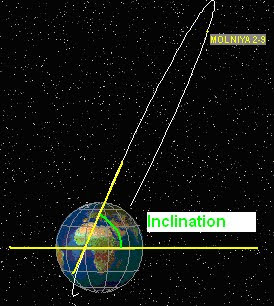

Basically these numbers tell the status of satellite in its orbit around Earth. Orbit is always in a flat plane called orbital plane and the Earth is in its one of the foci.
The satellite can be put in any of the following orbits: ( classified with respect to angle between Orbital plane and Equator.)
Equatorial: Where the orbit is over equator. So the angle i ( = inclination ) in above 2nd figure will be = 0 deg.
Polar : Where the orbit is passing near poles. So the angle i will be about 90 deg.
Inclined Orbit : Is in between the above two .. there are other subcategories in this : prograde, Retrograde and a very special called as Molniya which has an inclination angle of 63.4 deg.

A Practical example with an actual satellite graphic is shown here.
First figure depicts Apogee, Perigee, Major and Minor axes, Ascending and Descending nodes, True Anomaly, Argument of Perigee
( We said TRUE Anomaly whereas in the list given above there is MEAN anomaly. No, it is not typo.. TRUE and MEAN anomalies ARE different. It is an involved subject and so will be covered separately at end of this post.
The satellite orbit crosses equator at two points.. once while traveling from North to South and second time from South to North . These points are called as NODEs.. The first case N>>>S) is defined as DESCENDING node because the satellite is traveling downwards. The S>>>N node is called as Ascending node. ( In the figure Ascending node is in front while descending Node is behind Earth hence can’t be seen ). Inclination is defined as the angle between orbital plane and Equator at Ascending node measured from East.

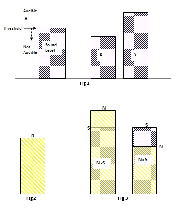

How do we hear? A very primitive question.
The sound falling on the ear drum transfers the vibrations through a chain of bones to the Cochlea within which these mechanical vibrations get converted into sensory nervous signals which we call as "Hearing the sound".
Let's go a little deep into this process. The sound vibration energy received through air creates vibrations into the eardrum. But for the eardrum to vibrate some minimum quantum of energy is required. If the energy that is falling on eardrum is less than that quantum then even though the sound which IS present will not be heard because the drum will not vibrate. This minimum required power is the threshold of hearing and if one has to whisper in this ear then the whisper sound should be above this threshold level. So in the figure below sound level B can’t be heard but A will be hearable because it is above threshold.
But the real life is not so straight. In the example above we assumed that the surroundings are totally noise free ( like mid of the night in a very quite location away from noises like railway, tractor, bore-well digging, vacuum cleaner, pressure cooker etc. ). We now take a situation wherein the sound level is above threshold so it will be heard clearly in noise free room but what will happen if there is a surrounding noise ( say rumblings of a digging machine nearby )? Then the ear will receive both Noise and the sound but the power of noise is more than sound so the ear-drum will vibrate according to Noise and there could be a feeble vibration due to sound. In short the the useful sound will not be heard clearly even though it is above threshold. To state it mathematically we say that more the S/N ratio, more clearer the sound quality.
Also notice one more phenomenon: You can hear to the whisper if the speaker brings his mouth near the ear .. if the mouth is not very near to the ear then the other person will not hear the whisper.. you have to speak louder and as you move away from the other person you have to talk still louder. This is because the sound intensity decreases as it travels more distance. ( In fact it decreases as the square of the distance i.e. 1/d^2 hence is called inverse square law )

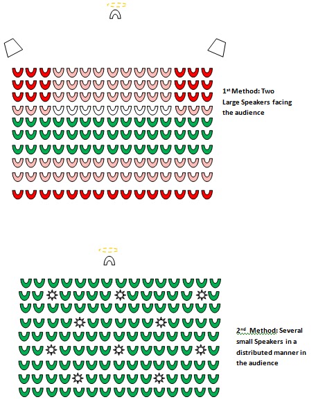

Now think of a situation where a person has to address a large gathering of many people spread over a large area. The speaker has to shout so much that his sound level is above threshold of hearing upto the last person. But there is limit upto which a human sound can be created. So we use Microphone-Amplifier-Loud Speaker arrangement for a large crowd.
Here again we note the following two possible arrangements:
In the first method there are few high-power speakers. Here the speakers emit large volume sound because the sound has to be audible upto the last row which is far off from speakers. But this is deafening to the persons seated next to the speaker. This leaves a large percentage of crowd un happy ( red faced .. so red in the diagram .. half near the speaker are unhappy because of large volume they experience while the last few rows are also unhappy because they can’t hear clearly. A few of course are cool green happy.
In the second arrangement there are many low-power speakers. This distributed power emission makes everyone get a pleasent volume of sound energy because even though the speakers are operating at low volume they are near to every person in the audience.
Moral of the story: for avoiding large pollution put many low power transmitters spread over the area.

1. In a communication system the receiver has a minimum detectable level known as Receiving Threshold. For the receiver to detect a signal it is necessary that the signal level at the front end is above this threshold.
2. The receivers are rarely noise free. The noise could be inherent to the front end or the noise level in the vicinity of the receiver. For the receiver to detect the signal the signal has to be more than the noise level by a minimum level called as a Threshold Signal to Noise Ratio ( S/N Ratio or SNR ). If the SNR is below this threshold then the detected signal will be noisy. The more the SNR better the detected signal quality. ( this statement is true only upto a certain value. Beyond a certain value the signal quality remains constant even if SNR is increased.)
3. The signal level decreases as the distance between Transmitter and Receiver is increased. It follows inverse square law.. the signal level fall is proportional to the square of the distance between transmitter and receiver.
