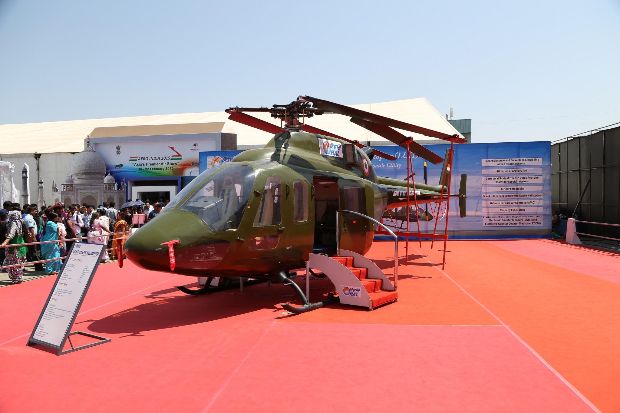

LUH will be powered by the Ardiden 1U which was bench tested and delivered to HAL in December 2014. Although, there is no credible information on its output power, there are a few pointers:
1. Safran's Tweet:
#DidYouKnow? #Ardiden 1U/#Shakti 1U on #LUH will allow the helicopter to fly at 6,500 m = 20,000 feet
2. HAL is developing its very own turboshaft, rated between 1000 kW and 1200 kW.
3. By the way, does anybody have a clear picture of the display board placed in front of the LUH?
