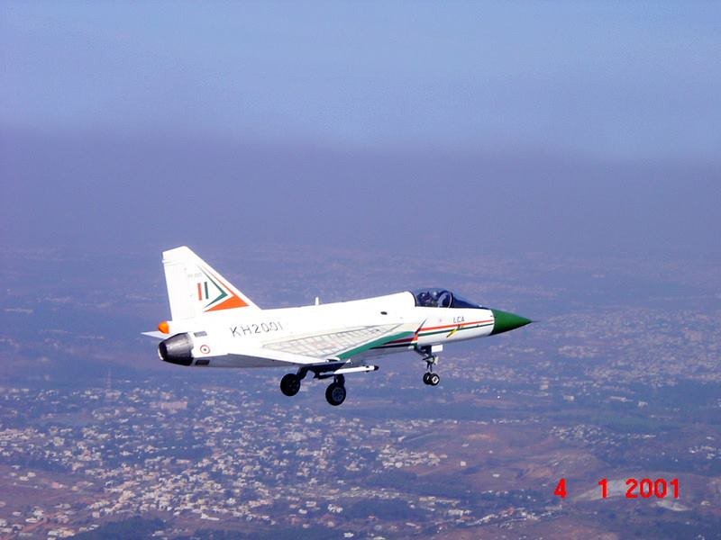

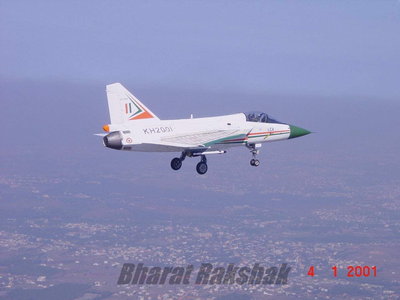

• TD-1 ... KH2001 ... 04-Jan-2001 ... Wing Commander Rajiv Kothiyal

For all the Tejas lovers. Do you remember the date today? Where were you on 04 Jan 2001? Today is the 20th anniversary of the first flight that launched a billion dreams in India. Many pranams to the team at HAL, ADA, IAF and others that made the dream possible.
Jai Hind! Jai Jawan! Jai Vigyan!
https://twitter.com/writetake/status/13 ... 93568?s=20 ---> How it started and how's it going.
One plane, many stories! Tejas -- now flying in the hearts of a billion-plus.
How it started....
....and how it is going

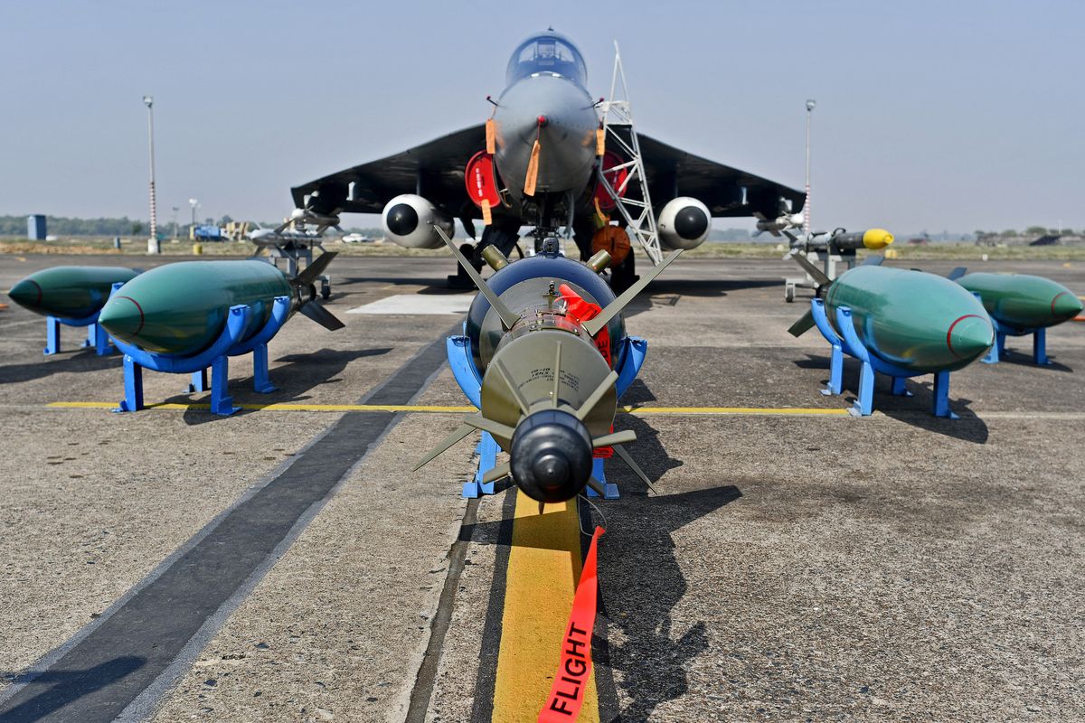

Posts: 21710
https://twitter.com/Amitraaz/status/134 ... 79105?s=20 ---> Missiles and bombs sit on the tarmac in front of an IAF Tejas, developed by HAL, at the Kalaikunda AFS, West Bengal.
https://twitter.com/Amitraaz/status/134 ... 08769?s=20 --->
* R-73
* Derby
* HEAB MK11N and its variant (?)
* GRIFFIN LGB
