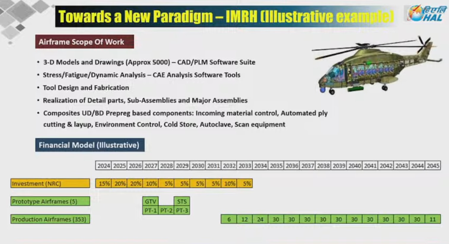

Started a new thread based on the excellent presentation by HAL on the upcoming IMRH. Please use this thread going forward for all IMRH related discussion. Thank You.

IMRH presentation during Aero India.
Tons of details on IMRH including designs shared. Among other details, "The wind tunnel tests have been better than expectation. The actual performance characteristics are more than likely to be better than indicated."
We are truly on way to being Self Reliant in Rotary Wing Aircraft. HAL Rotary Wing Research Center is as good as any in the world.

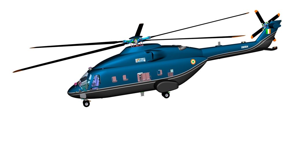

Posts: 23143
Re: Indian Multi-Role Helicopter: News & Discussion: 06 Feb 2021
Please check out the first post of this thread, to see renders of the IMRH. You will not be disappointed.

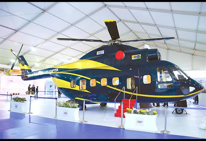

Rakesh wrote:Please check out the first post of this thread, to see renders of the IMRH. You will not be disappointed.
Looks very TFTA
The engine inlet seems to have been moved when comparing the mockup to the latest design.
Used to be in the front, like Mil Mi-17, has been moved to the side like the Dhruv.
