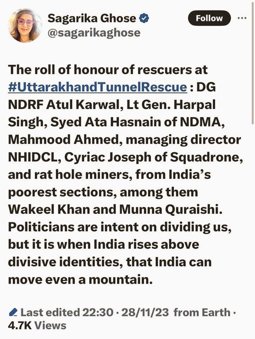

A satisfactory conclusion.
It is not lost on anyone that no expense was spared for some men from the very poorest regions of India. That in itself is notable.
Those rat drillers are real heroes.
