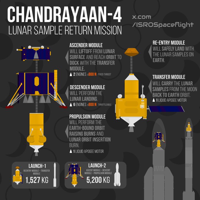

Chandrayaan-4 will carry five payloads:
1. Propulsion Module (PM) -- guide spacecraft to lunar orbit
2. Descender Module (DM) -- make lunar landing
3. Ascender Module (AM) -- will collect lunar samples and lift off from Moon to lunar orbit
4. Transfer module (TM) -- will dock with ascender, get samples and return to Earth’s orbit
5. Re-entry module (RM) -- land on Earth with lunar samples
Two launch vehicles involved:
1. Isro's workhorse PSLV rocket
2 Heavy-lifter LVM rocket
Launch date: Around 2028
Mission objectives:
1. To perform safe and softlanding on lunar surface
2. To demonstrate lunar sample collection and containersiation
3. Demonstrate ascend from Moon's surface
4.Demonstrate docking and undocking in lunar orbit
5. Demonstrate transfer of samples from one module to other
6. To demonstrate return and re-entry to Earth for sample delivery
Re: Chandrayaan 4: Mission, Launch and Discussions
From one of these knockoff imitation not-really-ISRO accounts, but still a nice graphic:
