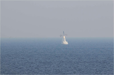

TOI ticker is reporting that an underwater version of Brahmos has been tested.

Yeah, but not much info
Re: Indian Missiles and Munitions Discussion
livefist:
The submarine-launched variant of the BrahMos supersonic cruise missile was successfully testfired today for the first time in the Bay of Bengal, off the coast of Visakhapatnam. The launch and test was successful, with the missile hitting its target 292 km away. Photos shortly.

Singha wrote:livefist:
We'll never really know what was really fired.
Singha wrote:also the satcom terminal for inflight comms. in earlier blocks it was a fixed target and once fired it could not be retargeted I think.
Aha! So even Thawk is also a 'loitering cruise missile' !

Does India have a sub that Brahmos SLCM will be used in? Both present and those under-construction.

shyamd wrote:Does India have a sub that Brahmos SLCM will be used in? Both present and those under-construction.
No... Next line of subs (the P75I, when it happens) is supposed to have the VLS for Brahmos..
Livefist has updated photos of the underwater launch Brahmos..

Submarine-launched version of BrahMos test fired.
India Wednesday successfully carried out the maiden test firing of the over 290km-range submarine-launched version of BrahMos supersonic cruise missile in the Bay of Bengal becoming the first country in the world to have this capability.
The submarine-launched version of BrahMos was successfully test fired from an underwater pontoon near Visakhapatnam, BrahMos CEO A Sivathanu Pillai said.
This is the first test firing of an underwater supersonic cruise missile anywhere in the world and the missile travelled its complete range of over 290 kms, he said.
He said the performance of the missile during the test launch was "perfect".
Ship and ground-launched versions of the missile have been successfully tested and put into service with the Indian Army and the Navy.
The maiden test of the submarine-launched version of BrahMos comes over a week after the indigenously built long-range subsonic cruise missile Nirbhay failed to hit its target in its first test.
"BrahMos missile is fully ready for fitment in submarines in vertical launch configuration which will make the platform one of the most powerful weapon platforms in the world," Pillai said.
Defence minister AK Antony congratulated DRDO scientists and Russian specialists along with officers of the Indian Navy associated with the project for successful test launch of missile from an underwater platform.

From the pics of K-15/B-05 in Jan you could see a part of underwater pontoon ( like 2 ends of a ship). How come you don't see that in case of today's brahmos test? Different pontoon may be?

Looking at complete absence of any pontoon marker etc i wonder if it was the ins chakra that fired it? Does the 23 inch tube of the akula torpedo room enough for brahmos? Notice it came up at an angle...typical when fired vertically from a moving sub or from a torpedo tube.
