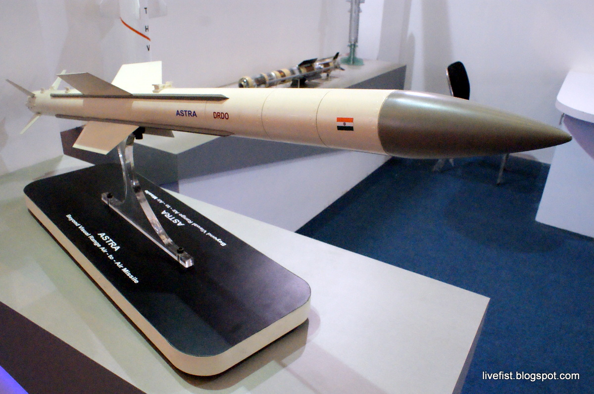

As to changes, when the original Astra MK1 prototype was put in tests, it had severe aero issues and had to be scrapped totally.
From 2010 (actual tests): http://2.bp.blogspot.com/_HtzHWTyO9xc/T ... issile.jpg
From 2011 AI: http://2.bp.blogspot.com/_o_no4M2xEPY/T ... 752532.JPG
By 2013: http://3.bp.blogspot.com/-6iUbQKeR9b4/U ... 770640.JPG
Per Chander they did a detailed redesign...might have shaved off some extra kilos via better avionics (e.g. the new Astra MK1 has a laser prox fuse) and better packaging.
But both have the same range 44Km (8km alt) and 112 km (15-16km alt). LCA has reached 50K feet so far (thats around 15km) so a launch at that height will give MK1 (against approaching target etc) 100 km ranges.

Third one... its MK1 revised. The second image (2011) is basically WIP MK1 before config was frozen or an indication towards MK2.
Heres an image with the new MK1 test - you can see the missile pic has been inserted into the brochure and was taken from below on the ground.. but PS'ed into the picture as if its an A2A launch
http://3.bp.blogspot.com/-TigLajcRPNE/U ... 281%29.jpg

that's what i thought when i first saw this missile at AI-2013.
But in one thing i have some doubts. It has :
AR guidance.
dual mode guidance.
seeker with IRST.
Does it imply that Astra have Multi-seeker. RF+IR in terminal mode in single missile ? and in mid course it will be guided by INS.
Also , Off-bore-sight launch angle is better than earier version of r-73, so it certainlt can be used as CCM.
Re: Indian Missiles and Munitions Discussion
dual mode guidance means mid course guidance (with INS/ datalink) and RF (terminal).
IRST means the fighters IRST.
so the missile only has one seeker and that is RF.

Karan M wrote:dual mode guidance means mid course guidance (with INS/ datalink) and RF (terminal).
PS: if you went to AI 13 share some pics of the eqpt, info boards etc so we can sit and look through them. thats always fun. ;)
It say slaving seeker with IRST/HMS and there is RF seeker only for terminal phase, so does it mean IRST can be used as mid-course update?
well i am not expert like you guys so i have some random pics of MAWS, MSWS, Marrech sonar and FCS, AEWC - MC, TRMM, AAAU, ABFU, etc and that too with simple digi.. :)
what it means is that you can point seeker to where IRST is looking. HMS also operates on same principle.
so heres how the whole thing may work.
so, you detect a target at long range using IRST, approach him silently - his RWR says nothing, use your HMS to lock him up and fire a missile at him at short range barely giving him time to react!
or you can look at them independently and how theyd work with missile
for instance, left or aircraft centerline, 20 degrees is a target. you saw this and your helmet captures the location and sends it to the missile.
now, if in CCM mode, you align seeker there using HMS, use either LOAL (lock on after launch) or LOBL (lock on before launch). since seeker range is few tens of km (26 km), LOBL makes more sense, and off it goes. so you can do this with tejas, su-30 mki, mirage and mig-29. all have HMS. now, here you "lost" surprise since missile went active but might still surprise the target since you are at close range and he is busy putting out flares and not chaff. or using a jammer, because he thinks a short range missile is IR.
now, with IRST ditto. your IRST has detected a target at a particular azimuth, and you dont know the range (you have the LRF for that in Su-30MKI, MiG-29 OLS). if you have a range with the LRF, you can launch it in LOAL mode. most fighters today still dont have LWS sensors (eg PAF F7, Mirage). missile goes to point x, seeker turns on and thats it, you achieved near complete surprise. seeker turned on too late to matter. on the other hand, LOBL will operate as above. advantage though was that as with HMS, you didnt lock on to the target with a FCR so he really didnt have a clue you were there.
man, no expert here, but now you are just tempting us with details. ;) put it all up on picasa and link it here sir! theres always a chance we might learn something new.
