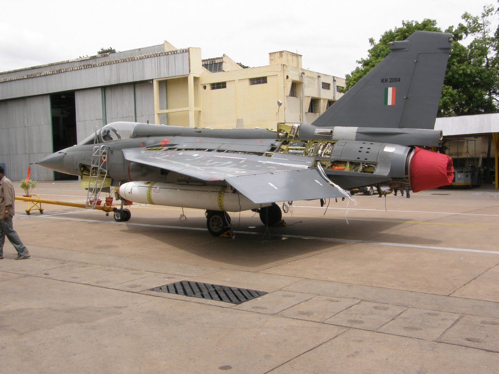

Indranil, The APU exhaust is visible on the right hand side of the aircraft, just below tail fin. The EPU is necessary to power electronics in case of catastrophic failure where even the fuel supply of even APU is cut off. F-16 also has a hydrazine powered EPU. APUs run for a prolonged period and EPUs only for a few minutes.
The engine bay cooling vents are also present.

That one is probably the exhaust and, the grilled inlet between the MLG doors is probably the inlet, if this F-15 schematic is anything to go by.
Re: LCA News and Discussions, 22-Oct-2013
I think you are right. Explains why the rectangular opening is sooted.

indranilroy wrote:I think you are right. Explains why the rectangular opening is sooted.
Indranil,
Actially the image does add something. It correlates the location of the jfs inlet/exhaust with its mounting location. A second APU or any other auxiliary that was never designed in the tail root is more than worthy of an AI15 inquiry. Something unusual must have happened if power to electronics is required in the air minus the engine and another power source was integrated.
I still say the tail root scoop doesnt appear to have anything with power generation given the recent JFS starts in Leh (reported just yesterday).

http://img7.imageshack.us/img7/4035/escaneo001.jpg
this shows the jfs location. the previous posts point to different inlet/exhausts for jfs.
Shreeman wrote:^^^
JFS intakes and exhaust vents generally stay flush with the body because they are used mostly when the plane is stationary. If one uses scoops, then when the JFS is not working (which is almost always in flight), no air goes into the intake and everything is spilt out. Imagine the spillage drag. It is like flying with a cardboard stuck to the inlet of the scoop.
AFAIK, the JFS is placed just aft of the MLG. The idea that the rectangular hole is an exhaust is also verified by this picture.
Having said that:
1. I do not know since when the JFS became part of the line-up. That will be great information.
2. I have no theory on what purpose is served by the metallic exhausts on both sides of the spine below the fin. Them being metallic suggest that the exhaust is hot.
Shreeman wrote:^^^
That diagram is not current. It shows the state of the TDs.

indranilroy wrote:Having said that:
Those two ducts have been at those locations since TD1.
It is possible that JFS has been included since the beginning(?)
Those are afterburner venting ducts, as per the cutaway.
I am speaking of the vents marked as APU exhaust in this pic.

I don't think Tejas needs an APU when it has JSF. They can very well make the JFS run the generator via AMAGB and a clutch mechanism. Engine bay cooling could be one reason but isn't it protected by a firewall anyway? Check this image posted by Indranil, it shows the innards of that hump. Looks like it's there to cool some electronics. Possibly EW related stuff.
http://3.bp.blogspot.com/_zUe7sq7m3h0/S ... +tank1.JPG

Raman wrote:That one is probably the exhaust and, the grilled inlet between the MLG doors is probably the inlet, if this F-15 schematic is anything to go by.
Similar openings can be seen at the port side behind cockpit on Tejas. Which is why I believe the intake at tail fin is for APU and not for jet fuel starter.
indranilroy wrote: The scoop is there to provide cool fresh air for one of the 3 cases I had speculated on the last page.
Case 1: This air is used along with the engine bleed air to cool the afterburner duct. This may be true because this air combines with the bleed air from the engine, then travels through the AB duct and leaves through the gap (in skirting at the base of engine nozzle along the upper semicircle) that I have pointed to before. This will also aid in IR signature suppression. The problem with this theory is that Tejas TDs did not have this scoop, but had two other scoops on each side of the dorsal spine. These scoops have been retained even now and are called "engine bay venting scoops". If air intake through these scoops was not sufficient, then they could have simply enlarged them. Why add a third bigger one, unless it provides more uniform cooling?
Case 2: The Environment Control System (ECS) in Tejas also uses the bleed air from the engine by cooling it through a series of heat exchangers and a Cold Air Unit. The air from the dorsal air intake is used to provide fresh air to this mixture.
Case 3: Both of the above. The air from the 3 scoops mixes with the bleed air of the engine. The ECS sucks in the air it needs and rest is passed through the AB duct.
A cooling air outlet would not require be required to be made out of metal. A hot APU or EPU exhaust might warrant that.
Thakur_B wrote: Similar openings can be seen at the port side behind cockpit on Tejas. Which is why I believe the intake at tail fin is for APU and not for jet fuel starter.
This is a little silly post by you. Why would the JFS be behind the cockpit?
Those openings are actually present on both sides, not just the port side. They are heat exchangers for the ECS. As I have said earlier, the ECS uses the bleed air from the 7th stage of the engine. One can see the pipe emanating from the side of the engine, travelling through the spine to the ECS equipment bay which is housed just behind the cockpit. There this air (at about 600 C) passes through 6 heat exchangers and a air cooling unit to bring down the temperature and pressure. The cooled air is then used for cockpit pressurization, deicing, cooling of avionics, demistifying the canopy etc. etc.
