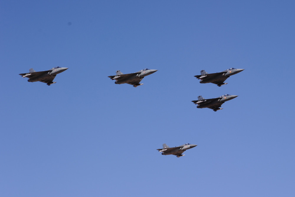

nvishal wrote:
Indranil wrote:
This cannot be correct, can it? We have had 2 TDs, 5 PVs, 7 LSPs, 2 NPs, and 4 SPs already. That's 20 engines already.
I have yet to see 2+ tejas fighters in one room. My guess is that they take it apart completely and use the parts on the upgraded prototype. This also makes economic sense. Wonder why they'd leave a million dollar engine resting on an old prototype at the hanger for years. Simple logic says that they are using it again and again. Although I agree that open source does not track deliveries data.
Well I don't know which room exactly you are talking about. But surely the LCA hangers in IAF hold more than 2 at any time. But even seeing 100 LCAs in a big room, says anything about how many of them have engines inside..? :?:
Up to 5 have been seen flying together, at least once. I have never seen more than 5 flying at a time. But then does that corroborate your data point of 5 engine deliveries..?? :?: But then I have never seen more than 6 Su-30MKI flying at a time. :(( :((
Simple logic is OK, but oversimplification can get you in trouble sometimes. :P
