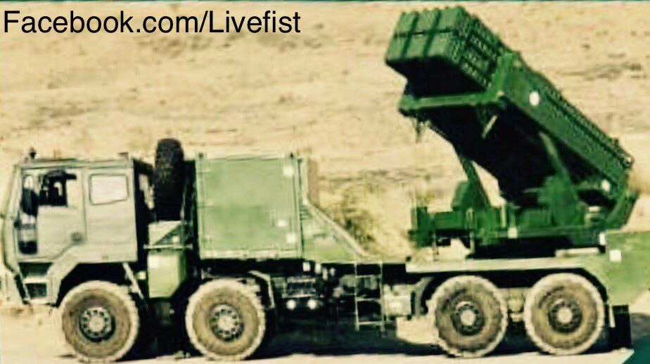

What India's QRSAM launcher platform looks like. - @livefist

We are seeing similar mounted 8x8 layout with a slew-able mechanism between various DRDO systems for the IA.
