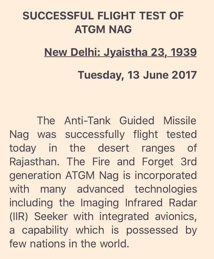

Here's my take on the Nag.
There are battles that armies want to fight and there are battles armies end up fighting.
Consequently, there is equipment armies want to have and there is equipment armies end up having.
Tanks like Leopard 2AZillion with kinetic penetrators have a limitation - they're effective line of sight. While this may work in plains and deserts without too many undulating dunes, they dont work as well elsewhere.
A good comparison would be medieval heavily armoured European knights charging at each others with lances with even the winner sustaining incapacitating injuries. And the Turks and English played asymmetrically by employing massed archers, like Battle of Crecy, Battle of Poitiers and Battle of Agincourt. The knights claimed unfair but war is seldom fair.
The Indian Army realized long back this limitation of tanks, so in current mechanized formations of T-72 & BMP-2, its the Konkurs-M missile armed BMP that does the long range work at 4 km range with T-72s providing short ranged protection at 2 km range.
However, wire guided missiles like Konkurs and TOW and laser guided missiles like Hellfire have a limitation - they're one to one, meaning operator has to continuously focus on target to guide the missile. That makes operator vulnerable, and if outnumbered, then those enemy not targeted can take out the operator.
Hence the requirement for Nag having IIR seeker, that once locked by operator will fly to its target and enable the operator to engage another target.
The requirement is extremely ambitious - other than Spike and Javelin - no other missile has IIR seekers. Not the French, British or Germans.
Most BRF members get dazzled on seeing the hardware, not realizing its the software that makes it work. And software is heavily guarded secret and very difficult to develop.

Nag is 90% there - once the algorithms are improved, then it makes sense to produce another 4 km range more expensive missile that is fire & forget.
Some may argue, why go for complex IIR technology? Why not use same wire guided technology as Konkurs? The answer is all the optimization that could be done with a wire guided missile has already been done for Konkurs.
Please also note that the primary weapon of T-90 is not Line of Sight limited rod penetrators but INVAR Missile for long range non line of sight engagements.

Any info regarding Range and time of testing, temperature of day etc for this recent NAG test..??
Re: Indian Missiles News and Discussions-May 2017
We can assume it would be something close to below statement: around 3.2Km in the middle of the day (hottest 45C+) with the target tank at similar temperature. Last year in May, the temperatures were soaring above 45C in much of Rajasthan (Phalodi sizzled at 51°C).JayS wrote:Any info regarding Range and time of testing, temperature of day etc for this recent NAG test..??
SSridhar wrote:In June 2016, the Director General of DRDO, S. Christopher said that “ if the environment is cool and even if the differential temperature is just two degree, it can identify the target. But if the tank is left for hours in summer (sun), that is what we did during the recent trial, the temperature difference between the tank and the environment is negligible and that is the time we cannot meet the targeted four km range. So we have requested the defence minister that as a first phase the missile's range be slightly reduced, that too only when used in the middle of the day i.e., between 11 a.m. to 3 p.m. So in phase one, we will work on a slightly reduced range [only 3.2 Kms instead of 4 Kms] and in the next phase we will improve the product so as to meet all the targets”.
