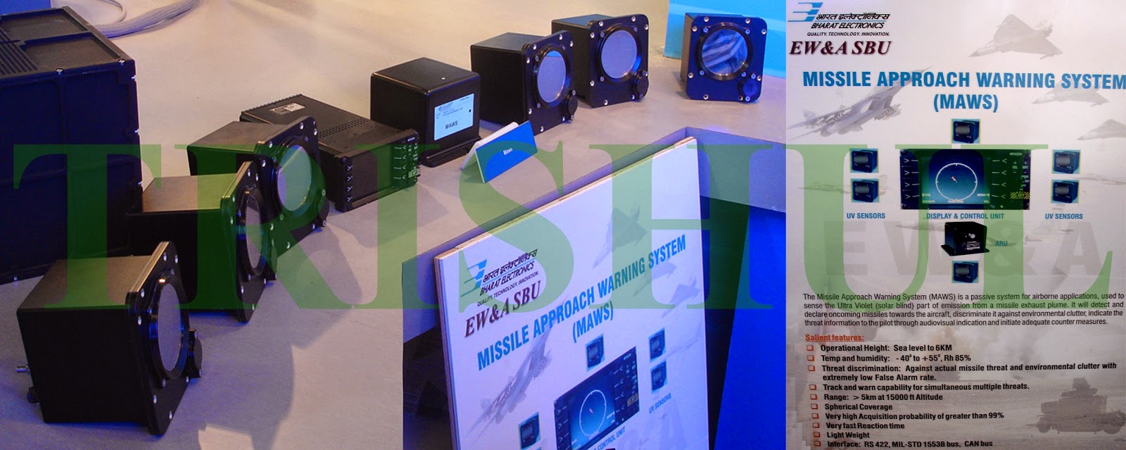

Plz guide me , where is MAWS in the above pics ??
It's not there. Updates are focused on RWJ.

http://trishul-trident.blogspot.in/2013/10/
Here is a troves of info about MAWS and RWR equipements in IAF inventroy
Interestingly our Dhruv WSI/Rudra has MAWS
But till now the so called Su 30 MKI doesnt't have these MAWS system, But they have RWR, The Super MKI upgrade was proposed to get D/C MAWS
Coming to Tejas,
I'm not sure How many UV Receiver they need to mount on the aircraft in order to get 240 degree view, a Typical system comes with 6 pieces, maybe four in the Back and each in wing tip
below pic of Dhruv WSI with MAWS installed,
even few Dhruv MK 3 too have it
well one more, The upgraded MiG 29 UPG stated that it has the most effective internal jamming system, but no word of MAWS

Lets not assume the IAF/DARE didn't just avoid an easy solution. The Avitronics MAWS on Su-30 MKM is behind technologically to the one we plan (ours is dual color) & also even it would have had a definite impact on the flight envelope. The Su-30 MKM also proudly displays the SAP518, and we now know how heavy and difficult to deploy those pods are. In short, they accepted the limitations, we are seeking to minimize them.Cain Marko wrote:IIRC the RMAF flanker does have a swedish MAWS on it.... So how come there is so much difficulty with MKI?
Nailed it in one line. MAWS is definitely a huge requirement for low flying aircraft where distance of flight of missile and reaction time of pilot is very less. For high flying, medium alt aircraft it is good to have, but a sophisticated RWR + SPJ + advanced flares would take first priority IMHO.ramana wrote:I think the MAWs solution to an American problem of low flying aircraft from Stinger type missiles.
I used to read in Av& S W in the mid 90s of technology to detect incoming missile by looking at UV radiation from metal particles in the rocket exhaust. And launch countermeasures aka flares.
The RWR etc. would detect SAMs and AAMs which had radar guidance.
No need to self flagellate.
LCA has BVR and can shoot the incoming planes before any need for MAWS.
And no planes to fly low to be in range of Stinger type missiles.
Don't get me wrong, MAWS is great to provide any pilot cues of incoming attacks especially in a dense threat environment, but for the LCA the above sensors are the primary ones to induct first. A MAWS solution, e.g. pylon based without doing metal cutting of the Aircraft can be explored later.
Yes, correct. The EF even claims to have its defensive detection sensors RWR + MAWS cue both the jammers, flares & also provide automated cues to the pilot for the best escape geometry. Of course, looks good on paper, but then if 4-5 missiles come from different directions, I wonder how fancy that processing really is.kvraghav wrote:The MAWS and flares mostly go hand in hand. Without the MAWS, the pilot has to rely on wingman or himself to detect a IR missile to deploy flares. The fighters now a days avoid low level flights in hot zones and they can pull up easily and faster to out run an IR missile. The helicopter is a relatively easy target since it is slower and flies at lesser altitudes. Hence MAWS with flares is a bigger priority for helicopters.
