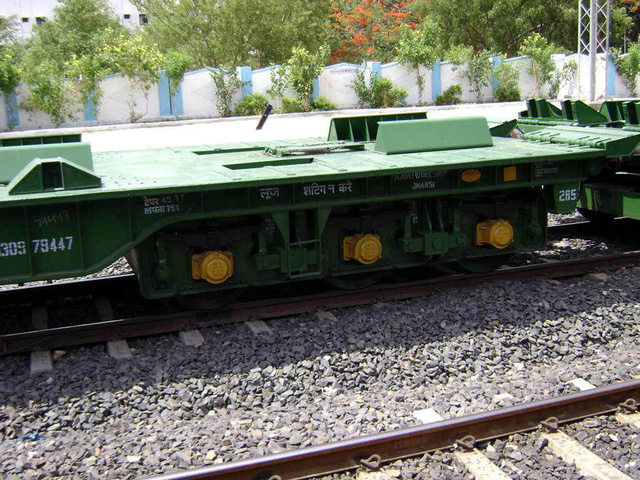

Mihir, let me not call the width a bogus issue but please look up buffer height adjustment and let us know if the issue persists. If possible, please also look up rolling stock heights for Indian railways. The turret hitting signal posts is impossible to my understanding. I shall post these links tomorrow.
Regarding the weight, what different logistical issues are expected between a 50-56ton unit and a 60-65ton unit? I just don't get it. For an army that moves literally thousands of tons each day, why would these additional 10 tons per unit be a pain?
Finally, I'm sure you know there is a specific carriage that enables Arjun or any other future Heavy MBT to be carried. There is no report of any interference or collisions with existing infrastructure. Earlier issues were with poles that were incorrectly positioned, with lesser clearances. These arguments are still quite flimsy.

Just a few points:
Overhang: Going by the width of the BFAT (355cm), the Arjun must hang over the sides about 6 inches on both sides. However, in the following video, it does not appear to overhang.
Load: Note the capacity specified on the bogie itself is 75 Tons! Some rail bogies can be loaded up to 100t inc tolerances. BFAT bogies were developed specifically for MBTs including Arjun (in use since 2006/7?). If IR is using any such freight wagons on any route, that route can also haul Arjuns. I won't substantiate this because anyone is free to go check on IRFCA or refer RDSO reports.
BEML spec sheet for the BFAT
Here is the BFAT for your viewing pleasure:
Check the overhang and the Turrets here:
The best way to verify tolerances and issues related to signal posts etc. would be from an RDSO report. vsunder sir or sachin sir can perhaps help because I am unable to find one online.
Mihir, your points are fair enough and I am not informed enough to place an effective counter to several of the old hearsay accusations that we have been reading over the years. However, the plain questions would be:
