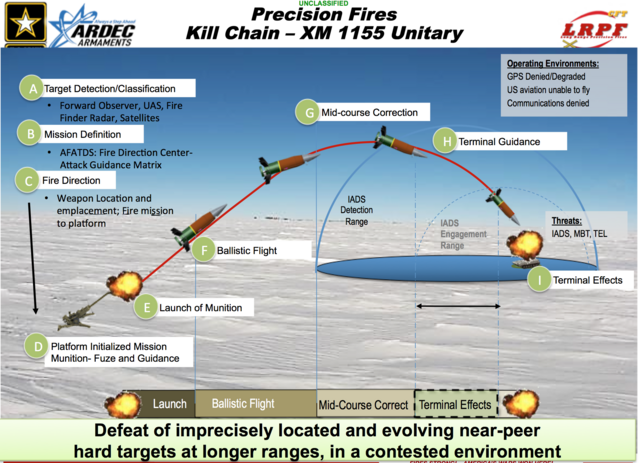

Re: Artillery: News & Discussion
58 caliber M109. 62 km range!
Always wondered why we did not go 55 caliber on ATAGS.
^ They have achieved their desired accuracy out to 40 miles but testing and demonstrations are ongoing and the goal is to reach 45 miles with the current ammo and 80 miles with a new round (by 2023). The ER rocket is wrapping up testing with a Max range of 139 km with the tail controlled section and then they begin working on a new motor to get it to 150+ km.
abhik
Posts: 3090
Joined: 02 Feb 2009 17:42
Post by abhik »
brar_w wrote:^ They have achieved their desired accuracy out to 40 miles but testing and demonstrations are ongoing and the goal is to reach 45 miles with the current ammo and 80 miles with a new round (by 2023). The ER rocket is wrapping up testing with a Max range of 139 km with the tail controlled section and then they begin working on a new motor to get it to 150+ km.
Did they get the huge range increase (from 70 to 139) just by moving the control surfaces to the tail - seems incredible? Which means Pinaka rocket can also evolve to reach this range, given the similarity size of the two rockets.

abhik wrote: Did they get the huge range increase (from 70 to 139) just by moving the control surfaces to the tail - seems incredible? Which means Pinaka rocket can also evolve to reach this range, given the similarity size of the two rockets.
Yes that is how they got it. Modified the rocket motor and moved the control surfaces to the rear. A second modification to the rocket motor is planned for the 2020s which will look to increase range by about another 20%.
On the cannon system the range increase is done by both the new barrel and the rounds. Going forward, the 70 km to 130 km boost will be gotten via either solid fueled ramjet, or by employing a HVP round, the latter has already been fired from the M777 but for an air-defense role. Beyond that (150-200 km) you almost have to go to an EMRG type set up.
how can just moving a control surface increase range?
bigger surfaces to generate more lift and some airflow smoothing and drag reduction measures ?

The second half of the video is actually showing updated MLRS rocket not the 155mm rocket assisted artillery shell.
Singha wrote:how can just moving a control surface increase range?
https://www.amrdec.army.mil/amrdec/pdf/ ... _19_17.pdf
The PDF and video showcase what AMRDEC has been able to do with the TC section in the rear and through modifications to the existing motor. They are just about done with their demonstration and validation of these changes. This will then transition to the OEM (Lockheed). Lockheed has a few things that it has been working on itself such as a slightly larger diameter motor (without impacting magazine size) which when combined with the AMRDEC validated TC will give them the 150 km maximum range.
By freeing up the front section of control surfaces they are likely opening themselves up to adding new guidance for future variants. There are some interesting programs that are aiming at fairly low costs when it comes to SAL and other targeting options and a future GMLRS variant could be a target for that tech insertion.
From Jane's (dated October 11, 2018):
Lockheed Martin plans in mid-2019 to conduct the first engineering development flights of its extended-range Guided Multiple Launch Rocket System (ER GMLRS), a company spokesperson told reporters on 10 October at the Association of the United States Army’s (AUSA's) annual conference.
ER GMLRS’ qualification flights are expected in 2020 and production could start in 2021, the spokesperson said.
The extended-range variant increased the motor size (with an increased diameter for more propellant volume), has a 15 km minimum range, 150 km max range, and a redesigned tail for manoeuvrability, the spokesperson said. The legacy GMLRS reaches out to 70 km.
Lockheed Martin officials declined to say how much ER GMRLS will grow in diameter, but said it will be slightly larger than the legacy 227 mm GMLRS, although still fit six per pod.
The ER GMLRS and GMLRS can be launched from the wheeled M142 High Mobility Artillery Rocket System (HIMARS) or tracked M270A1 Multiple Launch Rocket System.
Both can use the same unitary warhead or the new M30A1 GMLRS Alternative Warhead (AW) that is replacing the Dual-Purpose Improved Conventional Munitions (DPICM). The spokesperson said Lockheed Martin is “leaving room towards the front for enhancements”, such as adding sensors and more lethal warheads.
An initial operational capability for ER GMLRS could be achieved around 2021 timeframe, the spokesperson said.
ArjunPandit wrote: are you aware if some of these things are also being tried in swades? Even the ATAGS itself was sort of record breaker. Next steps after the delivery of ATAGSs, K9, etc.
I am not sure what is happening on those systems. On the two US systems ( Palladin and the M777) they are going with a multi-pronged approach the elements of that together get the range out to 70 kms with the current (in development) capability and then eventually out to 130+ km with a new round they will begin R&D on by next year (either Ramjet powered (Boeing and Nammo have showcased their proposals) or an HVP round).
Broadly, the elements are :
1) Cannon upgrade - New 58 cal tube on the M109, and a new 55 cal tube on the M777A2. Both will also feature a re-designed chamber and breach to withstand the higher pressures.
2) Upgrade to the Round - New higher impulse Extended Range RAP round (XM1113) that can withstand the higher pressures and provide the extended range. Besides the XM1113 I believe only the Excalibur can, without modifications, achieve 60+ km ranges with the ERCA tube upgrades without requiring round modifications.
3) Develop new longer ranged rounds - Either explore SFRJ or work around the existing HVP rounds designed for the EMRG and already tried on the M777.
The new XM1113 round itself would get you 40 km range with the 39 caliber tube on the M109, but it is the combination of the longer tube (58 cal), redesigned breach and chamber and the XM1113 that has gotten them to demonstrate the 60+ km range as of now, and they intend on demonstrating 70 km range over the next few months at Yuma. Current plan is to complete the ERCA demonstration program by this time next year, and then seek authorization to begin production. They expect to field the first units with the modified M109's and M777's in about 2 years from receiving authorization so mid 2021 to mid 2022 time-frame.
Beyond this and into the medium term (2022-2025 time-frame) they want to work on the XM1155 Extended Range round and look to insert terminal guidance and targeting (looking at dual-mode RF/IR seekers) for anti IADS roles in areas where GPS may be denied. The SFRJ or the HVP may be the technologies of interest in this space as the range requirements are 130 km or beyond from ERCA guns.
