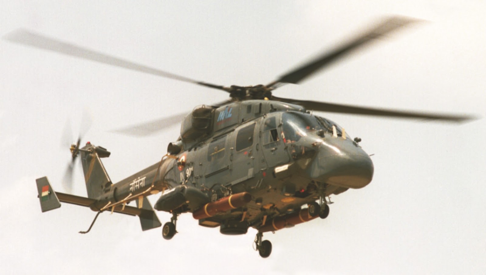

The fundamental Q one needs to ask for the dunking sonar role is:
Can the helicopter’s engines provide the power required at a maximum of cruise or max continuous power (which is a non-time rated power level), with the helicopter kitted out in the required sonar configuration and with fuel required for the specified time on station?
If this answer is yes, then the design of the helicopter is in the reckoning.
Then comes other equally important aspects, such as control and handling (including crosswinds), avionics including autopilot for automated transition to hover, auto-hover, etc for night op, ship borne footprint and other related requirements, blah, blah….
The ALH Mk-III already fits the above bill.
If the designer now changes the MGB to accept more power from the de-rated engines, then there is an attendant weight increase, increase / change in tail rotor transmission and tail rotor, more fuel required for higher power from engines and so on. Also we need to keep in mind that beyond an optimal point, even if we pump in more power to the main rotor, its thrust peaks off and then we need to increase the rotor diameter or add another blade…
And we end up with a different animal altogether!

-If I may repeat my earlier statement:
Emphasis added to highlight that the design will be tailored to cater to the user specified requirements and user defined missions. That's the design's raison d'être!
If the answer to the question above is yes, then the design of the helicopter is in the reckoning. If that same helicopter can also take benefit of high installed power and light-weight transmission at high altitude, then its all the better.
If it cannot, then the design needs change.
That is the bottom-line!
Designs are made to be role / mission specific for military and market requirements specific for the civil. Take the hypothetical example you made of maximising sea level performance. Say we design it for the civil and if you keep increasing the size / payload just with an intent to max the performance at sea level, then will the market support the increased seat / cargo capacity with attendant increased costs in both capital and operational ? Again, what exactly do we mean by 'max' performance at sea level.? Performance at hover (lifting max payload) requires a different set of design parameters as compared to maximising cruise speed. So which is more important? What should the design cater to? The answer : the specific market segment which is targetted will have its own peculiar flight profile and our design will need to cater to that specific requirement. If say, quick transit time is a priority to reach far-flung oil rigs, then a high cruise speed is a primary design requirement.

Make in India: HAL offers Indian solution to Indian Navy’s requirement for Advanced Light Helicopter ‘Dhruv’-Huma Siddiqui
The Rs 21,738 crore deal for 111 Naval Utility Helicopter (NUH) proposed to be `Made in India’ could tip in favour of state-owned Hindustan Aeronautics Limited’s (HAL). A top officer told Financial Express Online “The Company’s NUH is an Advanced Light Helicopter `Dhruv’ with customisation designed to meet all the operational requirements of India.”
Adding, “The flying machine can be fitted with torpedoes, Depth Charges & Missiles, Self Protection System (SPS) & Flight Crew Data (FCD). Besides having Software-defined radio (SDR), Data Link & SATCOM, these helicopters will have the main rotor blade folding and tail boom folding to enable stowage in Navy’s ship hangars.”
Earlier this year at the Aero India 2019, HAL had demonstrated the Tail Boom folding and Main Rotor folding of the Naval Utility Helicopter.

The 'Duck-nose' ALH. One of the strangest looking helicopters around. Written off, but keeps coming back every now and then to haunt the Indian Navy :) .
