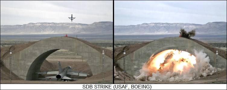

srai wrote:<SDB imagery>
This is what happened in Balakot with those SPICE 2000s
