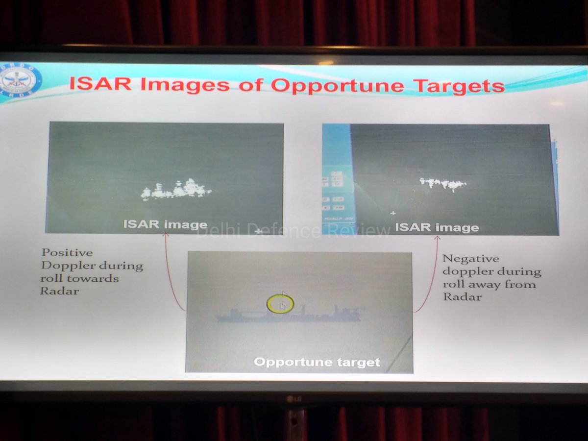

Regarding the slide on the ISAR image, it clearly mentions "opportune target" and is a large cargo ship with large cranes, all of which are good metallic reflectors.
https://kaiser-aeronaut.blogspot.com/20 ... 1-war.html
On the night of 8/9 December, at around 2245 hrs, lookouts at Manora suddenly picked up the infamous glow hurtling towards them, then crossing overhead and slamming into the nearby oil tank farms at Keamari.[8] A tremendous fire engulfed the terminal and the whole harbour lit up, visible from miles. Distressingly, fires lit by an earlier air attack on the morning of 4 December had been laboriously put out just a day earlier.
A few minutes after the first attack, another missile hit the anchored British-owned merchant ship Harmatton, causing it to sink in no time. This was immediately followed by a third missile which hit the SS Gulf Star, also anchored, flying the Panamanian flag. It survived the attack with serious damage.[9]
A fourth missile hit PNS Dacca, the Navy’s supply ship which was idling in the harbour for maintenance, having been out at sea for 25 days at a stretch.
The radars on P-15 missiles of 60's vintage fired in 1971 war could discriminate metal oil tanks at Karachi due to their relatively high reflectivity and hit them. So while the P-15 missile radars successfully hit metallic ground objects, we do not classify them as A2G capable radars.
After the first missile attack, the Pakistanis dispersed their fleet among civilian merchant ships. As a consequence civilian ships with larger radar reflectivity like Harmattan, Gulf Star, and the fleet tanker Dacca, were hit. Tankers are similarly large as civilian merchant ships.
Warships are much smaller with most having various degree of reducing returns. Hence the capability showcased is indicative rather than "a near weapons grade accurate track"

tsarkar wrote: Lastly, these slides also indicate the root cause of the IAF vs DRDO divide in the past.
What the services need is -
a near weapons grade accurate track within 15 seconds
While what DRDO gives is -
Moving Targets detected along Bangalore-Hosur highway Range Coverage 10 - 22 km
That is also the chasm between a certified FOC product and an experimental product. Hopefully that is now a thing of the past.

Second:
Opportune target merely means they were lucky they found something to test against, not a preplanned one.
The average naval ship is also a fairly good reflector. Similar performance was achieved against them as well. This is an ISAR image and specific for naval targets where the periodicity of returns vs wave motion allows for the technique to be used. Land targets have the radar utilize SAR/MTI.

Karan M wrote:This is a complete misreading of what the radar is supposed to do and deliver. The AEW&CS is *not* supposed to provide weapons quality tracks in the Wide Area GMTI mode of all things.
Fact of the matter is the radar is completely unsuitable to do ground mapping. And the earlier evidence provided by Prasad and you was misleading.
Karan M wrote:That it does is merely an indication of the maturity it has achieved and the capability available now within India that we are able to squeeze so much information out of a S band radar which is why they flag it.
It was just a lab test result that cannot be deployed operationally. While its a good lab achievement, to present it in an international air show is naivety.
That specific slide is similar to recent reports of gold being discovered in UP. As the Geological Survey of India clarified, there are trace gold deposits in that area that are not economically viable to mine
No, fact of the matter is that you mixed up the mode in which the radar was operating in and stated that the IAF wanted "weapons quality tracks" from a surveillance radar and it doesn't have any A2G modes when the image clearly shows that the radar does operate in an A2G surveillance mode as a testbed, and its Wide Area GMTI which is not meant to provide a weapons quality track at all, but is a wide area surveillance mode.
You are still mixing up modes. " The primary radar in the AWE&C exhibits capability to detect and generate a near weapons grade accurate track within 15 seconds." This refers to air to air modes - its called high performance tracking in the air to air mode! See below.
How can you even apply that to a wide area surveillance mode in air to ground? In fact its something you have extrapolated from your incorrect understanding of how the system is meant to perform.
The evidence provided by Prasad was also spot on. He demonstrated the AEW&CS is indeed being used as a developmental test bed to develop A2G modes and has developed the GMTI mode & demonstrated an A2S mode, i.e. ISAR.
What you have done though is mix up these modes and associate them with a fire control function "weapons quality tracks" which a surveillance radar, is fundamentally not meant for, irrespective of the band it operates in. The AEW&CS as it stands achieves something close to that in A2A, which the developers are proud of, but they never claimed it was going to do that in A2G. The IAF never asked for it either.
If the AEW&CS was designed as a MFR with a fire control function, then irrespective of the band, they would have worked on several optimizations including aperture size, beam-width and other functions to achieve that aim, depending on the weapon the radar was meant to guide and if its seeker was able to acquire targets in the required scan area!
This is again wrong, as its very clear, its not a "lab test result" but one from an actual flying test-bed with targets clearly detected and parsed as the display shows, same as that done on the J-STARs.
This comment is too pointless for me to even rebut.
Fact is the radar mode above exists, has been demonstrated as LRDE demonstrated and is being fine-tuned for operational deployment on multiple platforms.
No amount of confusion on this aspect can dismiss it away. A GMTI mode exists. It works, and can be ported and developed further on other platforms irrespective of claims it is not some mode it was never meant to be anyhow.
