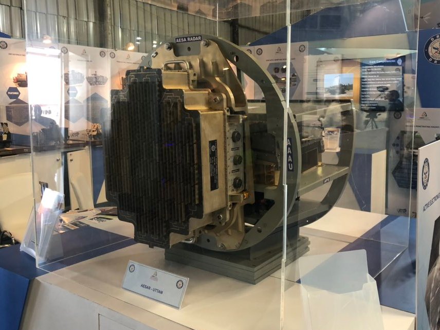

coverage will be limited to+/-60 deg in AZ because of fixed antenna array, Gimbaled antenna array will increase scan coverage as is in BARS.
Re: Radar - Specs & Discussions
Is there a one for LCA Mk1/1A Uttam AESA TRM count?

Latest on the Uttam radar and other very interesting developments on the radar front -
Posts: 10424
Thanks Prasad.
It appears LDRE has done some really good work. Time to throw some big bucks at LDRE to move design and testing up so serial production of the UTTAM and other radars can be brought into serial production.
At 1:46 the indication of implementing SAR has been successful.
At 2:05 the indication is that issues with ground clutter have been resolved. This is a big accomplishment by LDRE.
At 2:12 the indication of proving ISAR is underway. If I were a betting man, I would compare ISAR data from the P-8I of the same targets to validate.
At 2:41 the chart shows two receive antennas and two transmit antennas for EW which are integrated into UTTAM. This is a very good development.
At 3:12 the intention is shown to integrate the EW suite, RWR and UTTAM together.
At 3:25 the block diagram is gives a nice overview.
At 4:05 I really wish they didn't provide such detail.
At 4:38 it is very interesting that the BARS radar in the Su-30MKI would be replaced with a scaled UTTAM that has twice the performance of the BARS, but no time line was given. At this rate, the deeply integrated UTTAM system on the Tejas would outperform the Su-30MKI.
