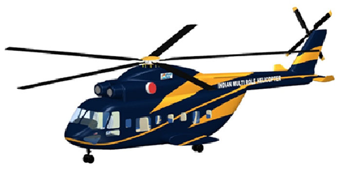

All the current ALH subvariants have a similar intake and exhaust layout. But the IMRH seems to have a very different intake/exhaust layout. Is it because the designers are making a provision for the same engines as the MI-17 (in case our current engines fall short) or is it because such a layout is more preferable for such a heavier class of helicopters?

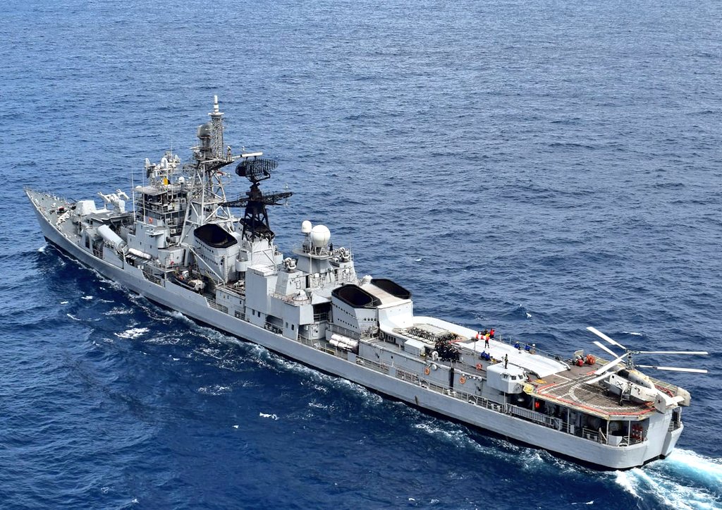

Are there any technical benefits of the co-axial rotor system?
Some reports I read mentioned co-axial rotors offered better stability in updraft, downdraft, wind shear conditions in the mountains. I am not sure of the accuracy of those reports since they did not further elaborate.
Russian ships, including those in IN service, operating co-axial helicopters do not require helicopter hauldown and recovery systems for bad weather, the reason supposedly being the stability offered by the co-axial rotors.
https://pbs.twimg.com/media/EhJyq07VgAA ... ame=medium
https://pbs.twimg.com/media/EhJyqltVgAE ... ame=medium
Would love to understand from you the pros and cons of co-axial vs tail rotor system.

sajaym wrote:All the current ALH subvariants have a similar intake and exhaust layout. But the IMRH seems to have a very different intake/exhaust layout. Is it because the designers are making a provision for the same engines as the MI-17 (in case our current engines fall short) or is it because such a layout is more preferable for such a heavier class of helicopters?
Look at the CH-53 and H225M, very similar engine layout to the IMRH, I guess it’s because of the larger size of the helo ve the engine size

tsarkar wrote:Are there any technical benefits of the co-axial rotor system?
Deejay can also weigh in on this.
... pros and cons of co-axial vs tail rotor system.
The coaxial system gets rid of the tail rotor and the additional power it absorbs - up to 15% in hover. So for a navy 'helo' that spends a substantial amount of time in hover and dunking its sonar sensor - that translates into better hover performance or better fuel consumption. Ditto for tasks requiring external undersling loads.
The coaxial in its pure form may give better handling in some aspects. But then, current gen conventional helicopters have stabilisation equipment that overcome any handling deficiencies. Even the Kamovs have stabilisation equipment.
Recovery on ships - the Kamovs have a quadricycle undercarriage to help with stability on rolling ships. Anti-skid nets are used on decks to assist landing. However, a Recovery Assist system is a more effective method for landing in rough seas.
Some disadvantages of coaxials are- complexity and restrictions in agility.
The two rotors can come close and even intersect in the event the pilot exceeds laid down restrictions in manoeuvres. So,the coaxial Ka-50/52 attack helicopter have restrictions, even though the individual rotors are 'stiff' with fairly high flapping hinge-offset.
