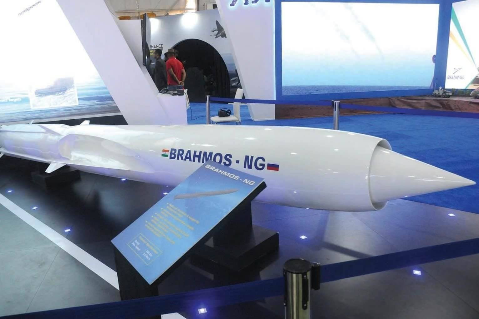

https://twitter.com/DefenceDecode/statu ... 23297?s=20 ---> The new generation of the BrahMos cruise missile (BrahMos-NG) will be produced at a plant near Lucknow, Uttar Pradesh under the UP DIC: RM Rajnath Singh. The BrahMos-NG cruise missile is planned to complete its trials in 2023.
