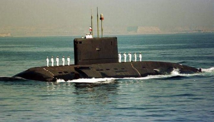

https://twitter.com/DrPVVenkitakri1/sta ... LlU9iud8gw ---> DRDO will get a KILO class submarine from Indian Navy to test Electric Propulsion motor, Li-ion battery, AIP and other Technologies. This will be used as a research vessel for the development of next-generation systems and components for the development of 12 indigenous submarine.
https://twitter.com/8r02s125558/status/ ... LlU9iud8gw ---> DRDO will get a Kilo Class submarine from Indian Navy to test Electric Propulsion motor, Li-ion battery, AIP and other technologies.
https://twitter.com/8r02s125558/status/ ... LlU9iud8gw ---> This sub will be used as a research vessel for the development of next-generation systems and components for the development of 12 indigenous submarine. These submarines will go into to manufacturing from 2030.
