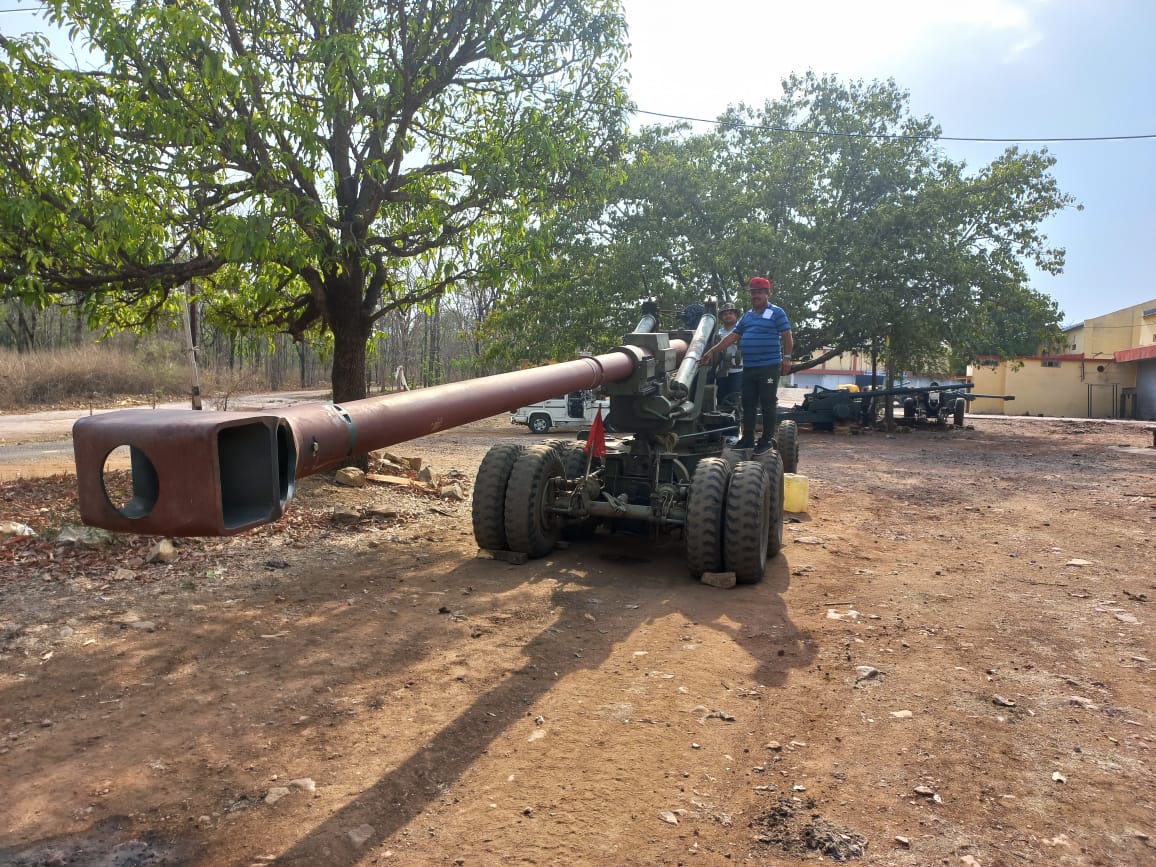

FGK succesfully proof fired 155x52 cal ordnance today at CPE Itarsi, proving its capabilities to manufacture 52 calibre artillery fire power.
The carriage looks like one of the American 155 mm gun carriage from WW2 days.
Why not use a purpose built carriage from day one.

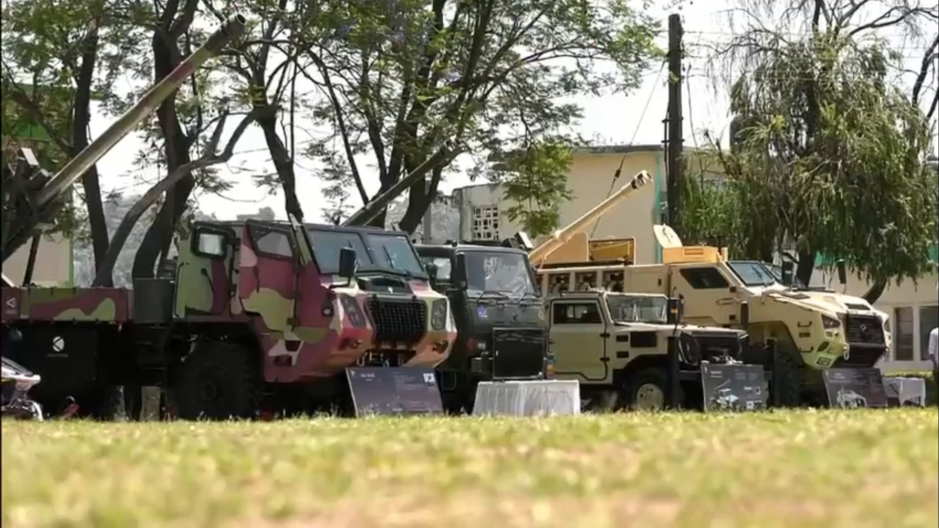

#NorthTechSymposium2022
Bharat Forge equipment displayed, from left:
TC-20 155mm/39 gun system
@Tej_Intel
Garuda-105
Garuda-105 V2 (both are 105mm/37)
M4
It seems Kalyani is offering both the versions of its 105mm MGS to the Army
1 TATA LPTA 716 4×4 based gross wt ~7.5 ton
2 Kalyani LSV based gross wt ~5.5 ton
