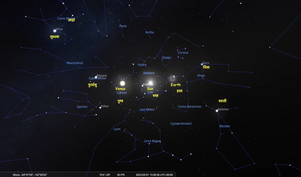

Especially for the audience who is familiar with night sky ....
As I post this message, Looking from the vantage point of Vikram:
Here is what stars look like, at the time I am posting this.. Enjoy...
Those who are familiar with star names in Hindi, or naxtra's .. I am naming them too (in Hindi)
You can see Venus, Sun, Earth ... since sun is quite bright, the other stars may not be visible .. (unless you block the sun )..
Enjoy!
( - By Amber G - - (I have put labels - using familiar naxtras etc - the are labeled by hand - it is near the naxtra -- I have used hindi star names for especially bright stars -- or brightest star in the naxtra -- )

Why is Venus so bright?. It's almost as bright as the Sun.

I was playing with the brightness ( theoretical value) so that I can print it out .. -- sun is much much brighter (with that in the sky all other stars will fade..).. The brightness you see for sun is is not sun but a magha naxtra's brightest's star (Regulus).... Sun is very close to that star when the positions were printed out. .. Remember it is "day" there, normally you don't see stars in the day, unless you block the sun very nicely.
(If you are curious, Sun there is about 600 billion times brighter than that bright Venus -- which itself is quite bright)

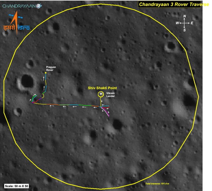

https://twitter.com/isro/status/1697881823391711684
Chandrayaan-3 Mission:
Pragyan 100*
Meanwhile, over the Moon, Pragan Rover has traversed over 100 meters and continuing.

Negotiating craters... U Turn from the edge of the crater ..... Walking on the edge of the crater......
Pragyan must have been trained on Indian .no-roads'.

India should name the circle as Pragyan circle whose center is ShivShakti point.

Something seems off in that image. If the scale is 50m X 50m, and if that represents the entire rectangle (square), then the distance traveled, as shown, seems to be about the width of the image - should be around 50m. Unless the rover retraced that entire path back?

Vikram soft-landed again! https://twitter.com/isro/status/1698570 ... 5l6mg&s=19
Did we know this was planned? Wow! What a nice surprise. :D :D :D

Yes a surprise indeed !!! now if both wakeup and if pragyaan can drive in, it can theoretically take off and go to another place, SS-2 :)

Its indeed a welcome surprise.
Was able to lift up by 40 cm.
Will give useful insight for thrust required for sample return missions.
Also maybe the heat of the engines can be used to warm the interior a bit for the 14 day lunar night.

Anyway here are post hop and pre hop pictures:
