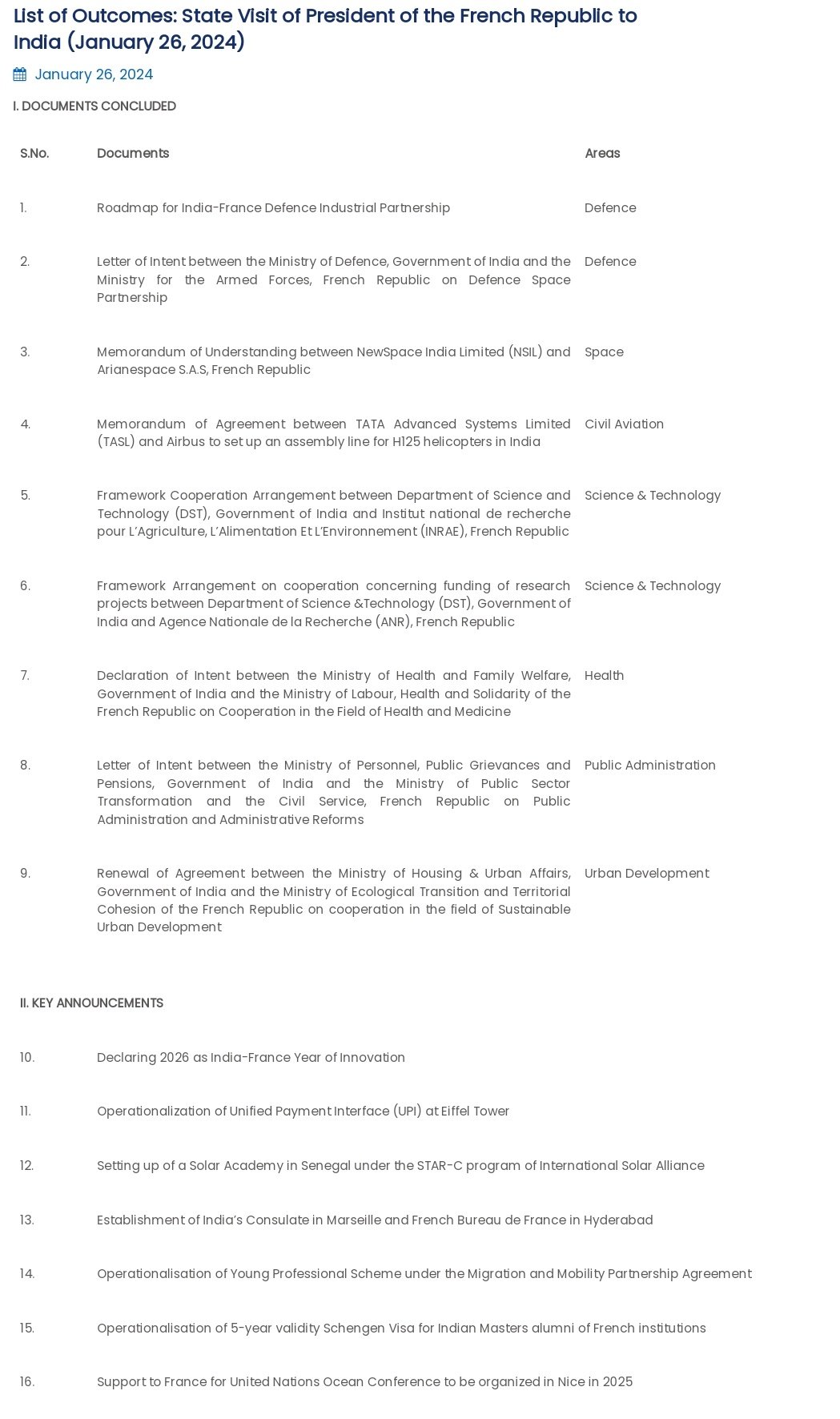

https://x.com/alpha_defense/status/1750 ... 98762?s=20 ---> Press Release (Defence):
- Roadmap for India-France Defence Industrial Partnership (Engine).
- Letter of Intent on Defence Space Partnership.
