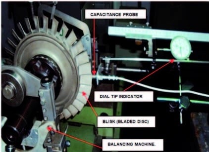

GTRE using Italian Firm Parpas CNC Blisk machining tools for Bladed Disk( Blisk).
In pic an old image of GTRE BLISK Rotor at testing facility.
https://pbs.twimg.com/media/GFd-m4iagAA ... name=small

https://x.com/Defencematrix1/status/175 ... 91354?s=20 ---> Update on Gas Turbine Technology Development: DRDO's GTRE has issued tenders regarding the supply of 'Advanced Afterburner Components' made from advanced metal alloys (Haynes 188).
Representative picture of Kaveri Afterburner Nozzle.
