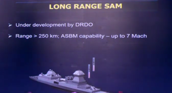

Posts: 20967
Re: Indian Missiles News & Discussions - 30 June 2022
Bingo!
Posts: 20967
https://x.com/Archit_Ch/status/1823778666792288536 ---> Wow! So looks like the upcoming missile from the PG-LRSAM programme will have a range >250km (at least, for the naval variant). And interception capability at Mach 7 should be sufficient for short range ballistic missiles at least.
Source (timestamped URL):https://youtu.be/nK8D8sLeIjI?t=1810
