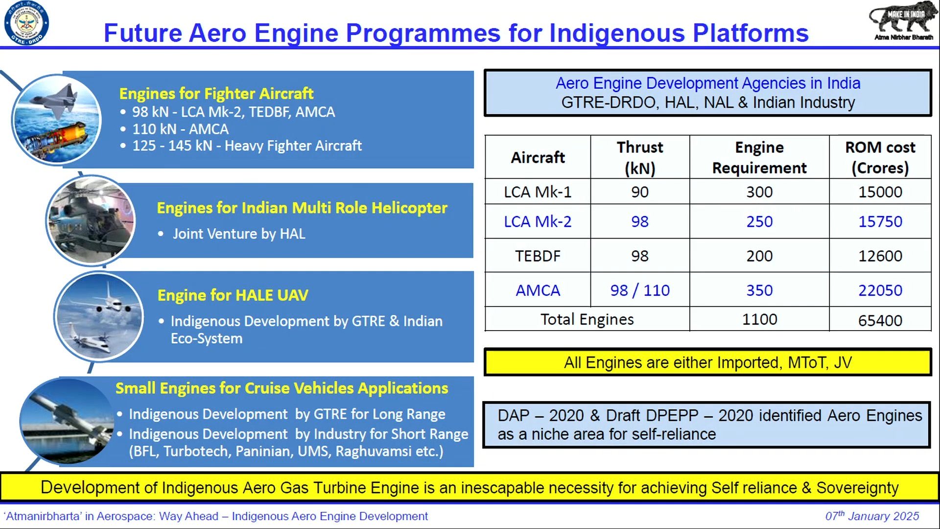

https://x.com/ShiroBarks/status/1897674097250721845 ---> By 2030, we’ll be spending $170 billion on importing airliners with no return on that investment. The cost to manufacture an engine is no more than $10 billion, & adding another $10 billion for the airliner itself would still make it a highly profitable investment.

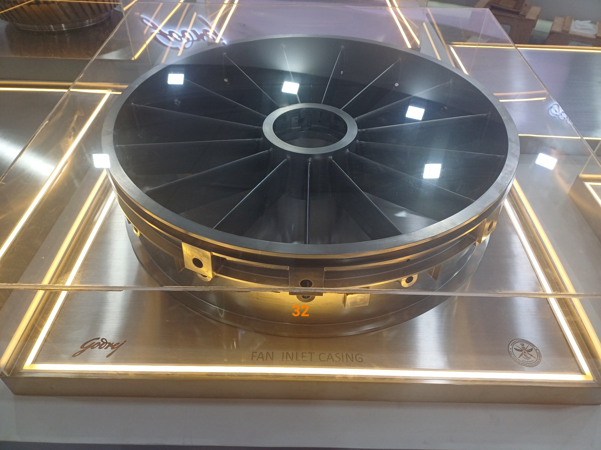

https://x.com/shreedharsingh9/status/18 ... 0914831746 ---> New fan for Kaveri and its specifications.
https://x.com/shreedharsingh9/status/18 ... 3139820687 ---> Fan Inlet Casing of GTRE Kaveri by Godrej.

Rakesh wrote: 12 Mar 2025 21:31 https://x.com/shreedharsingh9/status/18 ... 0914831746 ---> New fan for Kaveri and its specifications.
Small correction, pls note this is NOT for K9 or KDE ... the specifications (both inlet-mass-flow and Fan PR) are for a 5-gen TF with a much larger inlet geometry (may be for AMCA).
Pls refer to this old post from Indranil for context.

Posts: 60381
Very informative thread on X about Kaveri story so far.
https://x.com/ShiroBarks/status/1899837 ... bwhsw&s=19

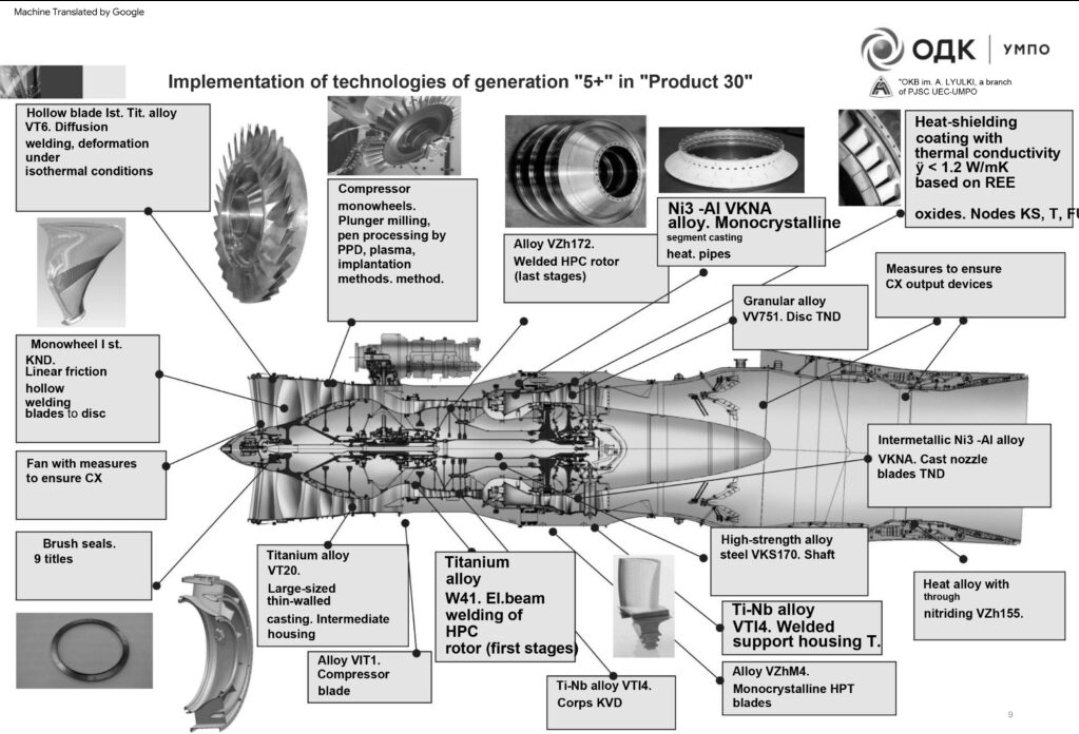

A word of caution: The veritable alphabet-soup that Russian modern TF designations are, it's easy to get confused what is actually being offered etc.
First of all there's no such thing as AL-41 etc anymore - however what is there is:
AL-41F (Izdeliya 20) - The variable cycle attempt from the 90s - which has since been abandoned.
AL-41-F1 (Izdeliya 117) - Heavily upgraded version of AL-31, currently used in Su-57 - no relation/lineage to the AL-41F
AL-41-F1S (Izdeliya 117S) - Slightly simpler version of AL-41F1
And then there's the big daddy, Izdelya-30/AL-51, which is a true-blue 5th Gen TF.
I think we have made it quite clear, on multiple occasions before, that AL-41-F1 etc, doesn't suit us.
We are rather better off, by getting a blanket permission to "improve" AL-31FP, indigenously, part-by-part (especially the Core) - which can result in an, say, AL-31FP-MKI.
This permission is not so much towards asking for better materials or better casting/forging/welding/coating tech etc, but more towards prevention of invalidating the OEM warranty for the rest of the TF, when such replacements are being made by us. Sufficient indigenous TF D&D capability already exists with us, to achieve something like this.
But, that's precisely why it has put by the Russians in the first place - so that our dependency on the OEM remains as it is - notwithstanding all those shameless tall claims about "100%-production-from-raw-materials" etc. :evil:
So as far as Russians are concerned, the only TF that can sufficiently interest us is the 5th Gen Izdeliya-30, which of course Russians would naturally be unwilling to part - I mean will Unkil part any of F135 tech with us - nobody does, so Russians are no exceptions.
A tubelight moment: Now that true-blue-5th-Gen Izdeliya-30/AL-51 is a no-go for us, how about funding Russia, in the so-called joint-D&D (cum-full-IP-sharing - yeah right!!) mode, like that is being touted with Safran/Rolls-Royce, for completing the D&D for a variant (lower dimensional footprint) of the "original" variable-bypass AL-41F (now abandoned) program.
*Note - Original AL-41F was a monster, being designed to provide Supercruise capability to the (now scrapped) project 1.44.

Chetakji, 400% agree wrt taking all possible help and co-development etc that's available from anywhere - even ToT, howsoever fraudulent that concept maybe, has it's own value wrt acquiring/building TF mass-manufacturing technology capability.
I think I've said these points, for many many times now, but a little some more wouldn't really hurt I guess:
1) TF D&D tech capability <> TF mass-Mfg capability. One doesn't automatically lead to other, similarly just mastering one doesn't automatically make one atmanirbhar wrt TF tech.
2) The bigger issue is wrt TF mass-Mfg capability, as it involves developing TF mfg Industrial Ecosystem, which takes time and more importantly, volume. Piecemeal order is a sure-shot mode of killing this capability, and in some cases, actually reversing it.
3) Now, thanks to the Kaveri program we have developed sufficient capability wrt 4th Gen TF D&D.
But that also doesn't mean we have developed a strong enough 4+ Gen TF technological base (similar, but not upto the same-level, of what Safran and Rolls-Royce possess), to be able to graduate to 5th Gen TF D&D independently.
In fact, we should have developed that tech base by now, had Kaveri program was not unceremoniously dumped 1+ decade back.
The KDE program is that proverbial drip-feed that has ensured we don't lose that hard-earned 4th Gen TF D&D capability altogether - but, to expect that to also develop 4+ Gen TF Tech base, so that 5th Gen TF D&D can be taken up with some confidence, is a bit too much.
4) But since Kaveri was never mass-produced, 4th Gen TF mass-Mfg capability was never acquired.
However, we are somewhat of an unique country, as via Lic Mfg of AL-31FP, RD-33MK, Shakti, earlier Adour (3rd Gen) etc, we do have a decent TF mass-Mfg capability as well (may be concentrated with the PSUs, but still it is there).
On the other hand, our Private enterprises (and quite a few MSMEs) have broken into TF mfg ecosystem via being part of global supply-chains of various global OEMs civilian (and maybe some military) TF programs. To be fair they have had some capability historically as well, via the Industrial Turbine manufacturing capabilities for quite some time.
That is the reason why we can suddenly order to a Godrej to manufacture KDE prototypes, and there are other industries (PTC etc) who can confidently manufacture the Turbine components for various GTRE programs etc.
The other day, in one of the interviews, saw Baba Kalyani almost dismissing any challenge wrt manufacturing the cold sections of any TF - whilst admitting, there's steep challenge wrt mastering mass-mfg capability of the hot-section components.
Similarly our small TF (and Turbojet) programs are going great guns , with these very same MSMEs.

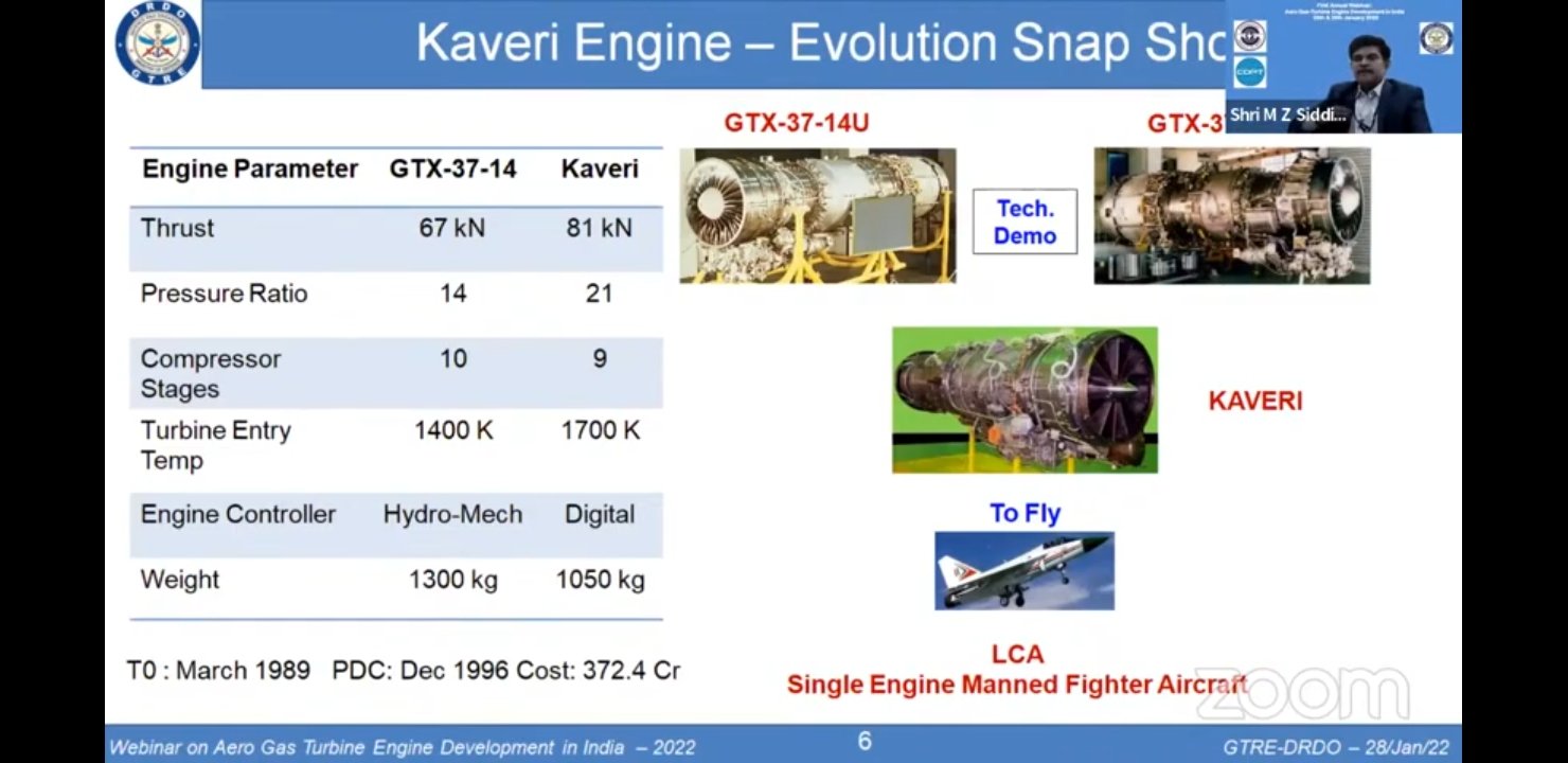

Specification Value Specification Value
Power Plant For TEJAS (LCA) Engine Type Twin Spool, Low Bypass
Air Mass Flow 78 kg/sec Bypass Ratio 0.16 - 0.18
Overall Pressure Ratio 21.5 TET (Turbine Entry Temp.) 1487 - 1700 K
Max Thrust (Dry) 52 kN Max Thrust (Afterburner) 81 kN
SFC (Dry) 0.78 kg/hr/kg Max SFC with Afterburner 2.03 kg/hr/kg
Thrust-to-Weight Ratio 7.8
Kaveri also has a shortfall of around 12%, and it has produced 70-75 kN throughout its development. There are a total of 10 versions of Kaveri: from K1 to K9, K9+, or K9*. Kaveri was started with an ambitious weight target of 1000 kg. Later revised to 1100 kg for LCA and again revised to 1050 kg. The first Kaveri engine (K1) weighed 1423.78 kg. GTRE undertook weight reduction exercise starting in 1993, and the weight of K9 was 1235 kg and finally the K9+, which is 1180 kg. To further reduce the weight, the use of blisks (bladed disks), PMC ducts, which weigh 26 kg compared to metallic 32 kg, and powder metallurgy disks, which will require a high-pressure isothermal press that India does not possess as of now, we do have a 2000 MT ton isothermal forge at MIDHANI, which was used to make disks for all five stages of the high-pressure compressor of andour engines, which power the Jaguar aircrafts of the IAF. The aim of Kaveri has achieved a thrust-to-weight ratio of 6.5 against the target of 8.
The thrust and weight shortfalls are just the tip of the iceberg; Kaveri also had a fair share of other problems:

This quote from the article posted above points to a lack of program management experience. And I wonder why HAL cannot design a plane around GTX37-14UB if an engine is available. Can be a project for all those engineers needing internships.
Another low-bypass engine was made called GTX37-14UB with GTX 37-14U as its core, which was an 89 kN Class engine; it was proposed for LCA before Kaveri but was overruled due to its large frontal section.
Posts: 4591
You can always built an engine of higher thrust (and higher dimension). The harrier jets that we discarded decades ago had 95 kn wet thrust, the mirage engine also gives 97 kn wet (against 75kn wet for raffle engine). The mig 21 engine that we produced and stopped had wet thrust of 97 kn. And we can easily make an engine that may produce 150 kn wet thrust, but it will be big, inefficient and fuel guzzler. The trick is to make it small, efficient and reliable. That needs all these fancy metallurgy and design optimization.

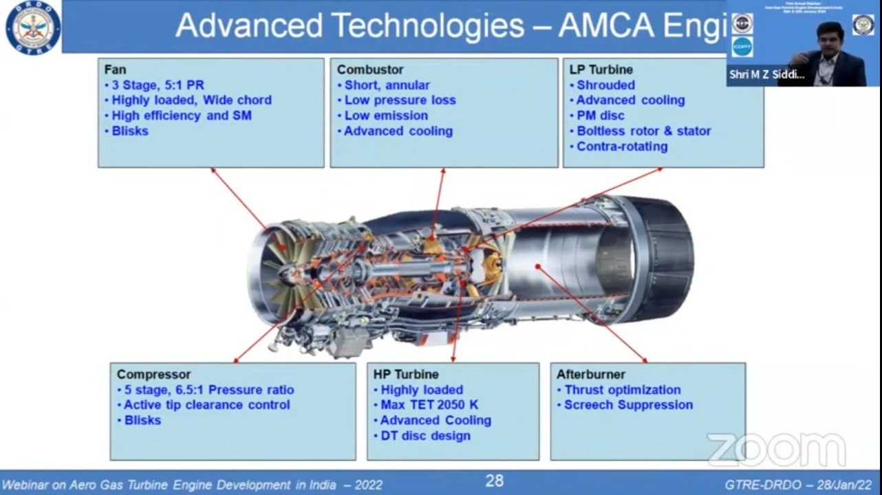

https://x.com/shreedharsingh9/status/18 ... 1130278017
Advanced technology for AMca engine

srai wrote: 19 Mar 2025 03:00 https://x.com/shreedharsingh9/status/18 ... 1130278017
Again, nothing new, this is one of the slides from Webinar on Aero Gas Turbine Engine Development in India - 2022, that was posted by Rakeshji, a few pages back - there are other slides as well, in that post, which provides good details.

Wow!! Courtesy @vatsalyamaurya in X: Detailed information on Izdeliya-30/AL-51, seeing this for the very first time.
Simply dazzling level of 5th Gen (they are claiming 5+ Gen, maybe rightly so) TF technological prowess on display - no wonder Russia is so protective about the IP!!
Hard to swallow that the same OEM also produces ancient-tech-level AL-31FP etc - there's simply no comparison!! Nobody, in their right minds, would share such cutting-edge tech with us or anybody - not sure why we keep begging for it :oops: ... if we get even Lic mfg tech (like for the AL-31FP), we should consider ourselves lucky. :roll:

maitya wrote: 19 Mar 2025 22:50 Wow!! Courtesy @vatsalyamaurya in X: Detailed information on Izdeliya-30/AL-51, seeing this for the very first time.
