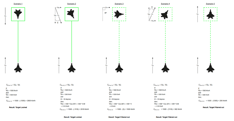

Rakesh, sorry to dig up an old post but I'd missed reading this thread for a long time and only just saw it. Is there any source for the claim that the AMRAAMs were defeated because of jamming? Sameer Joshi's twitter post which you referenced does not mention that.
Reason I ask is because it is entirely possible to defeat BVR missiles without jamming, although having the capability would certainly help. The mere fact that the two MKI's defeated them does not prove it was because of jamming or that they were even carrying the SAP-518's. But I'm curious if there were other posts especially from someone in the know mentioning this.

nachiket wrote: 16 Apr 2025 05:50 Rakesh, sorry to dig up an old post but I'd missed reading this thread for a long time and only just saw it. Is there any source for the claim that the AMRAAMs were defeated because of jamming? Sameer Joshi's twitter post which you referenced does not mention that.
See this post from KaranM... ---> viewtopic.php?p=2337688#p2337688
...and I am highlighting the relevant portion here....
And all AMRAAMs fired at Su-30s miss. Here are the options.
1. Clearly the F-16 radars did not guide the missiles in. So either they were jammed or were avoiding the Su-30s in turn. Conclusion> Su-30s held off a larger force of F-16s in BVR
2. AMRAAM missiles could not get a lock-on to the Su-30s. So either their initial cues were hopelessly wrong, or they were jammed/countermeasured by the Su-30s. Either way, Su-30s defeated AMRAAMs.

Couple of additional points - the Su could have also used the mountains and valleys to hide themselves, break the lock and escape.
At the end of its flight the amraam is coasting and is subsonic if i am not mistaken, so it can be evaded by engaging AB and turning away

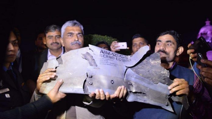

IAF has public ally displayed 1 AMRAAM wreckage in a Media Briefing, the PAKI ISPR was initially claiming no F-16's used on 27 Feb 19 - aircraft were shot down by JF-17 and SD-10, then claimed wreckage was from lot sold to Taiwan, when US Govt documents showed serial no belonged to lot sold to Pakistan- the entire ecosystem went quiet.
After sometime, they awarded F-16 Pilots for shooting down MIG 21 Bison with an AMRAAM and lesser award for XYZ pilot for shooting down a SU-30 MKI.
But for 2 days the entire Paki Ecosystem was certain Su-30 MKI was downed but latter shut up when they realised they had all missed with 1 missile being fired at pretty close range.
Even in the Russia Ukraine after the Ukraine counteroffensive in Sep22, they recovered a SU 30SM with a SAP514 which the Russians had left.
The US Government/Pentagon were very interested and had shifted the POD to the USA as they wanted to know more about how its Jamming worked.
I believe the US wanted to know how the Missile known as Slammer missed with such overwhelming odds the PAF had for 5 mins that day. After the F-16 Shootdown and with More IAF Su-30 MKI, MIg 29's, M-2000, Mig 21 Bison incoming the entire 28 PAF Aircraft lit afterburners and ran to their airbases and the PAKI Army Tank brigade near Sialkot was Running on civilian roads destroying infrastructure.

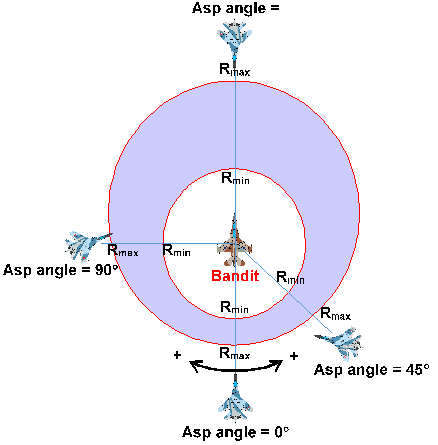

Tutorial on BVR escape maneuver- “notch”

Yes to the bolded part....
India produces proof, rubbishes Pakistan claim that F-16s weren’t used across LoC
https://theprint.in/defence/india-produ ... oc/199723/
29 Feb 2019
Image Caption: Air force spokesperson Group Captain Anupam Banerjee with debris of the AIM-120 missile which was fired by the Pakistani F-16.

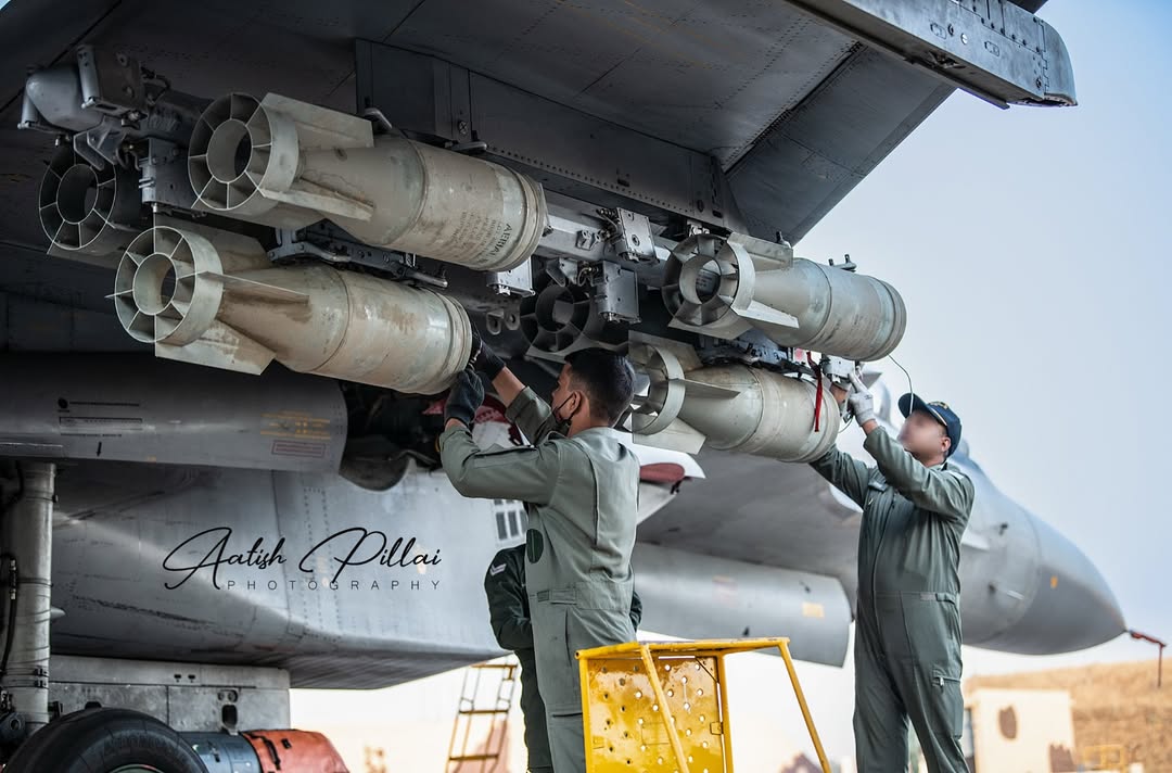

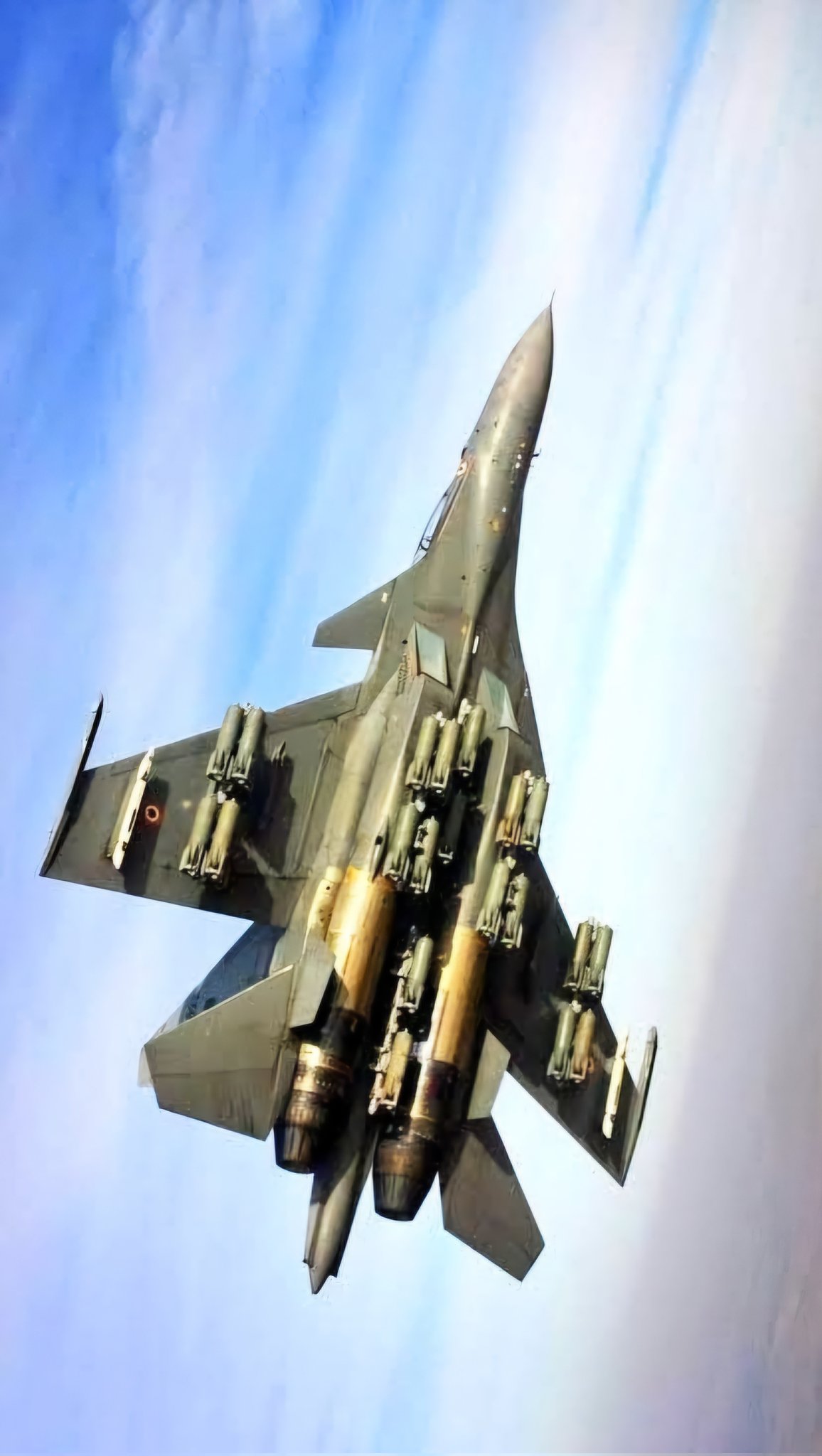

https://x.com/NewsIADN/status/1916832385112436969 ---> IAF Su-30MKI Aka "Mini-Bomber"

For those who wonder about the risky nature of dropping such unguided bombs, refer to Vivek _Ahuja's thrilling military scenario of the Indo-China war in the Possible Military Scenarios thread. IIRC, one scenario is the bombing of a Chinese military convoy, which is passing through roads on the side of hills.
A few Indian bombers suddenly popped out of hills and valleys, passed along the long convoy, dropped all the bombs and disappeared again in the next instance amongst the hills. What happens next is the continuing thunder of bombs exploding all over the convoy. Just imagine the destruction!!
Where is Vivek _Ahuja now?

Rakesh wrote: 29 Apr 2025 20:46 https://x.com/NewsIADN/status/1916832385112436969 ---> IAF Su-30MKI Aka "Mini-Bomber"
For a much better mini bomber version, what if these FABs are replaced by SAAW ?.. How many SAAWs can be carried in total.. ?.
16 easily (4 each on 4 hardpoints), and more. I remember seeing some mockup like this.
