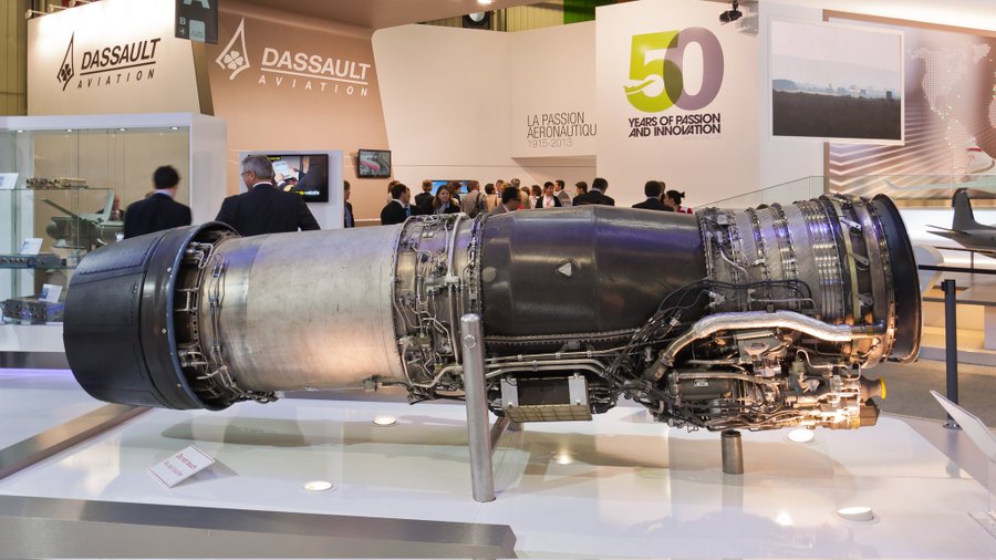

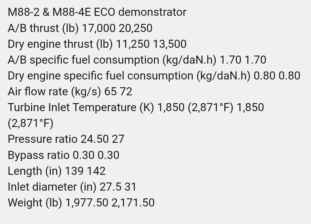

basant wrote: 28 May 2025 11:42 It's 50kN/75kN admiral. Even F404-IN is better.
I am assuming you meant the above for me :) However, that was Ankit who made the post above yours, not me.
I am surprised why this article from Money Control popped up all of a sudden. However, the GE F414 deal has not moved forward in any substantive way since the announcement in 2023 by the Biden Administration. Is this a media planted story to put pressure on GE or is there really something in the works with Safran, is anyone's guess.
But couple of points I would like to make;
1) There are proposed variants of the M88 (i.e. M88-3 and M88-4) that Safran has looked into developing. The issue is that Safran does not want to spend its own money to develop it and they would rather have someone else invest the money.
2) The M88-3 - on paper - is expected to deliver 80 - 93 kN (17,984 lbs to 20,907 lbs). Source: https://web.archive.org/web/20100113171 ... 00942.html
3) The M88-4 - on paper - is expected to deliver 95 - 105 kN (21,356 lbs to 23,604 lbs). Source: Same link as above.
4) The M88-4E (ECO) is the current production variant. It is built upon the M88 TCO program. It delivers 50 kN (11,200 lbf) dry thrust and 75 kN (16,900 lbf) wet thrust. This is the variant that powers the IAF Rafales and the incoming IN Rafales as well. Source: https://www.dassault-aviation.com/en/de ... -airframe/
Now, Safran is one of the three contenders in the JV for a 5th generation engine for the AMCA program. The other two being GE and Rolls Royce. And the underlying factor between all three contestants is the MRFA contract i.e. offsets being the key negotiating tool. GE turbofans power the US contestants (F-15EX, F-21 and F-18SH), Rolls Royce's EJ200 powers the Eurofighter Typhoon and Safran's M88-4E powers the Rafale. And it is an open secret that Air HQ is heavily leaning towards more Rafales.
Now heaven only knows what Safran has proposed to the Indian Govt as part of the AMCA turbofan JV. Could Safran offer to develop the M88-3 and M88-4 as alternatives to the F404 for Mk1A and F414 for Mk2? It is possible, but the question is will the Govt take up the offer? Perhaps they are only offering the M88-4 for the Mk2 and leaving the Mk1A fleet with F404 turbofans. Nobody knows what discussions have taken place with Safran. Only time will tell.

P.S. Also remember, you don't just switch out a turbofan on a whim and a fancy. Swapping out one turbofan for another is a lot of work and is not an easy task. If there is truth to this article, it is likely that Safran has been having backroom discussions with India, all while the latter is negotiating with GE for F414 production. Keep that in mind :)
Posts: 22016
From Saurav Jha. Tweet is dated Dec 30, 2024.
https://x.com/SJha1618/status/1873662546198356248 ---> Collaborative work on the M88-4 'ECO' is definitely a possibility and should be seen as a contingency plan. Of course, it needs to be done in 2025 itself. There is no point in waiting around to see what the Americans do with the F-414 deal. Obviously, contingencies are expensive.
