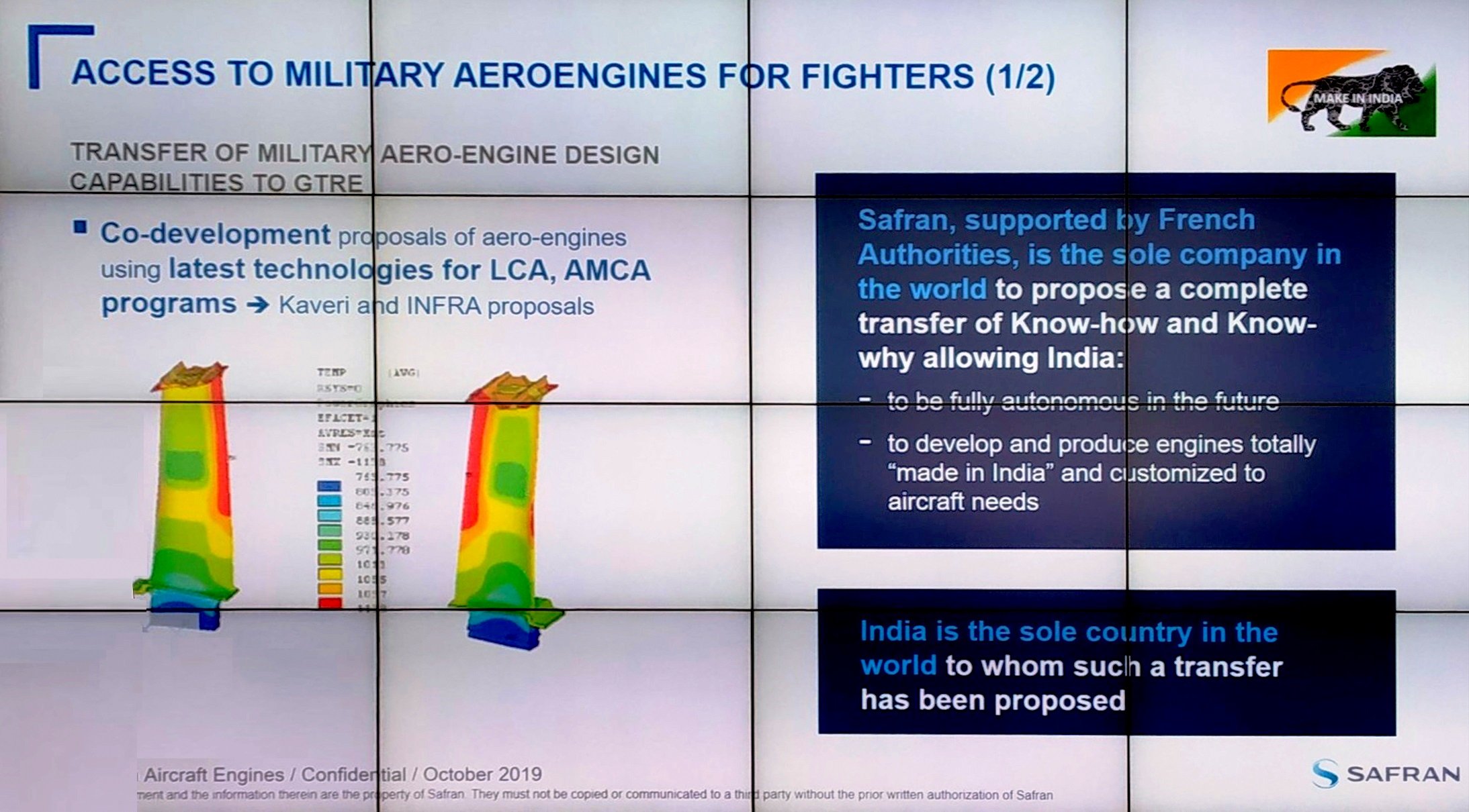

From idrw X post.
Safran's Proposal for AMCA engine.
>Safran India will co develop new engine with GTRE
> No Export Restrictions
> Rafale Will be Testbed for the engine
> Full Production of the engine in the Country.
> Co-testing and Co-Certification of the new engine
> ToT on both Material and Technologies to manufacture them locally (Tools n Machinery)
Many times experts in the forum had said that fighter jet engine ToT is a myth. But Safran is doing that offer again. Read the right side of the above picture.

Hriday wrote: 22 Aug 2025 19:37 From idrw X post.
[img]https://i.ibb.co/4RKnXTH0/20250822-193000.jpg[/[/url
[url=https://imgbb.com/]
Interesting ., if India does not develop the critical metallurgy skills., no "TOT" is going to help..it will be just locked to the manufacturer's ecosystem!! what's the use of spending billions ?!
