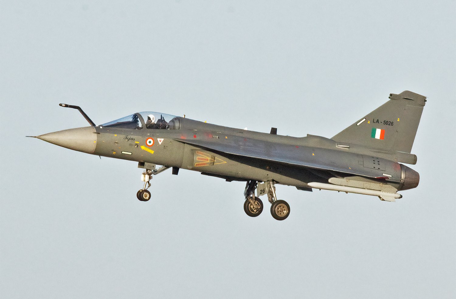

LA-5026 is the aircraft that crashed today in Dubai, UAE. I have updated the first post in page 1 of the Tejas Mk1 thread. The aircraft was from No 18 Flying Bullets Squadron, while Wing Commander Namansh Syal was from No 3 Cobras Squadron. This is the second Tejas loss for No 18 Sqn, as LA-5020 crashed in Jaisalmer, Rajasthan last year. I believe No 3 Sqn is the first unit to be raised with the Mk1A variant. Please correct me if I am wrong.
https://x.com/Griezmenace/status/199190 ... 04702?s=20 ---> Honouring Wing Commander Namansh Syal, LA-5026. Proud air warrior of No. 3 Squadron, the Cobras. Farewell, brave warrior.
