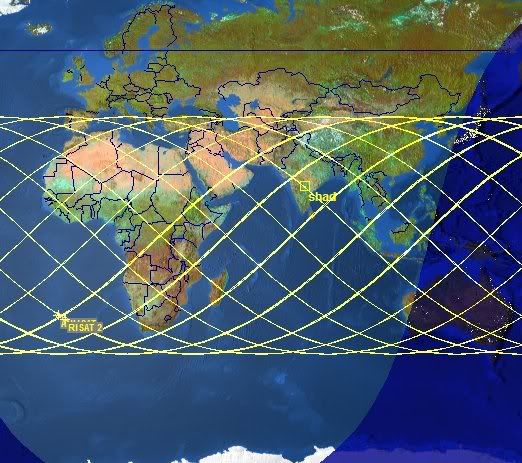

R2 orbit coverage near India:
Now that there is more clarity on the orbital data of RISAT-2 a realistic view has been created.

Question to Gurulog: Per the coverage shown by SSSalvi the northern end just about covers the areas of interest - any reason why we would not have tried to center it more? Is the coverage uniform across the areas mentioned?

Just move the orbital overlays more north as you suggest, and you will get the answer. The number of orbits passing over the regions of interest will decrease for any given day.Najunamar wrote:Question to Gurulog: Per the coverage shown by SSSalvi the northern end just about covers the areas of interest - any reason why we would not have tried to center it more? Is the coverage uniform across the areas mentioned?
Besides, the band covered by this orbital choice is the famous "360 by half degree azimuth of interest" for India.... both weather wise and security wise.

Thanks! That would explain the traverse almost parallel to the border on the eastern side where Lizard needs to be watched plus the crossing on BD turf. Nice to know friendly eyes are up there to help prevent unlawful entry.

It is an orbital data NOT coverage. Lizard's head and tail are both being watched.Najunamar wrote:Question to Gurulog: Per the coverage shown by SSSalvi the northern end just about covers the areas of interest - any reason why we would not have tried to center it more? Is the coverage uniform across the areas mentioned?
Re: Indian Space Program Discussion
The picture shows a few orbits only.Najunamar wrote:Question to Gurulog: Per the coverage shown by SSSalvi the northern end just about covers the areas of interest - any reason why we would not have tried to center it more? Is the coverage uniform across the areas mentioned?
Actually the satellite will cover all the area in-between the paths seen here also.
My feeling is that the 41 deg inclination is not specifically for Indian requirements. It may be so so that the already developed hard/softwares of the original parentage of this satellite can be used without much changes.

But, for a given day only so many orbits will cover the mid region of the orbital band. For targets closer to the edge of this band however, more orbits will overlay for any given day.SSSalvi wrote: The picture shows a few orbits only.
The revisit periods with this orbital choice for Pakistan is shorter when compared to a spot in the middle of the Indian Ocean region.
For truly polar orbits it is easier to visualize ... since the polar regions get covered by every orbit (usually 14 orbits per day) whereas Pindi will get covered by one or two orbits at most per day depending on the swath width. That is the analogy I have in mind.
With the RISAT's orbital choice, Pindi is under constant watch so to speak...on a daily basis and even more frequently.
