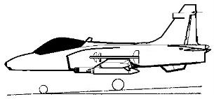

Well assuming 2 Adours, the plane will be larger than a Hawk but smaller than an Su-25 Frogfoot.
While I am no expert - clearly there are certain trade offs. More fuel versus more payload. As long as that trade off is made on the wings - i.e external tanks versus munitions there can be flexibility. Than means internal space in the fuselage can be reserved for a mix of avionics and fuel. The reason I am talking of avionics goes back the Abhibhushan's post which mentions both terrain following and DARIN III. It was the DARIN upgrades that imporved the Jaguar's weapons delivery accuracy. That post also mentions three things:
1) Take off from Leh - (3500 meters altitude) with at least 1500 kg payload
2) Ability to work at Along, Arunachal Pradesh - 300 meters above sea level
3) Gerat performance at 20,000 feet - (because the ground is often at 18.000 feet)
I see a DARIN type avionics suite as important because interdiction may mean cutting off enemy logistics lines at crucial chokepoints. The could mean taking out bridges over rivers in a deep mountain valley. (Will provide an image for illustration later) A single pass dropping one 1000 kg (or twin 500 kg) laser guided bombs on a bridge should be able to take it out. Literally 5 minutes over the target area. In and out.
The wings must be optimised for lift rather than high speed performance. That is the other tradeoff. A low wing loading (I think) should ensure better high altitude performance.

How large is the Adour? Can we move the intakes further back, over the wing? (Actually, I might be barking here - would it actually help protect the engines from dust and stones, etc?) And sorry for asking for constant changes Victor :oops: but should there be a bubble-style bulging canopy, again for better downward visibility? You'd definitely need very thick, strong glass/perspex/whatevertheyuse.
Also, how does one go about adding armour? Would you have to thicken the skin overall, or would you have add-on armour plates at certain points? I don't know much about the Kiran's structure, either: is it possible to have a fairly thick-gauge metal skin on the underbody, wings and engine nacelles, with composites used everywhere else?
Going back to wing design, how do you mate good stability (bomb-dropping, strafing) with excellent roll and yaw rates? Does anhedral even work on low-wing aircraft?

Can someone come up with projected specs and an illustration of a two-engined LCA? I think it could make a very good gen 4+ MMRCA, good enough to take on the current MMRCA contenders.
To keep things simple, you'd use the same wings, same avionics and probably the same GE 414 engines (or two R25s, if we want to be stringent about the made-in-India idea, though it's probably not the best idea for this sort of plane).
You can either go for a narrow-fuselage design like the Rafale/Typhoon, or (my preference), a wide, lifting body like the Russians. Two vertical stabs, maybe canards if needed.
Can someone project weights, payload, range, number of hard points, etc?
The sticking point is probably the radar, but I expect it'll use whatever the LCA finally ends up using.
Also, how long do you estimate it would take to make this?

Forgot a couple of things...
1) two-seater for sure
2) might need to elongate the fuselage a little... otherwise it would be very wide and stubby, which i imagine would affect stability, yes? (pulling this out of ze musharraf, no clue if that actually affects things)

May be we should design an Aircraft with the following specification:
1. Delta Winged some what shaped like the Vulcan,
2. With 4 Kaveri Engine.
3. Air frame and Fuselage made of Titanium and composite.
4. Skin made of Russian RAM.
5. AESA Radar.
6. Capable of carrying 10 Brahmos, 10 Nirbhay and 10 Astra concealed within the fuselage and wings.
7. Huge Internal fuel carrying capacity.
Tactics should be that this Aircraft should not venture any where near 200 km of our friendly International Border. It should only fly from Mumbai to Delhi and Delhi to Kolkata.

nachiket wrote:B_Ambuj, the requirement is of a light, single-seat strike aircraft which can perform well in the mountainous regions and which can be designed and manufactured completely in India with the current level of technical knowhow available in the country. This has been discussed in the thread earlier.
This Requirement some what matches that of the CAT which was planned earlier. BAE Hawk Mk132 probably killed it.
CAT needs to be Resurrected.
